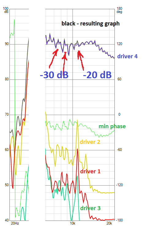

Question about the frequency response graphs. From the resulting graph to the driver graphs at 7-8 kHz -30 dB, at 11 kHz -20 dB. Can a signal that is -20 or -30 dB quieter than the main one affect the main one? I.e. the question is, is the resulting graph calculated correctly in these places?
-20 dB affects -0.92...+0.83 dB depending on phase difference.
-30 dB => -0.28...+0.27 dB.
Summing accuracy is extremely easy to verify e.g. with ideal/default driver data and textbook LP+HP filter, and exporting total SPL. Error is zero in dB with three decimals.
