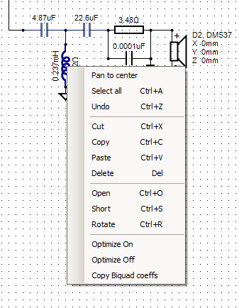

on the optimize bit flipping I'm pretty sure what 3ll3d00d is requesting is already available.
Drag to select (or shift click to select) multiple components. Then right click on one and select optimize on or optimize off from the context menu and the bit is flipped for all selected components. Unless I've misinterpreted what the request is
Tony.
Tony.
re point/click, I was probably just being hamfisted.
re bit flipping, I was selecting multiple components and thinking that the visible checkbox (in the component edit fields below) would apply to all selected components but I think that set of fields follows the highlighted component instead irrespective of how many are selected. At least that is how it seemed to behave (and hopefully that makes sense, probably easier to show a picture but am not in front of that computer). If there is already a context menu option for that then great.

Not a bug. Optimize selection via context menu is meant for main parameters of the components. You can optimize DCR, ESR, driver's rotation and tilt but you have to set Opt bit from parameter grid. This prevents accidental optimizing of secondary parameters.
All parameters of "dsp" active blocks are main parameters, but both OP amp parameters are not.
