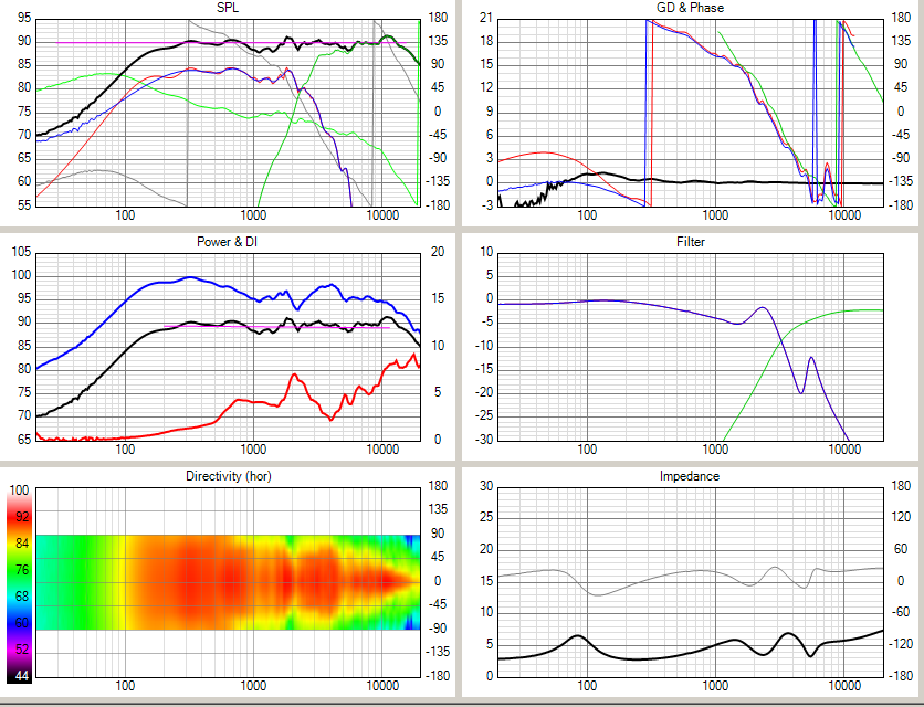

I thought I'd post an update. I decided to export minimum phase for my off axis measurements, and scale the woofer down by 6db and impedance doubled. I then put in the two M's and single tweeter with the correct offsets.
Now my 0 - 90deg measurements model correctly
though my power response and di now look a bit crappy compared to just zero deg modeling, but I guess that is the point of using the extra measurements

Now my 0 - 90deg measurements model correctlythough my power response and di now look a bit crappy compared to just zero deg modeling, but I guess that is the point of using the extra measurements
It's quite educational to notice that design by axial response only is fundamentally very sh*t method which relies on luck or long experience how to avoid e.g. stuffy but harsh sound. One of the main reasons why VituixCAD exists is to offer these shocking experiences![]()
It was quite mindblowing to model few earlier designs with angled measurements in VituixCAD. There are numerous designs from respected designers that have either luck or additional expertise (or actual polar simulations) but looks like they are designed with only axial response, but still show quite good polar response and continuous DI. Then there are those that do not
I have designed ~8 speakers with VituixCAD since 2014 (yes, early adopter) and could not live without it. It packs all mandatory features that commercial equivalents, but more user friendly interface and dashboard that gives you full control of your design at a glance. I haven't tested these new features nor version 2.x but the development looks very promising.
Yes I have been struggling to work out what I should be aiming for. I read a bit on power response and from what I can gather a downward tilt is what is generally preferred, Toole found that sharp dips in the power response didn't seem to affect listener peference, but I'm guessing my first posted graph was definitely not good

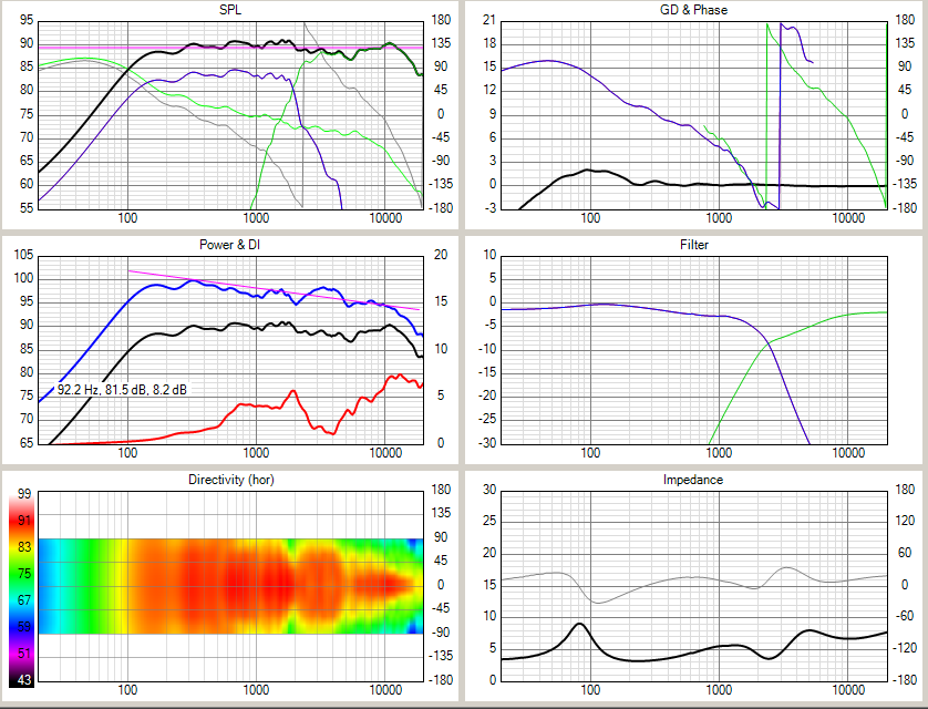

This is what I have come up with at the moment. Not as smooth on axis, but I guess that is the thing with speakers, everything is a compromise. I got something that was looking quite good (optimizing for power response) and then I realised it had effectively made the tweeter acoustic response about 1600Hz crossover, which is lower than I think I can go with these speakers.
Also thinking I probably need to go with full 180 deg of measurements, and proper set of individual measurements for each driver in the MTM, rather than the M's combined on the tweeter axis.

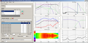

The second attachment is how the current (8 yo) implementation of the crossover models. I probably should export the off axis simulated results and compare to my actual off actual measuements with the crossover in place as a sanity check. I'm not sure that the new one will be an improvement...

Hi Tony,
A couple of things to think about are the room signature and your hearing preferences. If you are measuring speakers that will ultimately be in one room, you would want to take into account the room signature. There may be reinforcement of certain frequencies or more absorption of others. If you are looking at speakers that can be moved from place to place, then targeting "ideal" curves makes more sense. I personally find that I prefer a flat frequency response on axis in a room that is well treated. Of course, I look for a smooth power response and it will shift downward with increasing frequency as beaming occurs at the higher frequencies. Smoother is generally better but as you say, there will always be compromises. There will be an area where you don't see much of this off axis effect at lower frequencies where no significant beaming is occurring. You may be able to smooth off axis effects with baffle treatments and rounded edges, hence, smoothing your power response. This article kind of addresses much of this: https://www.harman.com/sites/default/files/LoudspeakersandRoomsPt2_0.pdf. As you know, you are limited by driver limitations so like you said, you need to be cautious to not design a crossover that the tweeter cannot handle at power levels that it will see, realizing that distortion puts additional strain on the tweeter.
Jay

One more thing, Tony. Though the overall power response is a good measure to look at, also of importance, is that off axis measurements show no significant aberrant deviations from the previous measurement.
Regarding Dr. Toole and his team's work, remember that they primarily look at listener preference and in designing your own speakers, the most important listener is the audience who will be listening to the speaker.
Just my opinion, and it may go against what others think, but personally I would not sacrifice and distort the on axis response to meet a power response target that the drivers are not capable of, especially at higher frequencies above say 1Khz.Yes I have been struggling to work out what I should be aiming for. I read a bit on power response and from what I can gather a downward tilt is what is generally preferred, Toole found that sharp dips in the power response didn't seem to affect listener peference, but I'm guessing my first posted graph was definitely not good![]()
Tools findings are clear - listener axis response is the primary ranking variable in what sounds best, power response and off axis response is a distant secondary factor with much smaller effect, especially at high frequencies.
So it is very debatable whether you will hear a moderate change in the power response towards a more "ideal" power response, but you WILL hear the sacrifice in on axis response made to do that.
By making the on axis response worse to make the power response better, the overall perceived response will almost certainly be worse since you're making a primary variable worse to improve a secondary variable.
The only things you can really do in a crossover to improve the power response without simultaneously sacrificing the on axis response is to shift the crossover frequencies, increase the crossover slopes, and/or change to a different crossover slope with more favourable phase relationships, for example even instead of odd, which can improve the vertical polar response.
In my speakers crossover redesign I moved the crossover frequency down from 4Khz to 3Khz, changed the slopes from 3rd order to 4th order and (with an all-pass filter for physical driver offset) corrected the phase response for accurate on axis phase tracking, and the improvement in off axis response and overall room response was obvious even to the ear when sitting to the sides of the room without even having to do any off axis measurements, (I will do them one day) but at the same time I managed to improve the on axis response considerably as well. End result - they sound MUCH better.
Of course you can only shift crossover frequencies if the drivers allow it - in my case 3Khz is as low as I can go with a ribbon tweeter even with 4th order filter. Below that would be going out of the comfortable range of the tweeter.
However any change to improve the power response that would make the on axis response worse is a sign that the power response change needs to be achieved some other way, by changing crossover frequencies, drivers, baffles overall design etc...
So its great that Vituixcad displays the off axis response and power response, but I wouldn't necessarily use that information to optimise the crossover design beyond crossover frequency and slope selection - at that point its often too late and different design choices or driver selections should have been made earlier in the design. I definitely wouldn't let the optimiser loose making random changes to try to optimise the power response.
