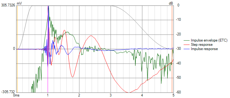

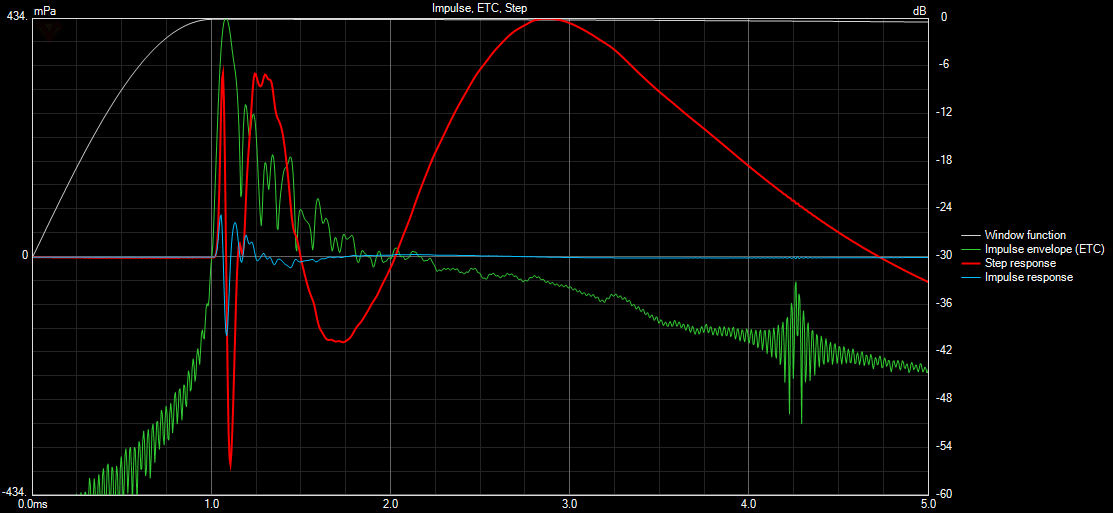

Your sample is actually about twice better than mine having 8th order slopes. This shows that IR+SR+ETC graph alone is difficult to interpret and not adequate though is able to show some features GD can't. Group delay and possible excess group delay (assuming that minimum phase calculation is reliable enough) fills information holes and make graphs comparable.Hard for me to comment as my most favourite DIY speaker doesn't look much better. It is simply the result of multi-way speaker with 4th order LR slopes.
It depends on woofer and mid driver. It's quite popular to use 2nd order acoustic slopes (instead of 4th) for the lowest XO to drop GD to about half. That may be impossible with open baffle with small cone area and low XO without active FIR. Boxed designs are usually possible to make with 1st order electrical HP.What would I sacrifice to improve in this step response aspect? It's all a game of compromises.
You could also read appendix 1 in VCAD manual. Transient perfect design is one option especially with coaxial driver arrangements.
High XO works okay with 4th order acoustical slopes because that does not cause so much GD. High XO also is also easy for FIR.
Are we talking about relative group delay or absolute group delay?
Relative group delay can also be seen in the phase response as well as how the frequency response connects.
Or just plotting the GD graph itself obviously.
Often these graphs give a better insight than looking at the impulse/step responses. The exception is looking at and comparing the start of the impulse itself.
In (mechanical and room) acoustics the impulse is sometimes used a bit more often to estimate durations etc.
In the end it doesn't have to be textbook perfect as long as the total performance doesn't suffer from it.
It's all about orders of magnitude and significance (something a lot of people don't seem to think about or even know the existence of)
