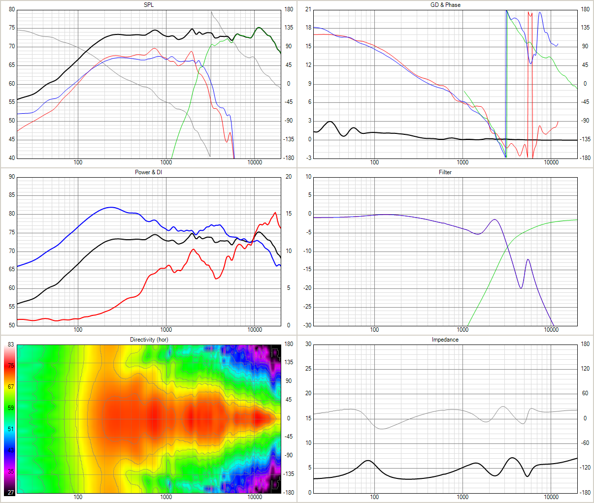

I did a new round of measurements on Sat. 0 through 180 deg in 10deg increments for each of the three speakers in my MTM. I used REW in dual channel mode. The results are much better!
The only problem was I changed my measurement setup a bit and got a dip in the tweeter repsonse around 9Khz that wasn't there before, but I'll just ignore that.
The power response and polar map look so much better than the last lot of non equally spaced measurements I did that only went to 90deg. I should have good data now for doing the crossover redesign.
Attached is the sim of the current crossover with the new measurements.
Tony.
