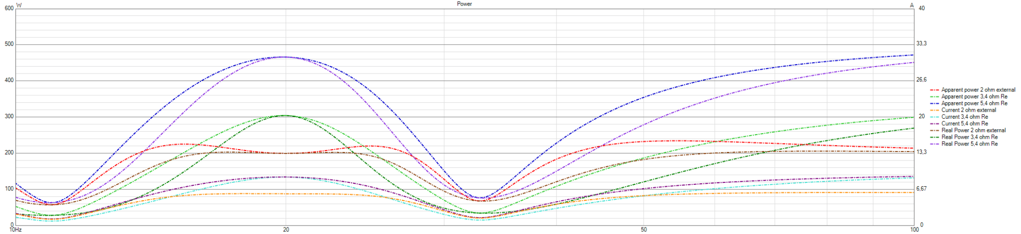

I have not really gotten around to ask you if you want this type of feedback @kimmosto , but I did discover, I think, something that might be a bug.
I was a bit surprised by the results I got when adding some resistance in series with the driver. So i decided to test this comparing a driver with no resistor, a driver with a 2 ohm resistor, and a driver with no resistor, but 3,4 ohm added Re. The Bl factor was kept constant to make sure this affects Qes/Qts, and not Bl (which is default when using crosscalc). I overlayed the response curves to make sure I got the exact same results from the 5,4 ohm driver as I got with the 3,4 + 2 ohm driver.
This is what I got (I focus on 20Hz where SPL is matched):
What I expected to see was that the current is the same for 5,4 and 3,4 + 2 ohm, but I expected to see different values of power as I believe this is the actual power in the coil, meaning the extra 2 ohms are included in one, but not in the other. I added a set with 3,4 ohm Re and no series resistor for reference. Common physics tells us that the reactive nature of the box means the power in the driver with 3,4 ohm + 0, and the power in the driver with 3,4 ohm + 2, should be very much the same as the loss is mainly in the 3,4 ohm Re part of the driver. At the same time, we do not see a huge difference in aparent power so we are not talking about significant reactive forces here.
Yes, all are matched to the exact same SPL at 20Hz.
Am I missing something, or might there be a🪲here?

Obvious bug. Wrong impedance variable in VA, P and I calculation. They all look the same...
I just hope that this is the last one due to integrated filter feature (which has been as pita as separate with main program). I'd like to remove whole feature as unnecessary, but somehow other users seem to need it. I do not.

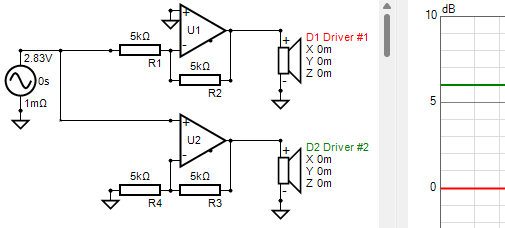

Active high pass and possible L-T or PEQ may be needed needed with any active system. Especially with small systems where (excursion) capacity is very limited (though protective high pass sounds worse). Those have been available for years - first with main program and now with few active stages integrated to Enclosure tool.
Passive C was added to enable faster simulation of possible series capacitor after link to main program was cut. Series L was added at the same time. Rs has been there since the beginning (9.5 years). Passive components are not necessary because main program is still available for it.
