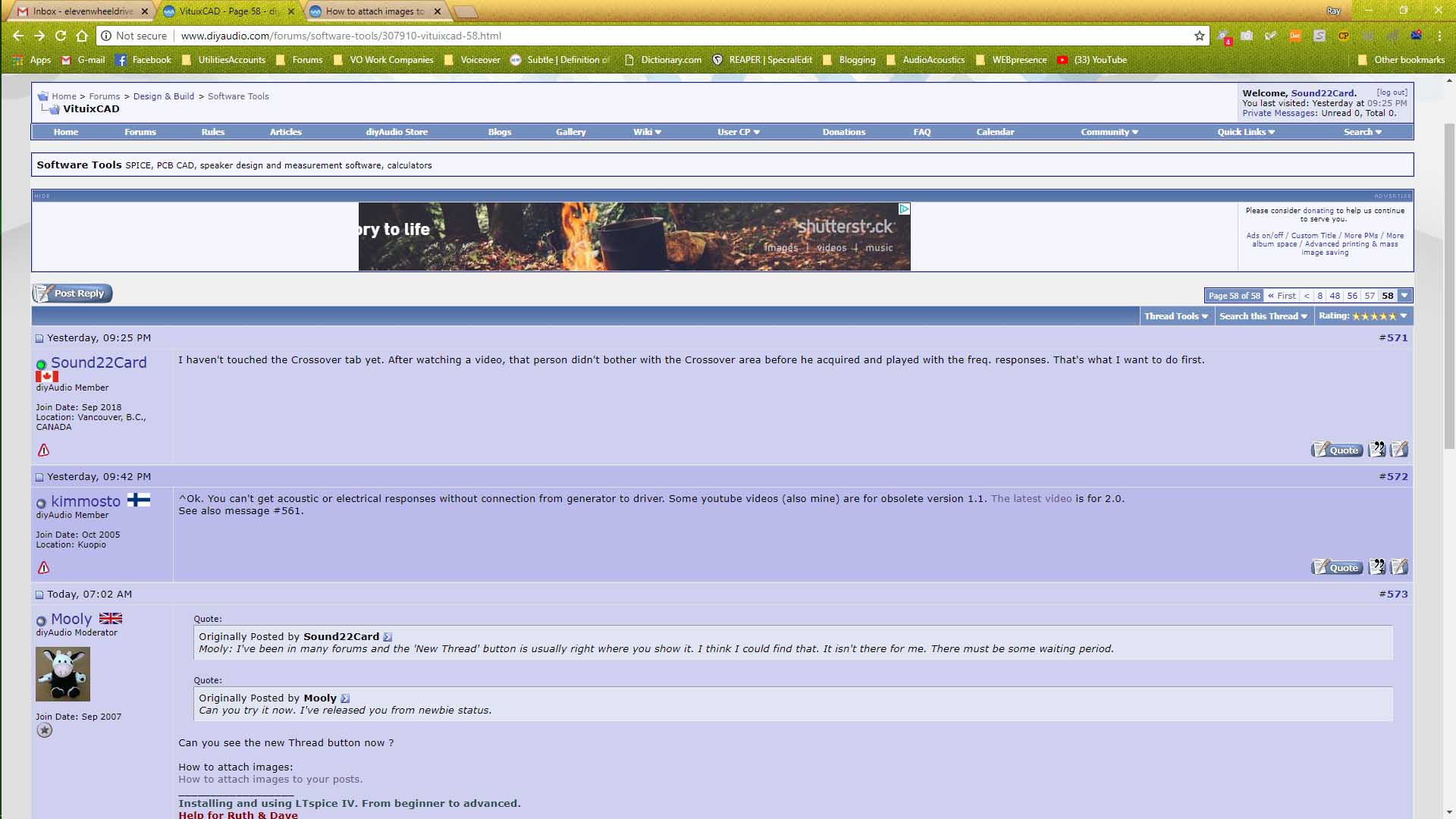

^^What do you have in crossover? If you have a wire or some low Z component from generator to driver, you better send frd and zma files to me by e-mail. Address is in the end of DIY Loudspeakers Kimmo Saunisto
^Ok. You can't get acoustic or electrical responses without connection from generator to driver. Some youtube videos (also mine) are for obsolete version 1.1. The latest video is for 2.0.

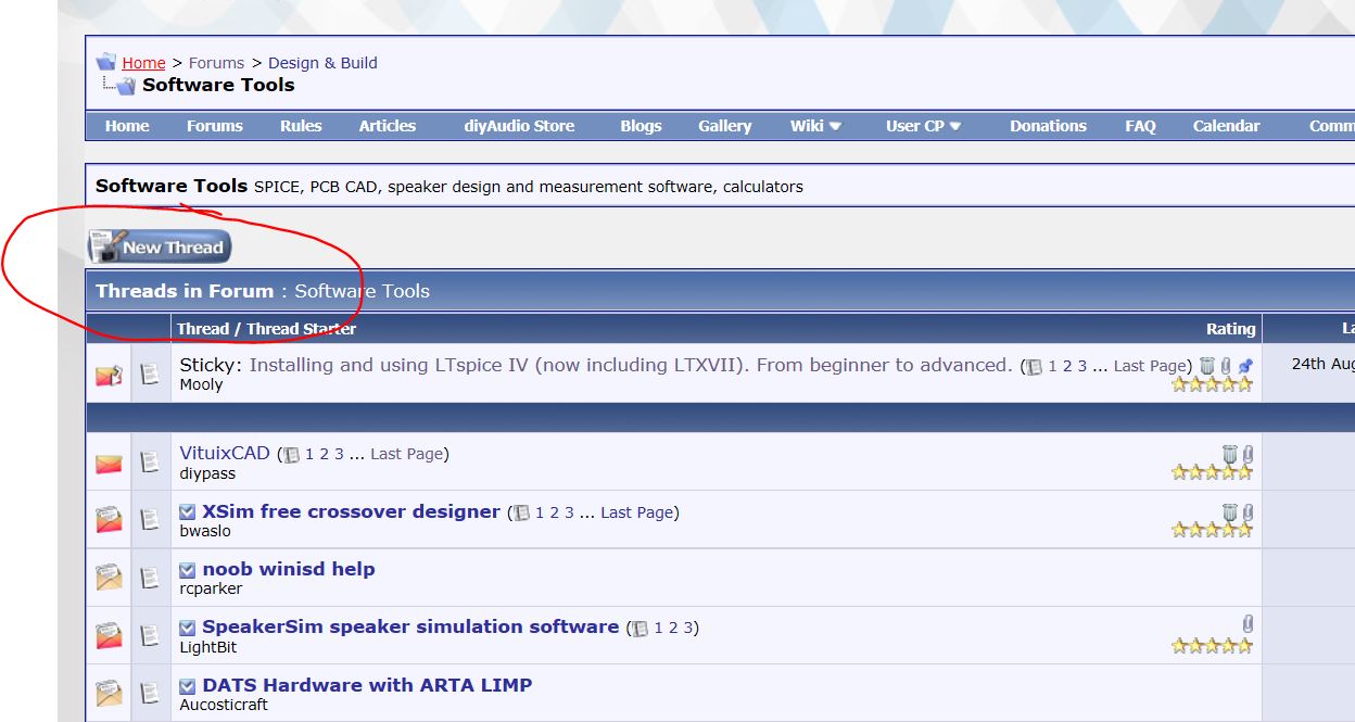

Mooly: I've been in many forums and the 'New Thread' button is usually right where you show it. I think I could find that. It isn't there for me. There must be some waiting period.
Can you try it now. I've released you from newbie status.
Can you see the new Thread button now ?
