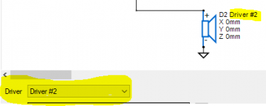

New Vituixcad user here,
How does one enable driver #2 in version 2? This is my first attempt at using the program. I can get driver 1 to display FR info but can't seem to get anything from driver 2. Attached is screenshots. I'm sure its a newbie oversight.
Thanks in advance,
Rich
Thanks in advance,
Rich
