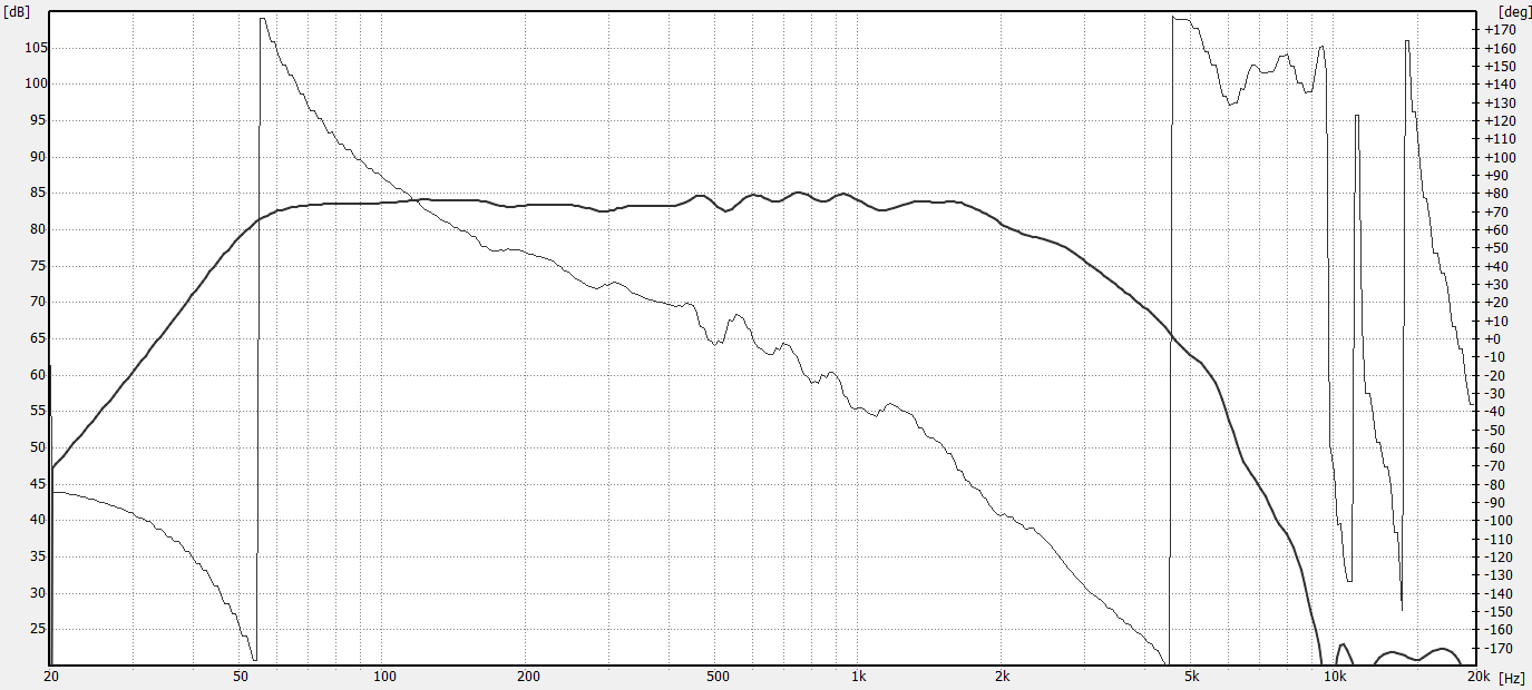

Would it is also be possible to add custom ranged for SPL?
The reason why I'm asking is because it's pretty nice to compare some results with what other people have been doing or what manufactures have in their datasheets.
A couple of very common SPL ranges are 45dB, 50dB and 90dB.
Personally I really miss that last one, since it give a much better overall picture compared to the 60dB.
I just only don't understand why I can select custom frequency ranges, but all the other ones are locked to a bunch of presets?
Why not just make all of them with a range that people can just fill in?

Of course but problem (at least for me) is major grid interval of secondary (phase) axis. That should be compatible with primary axis so that grid line is visible also for 0 deg. Therefore for example 45 and 90 dB spans are not available. 50 dB has other problem too; 360 deg / 5 = 72 which is quite ugly for axis interval. In addition, playing with spans is mostly waste of time. Programs with freely adjustable min and max so that auto scaling is also required or happens without controlled user action are just pain in the a... That will not happen in VituixCAD. Custom Y1 axis stays available in Calculator tool which good playground to test how annoying and time consuming that feature could be.

Normally people fix this by actually plotting different scales in one graph.Of course but problem (at least for me) is major grid interval of secondary (phase) axis. That should be compatible with primary axis so that grid line is visible also for 0 deg. Therefore for example 45 and 90 dB spans are not available. 50 dB has other problem too; 360 deg / 5 = 72 which is quite ugly for axis interval. In addition, playing with spans is mostly waste of time. Programs with freely adjustable min and max so that auto scaling is also required or happens without controlled user action are just pain in the a... That will not happen in VituixCAD. Custom Y1 axis stays available in Calculator tool which good playground to test how annoying and time consuming that feature could be.
(that is having two graphs in one object basically)
In the good old SpeakerWorkshop you could just simply adjust the scales for the SPL as phase as well as the intervals.
That way you could always get nice results.
Also Basta! had no issues with this and people could even change the scale on the fly.
Here is another example from a program called FINE Xover by Loudsoft, where the phase graph is even just fixed
I can get always nice results and able to focus to essential. Not just tinkering with scales.
For that task suggest export curves to REW and use its "All SPL" tab to get them overlaid for a neat comparison plot and then use "Limits" to set whatever SPL ranges.
Yeah, that works with magnitude curves only, but don't try phase span of +180...-180 deg in SPL & Phase tab with 45, 50 or 90 dB SPL span
Anyway, secondary axis is possible to get work with almost any primary span and intervals, but it may require asymmetry, cropping or extending of secondary axis. Users who prefer perfect compatibility of spans and intervals of primary and secondary should be quite happy with existing VituixCAD. The rest can export data and use whatever business graphics software they like.
I don't follow the logic in this?Yeah, that works with magnitude curves only, but don't try phase span of +180...-180 deg in SPL & Phase tab with 45, 50 or 90 dB SPL span
You can still keep the default as is, so people don't have all these artifacts (which I still don't understand since all these other programs can do it just fine, like I showed in the screenshot).
If people decide to change that default anyway, they can decide to take those artifacts for granted.
It just makes VituixCAD a lot more compatible.
I can get nice results on a piece of paper and get the essentials if I have to, but it just makes life a little more convenient.
I see your point from the code perspective. Dual y-axes can be a major PITA! However, I'd suggest to not constrain the code just "by the looks" of how the grid lines match up. Let users do it how they want it
A simple solution would be to use grid lines for SPL only (left y axis), but not for phase (right y axis). Then let users figure out the scaling as they like it. If they want grids of SPL and phase match up, let the users figure it out themselves. The next level would be to let the user specify the division between SPL grid lines.
