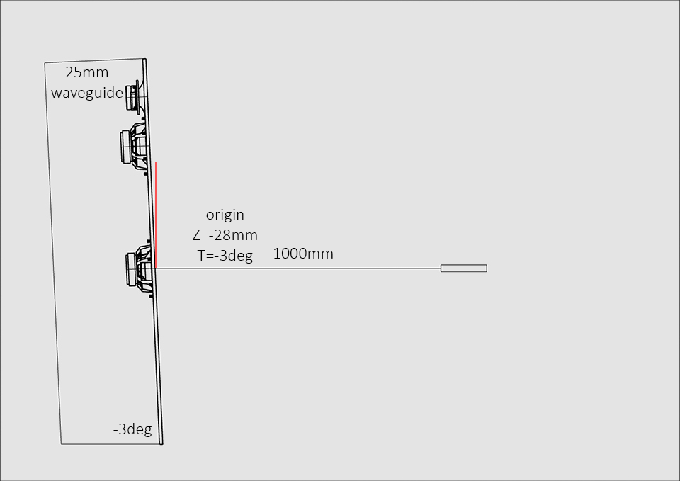

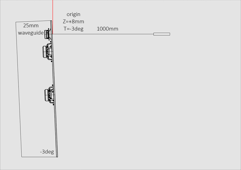

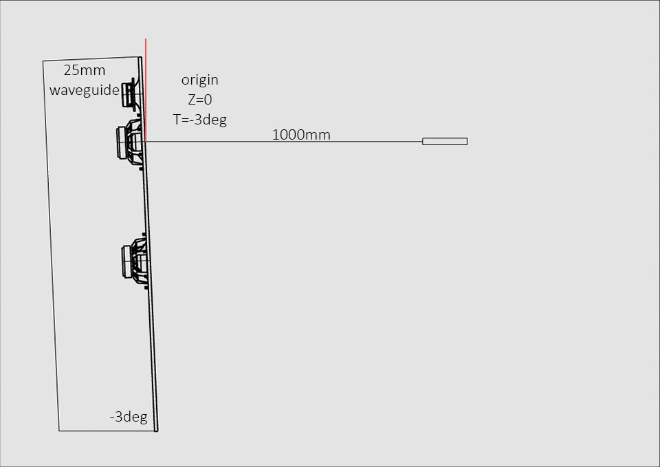

I am preparing measurements and was searching thread in order to fully understand manual and measurements preparations as far as measuring drivers mounted on tilted baffle with tweeter in a waveguide and enetering right data to the program are concerned.
I have come across your talk with InOtIn and one thing got me confused in your explanation of applying Z values to the program concerning example speaker. Shouldn't the Z value of the tweeter be little positive (not negative) if 12M is the origin?
In order to make matters clear I prepared three pictures that explain what I understood so far. Please correct me if I am wrong.
Red vertical line represens rotation axis.
I enter xyz to the program as location of the driver.
I enter waveguide depth as delay of the driver in us.
Is that correct?
Thank you.
Bartosz
Simulator does not think - it just calculates by measurement data you load and parameters you enter 😀 Each driver instance in crossover schematic has X[mm], Y[mm], Z[mm], R[deg] and T[deg] parameters you need to enter to match simulation with reality. As already mentioned XYZ is location of rotation center point of each driver compared origin on baffle surface common for all drivers.
In that particular case all drivers have common X=0mm and R=0deg but close to everything else is individual per driver.
Tweeter: Z and T are small negative values.
Small mid 12M: Could be origin (=endpoint of design axis) so Z=0mm and T=0deg.
Big mid 18W: Z is small negative and T is small positive.
Woofers have common negative Z (bigger than previous Zs) and T=0deg.
Y of each driver is relative to small mid which was selected as origin.
This is not very simple but enables mechanical adjustments with X,Y,Z,R,T parameters with simulator as well as combining whole construction from different prototypes for each driver (accepting some error in inter-diffraction/scattering/reflection).

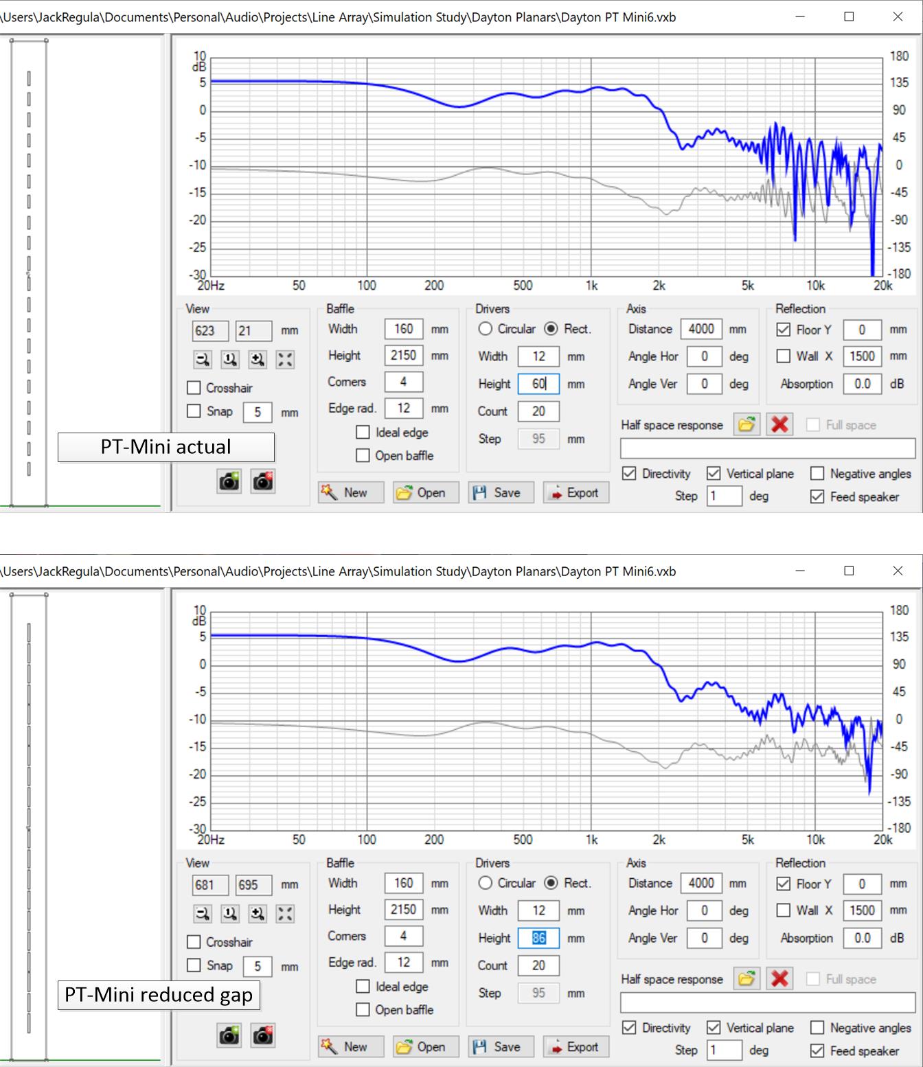

Hi Kimmo:
Someone on another forum posed the question as to whether the Dayton PT-mini planar tweeter would work well in a line array. I then did a 5 minute simulation with your diffraction tool and the results were somewhat negative. This wasn't terribly surprising as the gap between radiators in the array is approximately 38% of the pitch, nowhere near the 10% rule of thumb developed mathematically. As I modify the sim model to display results for an ever taller driver at the same step, the results improve until at/around 10% things start looking really good. By "good" I mean I don't see combing effects or similar anomalies until above 16 khz.
attachment.php
The question came up as to what extent these results could be trusted. I have confidence in Vituix based on my experience with a circular piston line array. But does that apply to a high aspect ratio rectangular device? In the one case you have a continuous line source approximated by closely spaced discrete drivers; in the other case you have a continuous line source with gaps, which get different mathematical treatments. But given the results of my progression of simulations, I think these specific results might indeed be valid.
My experience with it tells me to trust Vituix. But is that trust merited for the special case of a high aspect ratio driver in a line array? (Who better to ask than you?) Do you use a different computation methodology for rectangular vs circular drivers?

...measuring drivers mounted on tilted baffle...
This is mentioned in 'Measurement preparations' document, but unfortunately very shortly: "Turn speaker back/front if front baffle is tilted."
Each driver is measured at 1000 mm from center point of driver on baffle surface. Measurement axis (mic - driver) is perpendicular to baffle surface for that particular driver. This rule is valid while you're capturing response data.
Location, rotation and tilt parameters (X,Y,Z,R,T) of each driver instance in crossover are set so that simulation matches with reality. In your case all drivers have T=+3 deg (nose up = positive). If you have selected mid as speaker's origin (XYZ=0,0,0mm ~ ear is at mid's elevation while listening), tweeter's Z=+8mm, mid's Z=0mm and woofer's Z=-28mm per your images.
I enter waveguide depth as delay of the driver in us. Is that correct?
NO, if you are using dual channel measurement connection and mode and frequency responses are exported with Reference time common for all far field measurements - how advised in 'Measurement preparations' document. Delay correction for all drivers is 0 us in that case because difference in acoustic centers compared to driver's origin (=rotation center) is included in measured phase response, and valid to all measured off-axis directions.
But if you are using USB mic or otherwise measure in single channel mode and phase responses are derived with minimum phase calculation, you have to solve difference in acoustic centers (perpendicular with front baffle) and enter as Delay [us] (not to Z mm which would cause timing error to off-axis with unidirectional drivers). But that is not recommended method due to several possible error sources.
We can be confident that there's always error in simulations 😀
Off-axis responses of individual circular pistons and rectangular planars are calculated to infinite distance. Not to axial distance adjusted by user. Error probably increases with large/high radiators because axis distance to surface size ratio decreases. User manual recommends to simulate long planars with multiple smaller planars with zero gap (end of page 44), but that's not binding. User to test and make final decision.
Off-axis response of circular piston is calculated with BesselJ1, and rectangular planar with sinc function. Difference is easy to visualize with Calculator tool, for example width=100mm vs. diameter=120mm.

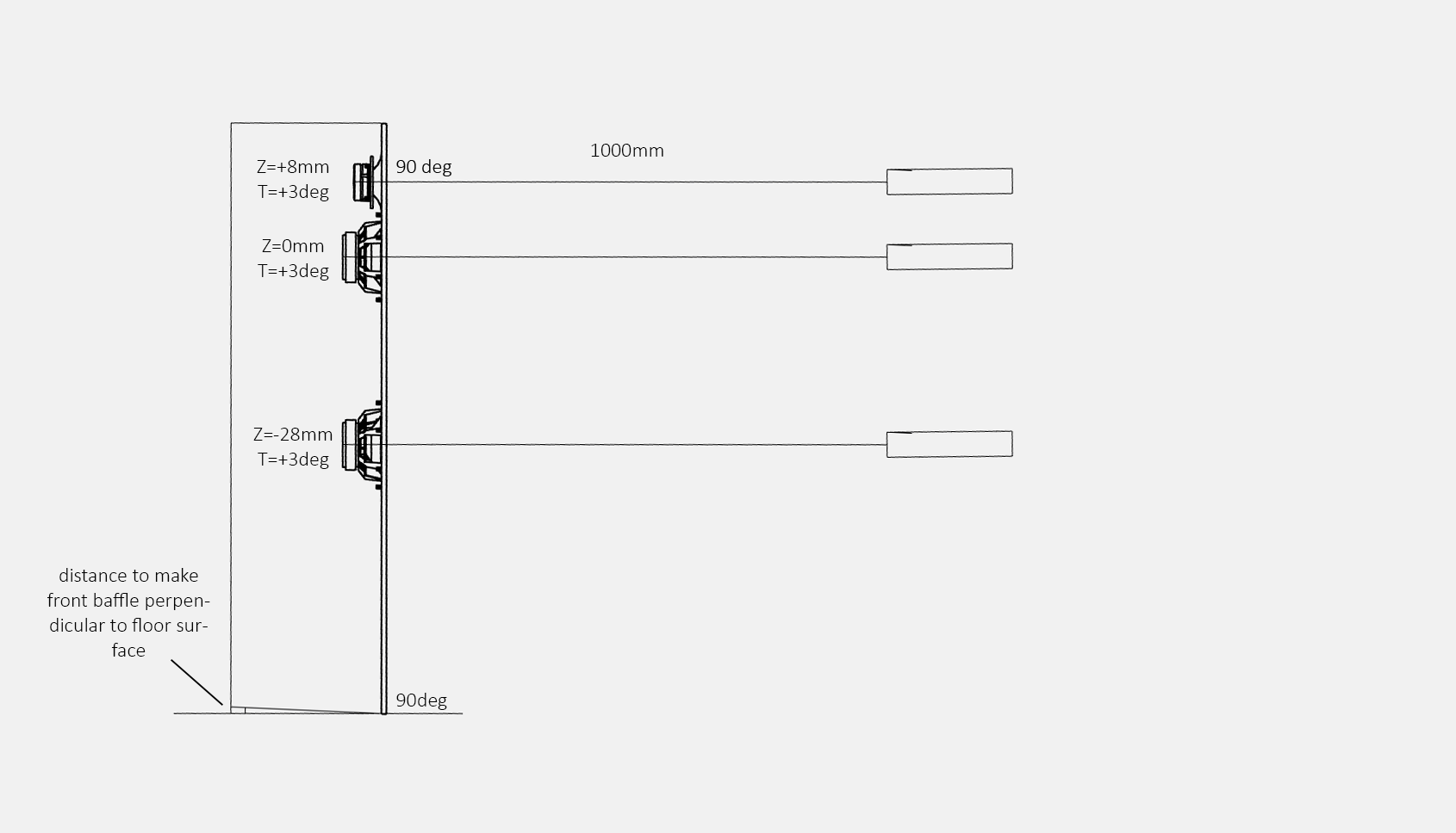

In order to take measurements of a tiled loudspeaker. The speaker needs to be tilted so that it's baffle is perpendicular to floor surface (or you can play with mic).
Is that correct?
^That's correct.
Some compromise workaround is needed if speaker is too heavy or complex for tilting. Few degrees tilt while measurement is not so critical with ordinary dome/cone drivers. More important is that rotation center stays at the center point of driver on baffle surface. That enables setting of actual driver locations into simulator and reduces data overflow from time window while converting IR to FR with constant Reference time.
For example measuring of small 2-way with small circular drivers is okay at common elevation; average Y of W and T. That produces about 4 deg tilt error to both drivers at 1 meter, but makes things a bit easier because no need to move the mic.
Ok, thank you. I get it. This approach indeed makes sense, program has freaquency response of each driver in a box 0 degrees. In comparison to talking measurements with only one position of mic at 1 meter program has more data. Making baffle perpendicular to floor surface makes it easier to maintain the rotation center.
