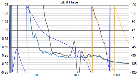

Smallest span will be 8 ms which gives about 0.02 ms resolution (with 900px display height) when GD chart is zoomed. It's about one sample at 1/48000.
I am looking at a thick blue line overlaid on top of a thin blue line on a white background...
I can select some other colors to thin lines, though this has not been a problem with white background. Difference is irrelevant if separate lines cannot be detected.

Perfect! The 2ms span is ideal for looking at excess group delay. (See attached pic)Few comments.

I notice there is some minor inaccuracy in the excess group delay line that is not present in ARTA (excess group delay is partially following some of the lumps and bumps of the group delay curve when it should be a smooth curve, see attached image) but I assume this is due to insufficient resolution in the FRD data, whereas when ARTA generates excess group delay curves it has access to the original measurement impulse file, so it can do so very accurately giving an excess group delay curve that is smooth and free from bleed through of the group delay.
An example of what I would use zoomed in excess group delay for in the attached picture is evaluating how high in frequency the delay provided by the all pass filters on the tweeter extend, as an all pass filter only approximates a constant delay over a certain number of octaves.
So it's useful to compare the response with no all pass filters but with a pure time delay added to the driver in the drivers tab to bring it into actual time alignment (showing only excess group delay which the crossover is responsible for) versus the driver misaligned by mounting on a baffle with an all pass filter to compensate through the crossover overlap region.
Thanks.Setting of SPL and Power target lines is now free but requires pressing of Ctrl or Shift key while dragging the ends (to separate from double-click for zooming). Beginner will not probably find this feature without reading manual. I will forward all e-nagging and questions to DBMandrake![]()
I think it is better now that it needs a key held to move it because I was accidentally moving it when double clicking to zoom before.
I have allowed 1/96 oct. shift between minimum phase response and group delay calculation, but naturally that can't be the source of the ripple. Result is perfect with transfer functions generated in VituixCAD, and very smooth when measured response is imported from CLIO.
