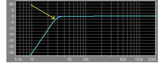

Hi gabor!
Vb is the volume of the box, so you can write 50 (liters). Fb is the tuning frequency of the port (and box). Antal means number of drivers so the default value is one.
You can calculate the lenght of the port for a given diameter. Usually it is good to have a rather large diameter otherwise the speed of air in the port can cause noise (because too high velocity of the air passing through it) and nonlinearity. But a lager diameter of the tube can make it excessively long so a compromise has to be done
According to the Loudspeaker design cookbook an 8 inch driver needs at least a 3" tube diameter if I recall it right and as a thumb-rule.

Hello
I attache a picture, in these case what would be the tuning frequency?
I want to learn to calculate the reflex tube correct size.

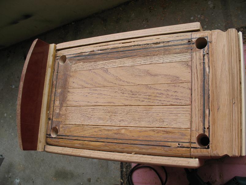

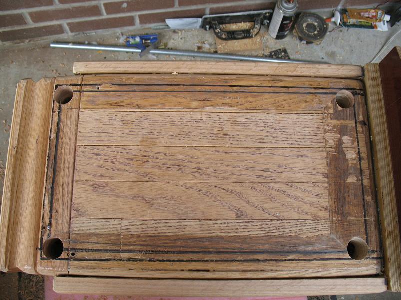

I'm working on my woofer enclosure. It will be min 75L or a bit more. I spent today 200 bucks on Russian birch plywood
I will use 10" woofer.
I like these Scan speak Discovery 26W/8534G 10" woofer. Do someone has experience with these driver?
Scanspeak Discovery 26W/8534G 10" Aluminum Cone Woofer 8 ohm: Madisound Speaker Store
I read my speakers building book I can get even 45% larger enclosure if I fill it up all the way.
That is a bit to much but from 85L these woofer look nice.
