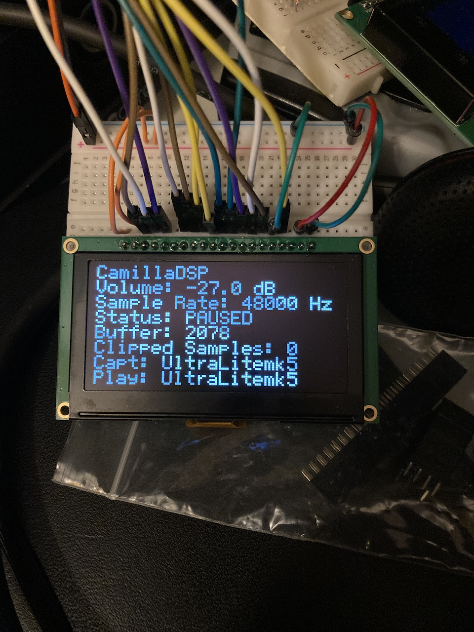

I also like the CamillaDSP option, I haven't built anything with a knob but I do have working remote control via a FLIRC USB IR receiver and have also programmed a small OLED display to work with CamillaDSP. You can change the volume via the CamillaDSP GUI on your phone or use the remote and both update the display. Would be more than happy to share my code if you are interested.

Yes please share it. On what hardware does it run?
