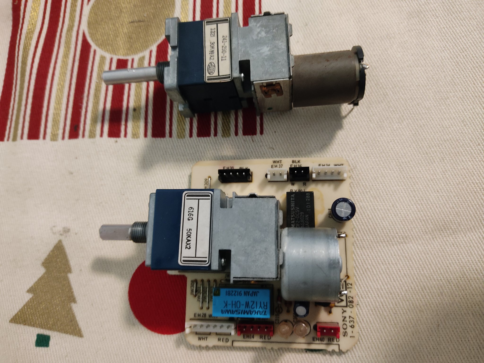

Hello,
I wanted to left here a bit of time to thank to the People who contributed on knowledge here discussed,
and also share some personal experience I've been working with amps in which use RK27, this was the last
one I replaced this one got a problem on the shaft which turned 360 degrees instead of 300 but I have
replaced more than one in which the tip of the wipers gets black, a mix of dust with internal grease and
in that case noise was present due to bad contatcs mainly my quest was for try to find a sealed option to
prevent this because RK27 is an open unit.
Regards
