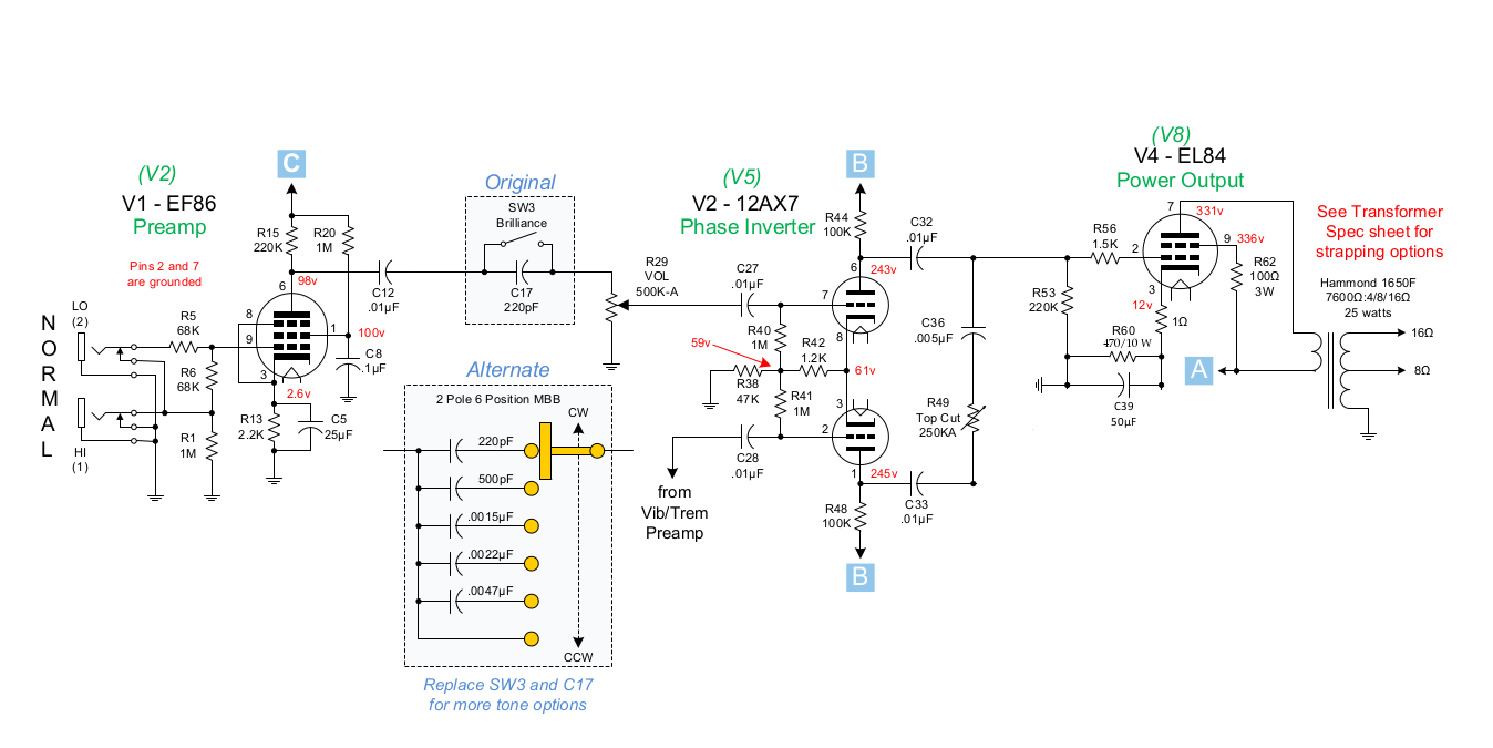

No tremolo or oscillator, just the normal preamp.
Here is the Sluckey schematic modified as little as possible, but still converted to single-ended.
One output pentode is removed, the OT is now a single-ended type (same impedance as a Champ), and the cathode bias resistor for the single 6V6 has been changed to 470 ohms, as in a Fender Champ.
The schematic still shows an EL84, because I didn't want to edit all the pin numbers. But the 470 ohm cathode resistor is, I believe, correct for a Champ, with more or less your B+ voltage.

Maybe a 470R for R62? Would be real cool to take the signal off the volume control and send it to a reverb then brought back in the other triode.
I was thinking that too, 100 ohms seems too small to protect the screen grid from melting during overdrive.Maybe a 470R for R62?
I also forgot to mention that the point labelled "from Vib/Trem preamp" should be grounded. This is necessary for the phase splitter to work properly when the second channel preamp is removed.
Finally, while Fender shows 470 ohms for R60, that is really hard on the poor 6V6, overheating it well beyond its maximum rating. Depending on the actual B+ you use, you may have to increase R60 to keep the 6V6 power dissipation within ratings.
The Sluckey drawing shows 336V on the anode, and that means anode current should be kept to no more than 35 mA for 12 watts anode dissipation in the 6V6. R60 should be increased if necessary to achieve this.
-Gnobuddy

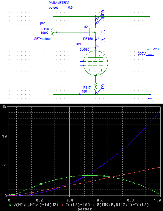

> the MOSFET VVR has to dissipate more power than the speaker attenuator does
The MOSFET dissipation is milder than you might expect. If the amplifier is modeled as a resistor, then half-voltage is half-current. At this point both tube and resistor dissipate 1/4 of what the tube alone dissipated at 100%. For a 14W plate dissipation, 50% gives 3.5W in tube and 3.5W in MOSFET.
In an actual tube, Voltage varies directly but current falls-off as Child's Law, a little faster than voltage. Then worst-case for MOSFET happens near 53%, and for 14.3W tube at 100% the worst-case for the MOSFET is 3.4W. So assuming the tube "is a resistor" is very close and conservative. Max MOSTFET dissipation is 1/4 of 100% tube dissipation.
Contrast to speaker attenuator. The 14W tube(s) will make 5.6W SE or could be 8W push-pull. Assuming we attenuate to bedroom level, <1W, the speaker attenuator must have a peak dissipation of 5W-8W. But only when playing LOUD. Unless you head-bang (quietly) ALL night, the average pad dissipation will be far less. The tube dissipation is high all the time.
The MOSFET reducer basically cooks steady. However at bedroom level (20%-40%): 20%: 2W MOSFET 0.4W tube; 40%: 3W MOSFET 2W tube.
It is kinda a wash, except the MOSFET dropper is less total electric bill and heat in the room. If we only had a 1,000 Watt bedroom amp(!!) then the dissipation differences would be important. But we can build a Champ or DeLuxe nearer a dozen watts, with another dozen Watts in heaters and losses, and not much care about the penny/hour electric cost or the tenth-degree rise of room temp.
In dummy-sim: Generic tube (could be 6V6 etc), self-biased, all non-DC parts ignored. V(M).. is voltage across the MOSFET, V(TU)... is voltage across the tube+bias, I(M) is current which is the same in MOSFET and tube (no gate current). The multiplications compute the power in each part. Tube heat falls-off, MOSFET heat peaks near 50% on pot, at about 1/4 of tube max heat.
The red line is current. If a tube were a perfect resistor this would be straight. Child's Law (a fair approximation on real tubes) says it curves. Indeed, from 48mA@100% we go to 22mA@50%, where a resistor would be 24mA. Close enough for rock.
There is an added glitch because the MOSFET needs 4V to turn on at all, and the tube is slow to rise from zero, so the <5% zone is "dead". In experiment, anything under 10% starts to sound "broken" because the current has fallen-off faster than the voltage which screws bias and loading. In practice we put a stopper under the bottom of the pot to give some low-point like 15% or 8% depending on designer taste.

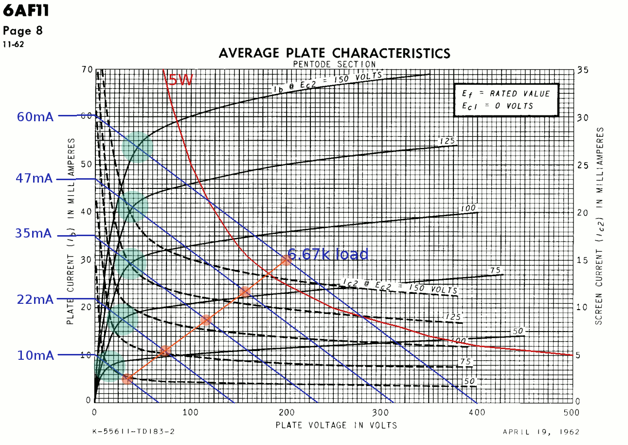

I found that the manufacturer of the 6AF11 Compactron thoughtfully provided pentode curves at a number of different screen voltages. So I spent a little time tinkering with load-lines.
The goal was to learn more about the relationship between screen voltage (Vg2) and anode voltage (Va) for optimum power scaling. The load-lines assume an output transformer, so that anode voltage can rise above B+ voltage during some portion of the audio signal.
I've made some simplifying assumptions in order to be able to work with the limited data we have available to us.
"Optimum power scaling" in this case was assumed to mean that (a) the load line always passed through the knee of the pentode curves, and (b) the operating point always stayed at the centre of the load-line, for pure class A operation.
For class AB push-pull output stages I think it would be reasonable to assume that the operating point should always be located at a fixed percentage of the way up the load-line (less than 50%) from the lower right-hand corner. That would preserve roughly the same degree of "AB-ness", i.e. how warm the bias is compared to pure class B, with zero quiescent current. I don't think this will change the broad conclusions drawn from the pure class A example.
Okay. Item one: the attached set of pentode curves for the 6AF11, taken at screen voltages from 50 V to 150 V in 25V steps.
6.6k looked like a reasonable load. I used 6.67k rather than 6.6k simply because it makes it easier to plot the load lines. The difference is utterly insignificant when it comes to an actual transformer.
I've plotted one 6.67k load-line slap-bang through the centre of the knee of each of the pentode curves, for Vg2 = 50,75,100,125, and 150V respectively. (This is shown by the pale green dots.)
We can now find the mid-point of each load-line (orange dots), and the corresponding voltage by dropping a perpendicular to the x-axis.
We now have several screen voltages, and the optimum anode voltage for each of them, to place the operating point right in the middle of the load line.

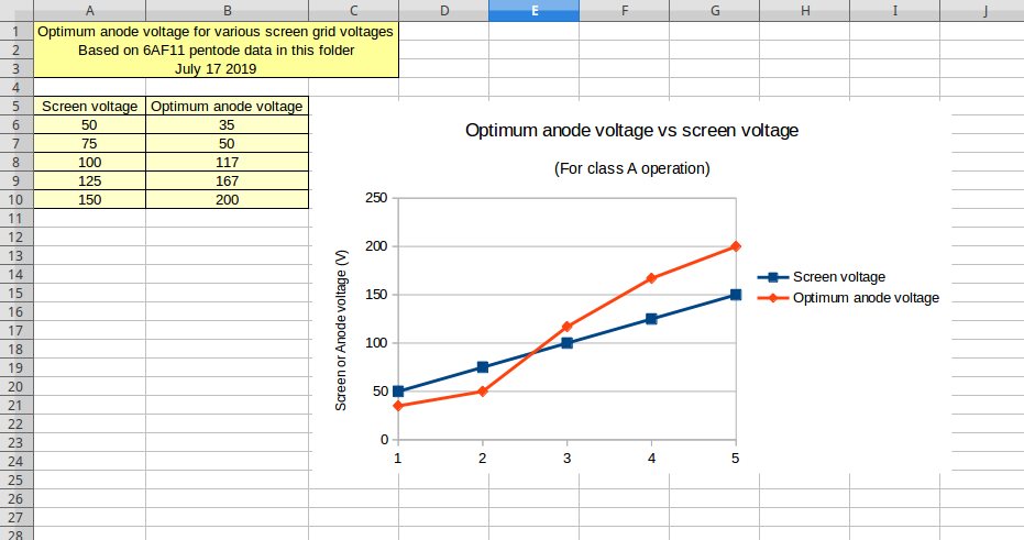

Item two: I put those numbers into a spread-sheet, and plotted them (second image.)
When the screen voltage is very low (50 V), the optimum anode voltage is about 35V. Put another way, the optimum screen voltage is greater than the anode voltage at low anode voltages.
As the screen voltage is increased, the optimum anode voltage increases faster, and at some point the curves cross over; at high screen voltages, the optimum anode voltage is higher than the screen voltage. Put another way, the optimum screen voltage is lower than the anode voltage at high anode voltages. (Of course this is exactly what we are used to in the vast majority of guitar amps, which have no power-scaling.)
For power-scaling purposes, it may be easier to visualize starting at full B+ (anode voltage), and lowering it from there. The conclusion is that we should start out with screen voltage below anode voltage, but as we reduce anode voltage, the screen voltage should fall less rapidly, until at some point it crosses over and becomes greater than the anode voltage.
I do not know how universally applicable this conclusion might be - does it apply to all pentodes? All beam tetrodes? Only this particular pentode from the 6AF11? It's hard to be sure, but I suspect it will, in fact, apply broadly to all or most pentodes and beam tetrodes.
It's tempting to think of applying modern electronics to crack this particular nut - use an Arduino or similar cheap microcontroller to measure the anode voltage, use a look-up table to find the optimum screen voltage, and set the screen voltage accordingly using a D/A converter and power MOSFET. That would allow fine-tuning by ear for the most consistent guitar tone over the entire range of power scaling. All the magic would be in the numbers stored in that look-up table.
The Arduino I used doesn't have a built-in D/A converter, but there is probably a more powerful model that does. The Arduino can only spit out voltage up to +5V, so there would need to be a little voltage amplifier between Arduino and power MOSFET.
I'm sure we could also get "close enough for jazz" with a potentiometer, a handful of resistors, and a couple of MOSFETs. This is presumably what Kevin O'Connor did, very successfully, several decades ago. Smart man.
Note that this entire post is based only on data for Vg1 = 0; zero volts at the control grid. That's because that's the only data available in the 6AF11 data-sheet. There is a big chunk missing from this analysis, because we didn't / couldn't look at Vg1 (control grid) voltage scaling. But it may be somewhat reasonable to believe that "what happens at zero volts, happens at non-zero volts"; in other words, the broad conclusions probably apply even if we had used, say, curves for Vg1=(-5V) at various Vg2 to perform the analysis.

The light-bulb came on in my head an hour ago, see attached schematic. (R2+R4 can be a linear pot, and sets the rate at which Vg2 falls wrt Va. V1 is a Zener or other voltage reference, and sets how far Vg2 is below Va when Va is at its maximum (= B+). Beautifully simple.
For analysis purposes, keep the signal frequency the same as the power scaling knob is turned, and the speaker impedance will stay constant. Or plug in a dummy load. To get anywhere when trying to create a mathematical model of a physical phenomenon, we have to strip away variables that complicate the analysis needlessly, unless they are absolutely vital. I can't think of a reason why a speaker impedance curve will affect a 1W amp differently than a 10W one, so I don't think it's a relevant variable here.Also: your analysis was for "known" load slicing through the knee (what the vet just did to my dog).
So: there is more than one way to skin a cat, or scale a poweramp...
