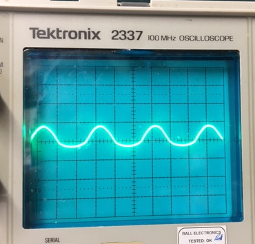

Screenshot of smooth clipper doing it's thing to a 600ish Hz signal. Not a whole pile of headroom above this (about 3db) before you get limiting. Very different to both default and LED-removed sound

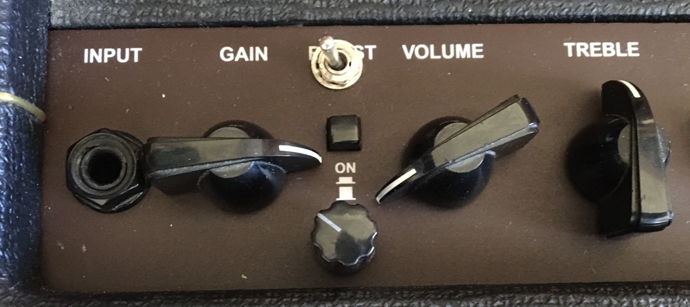

Top panel with switchable (stock/LED-mod/smooth) clipping and boost gain setting. Both controls are worthwhile, even if I want to tweak the custom clipper board (it's too sensitive to gain settings)
That's about as close as I could get the switch without hitting the PCB. You might be clever than me
