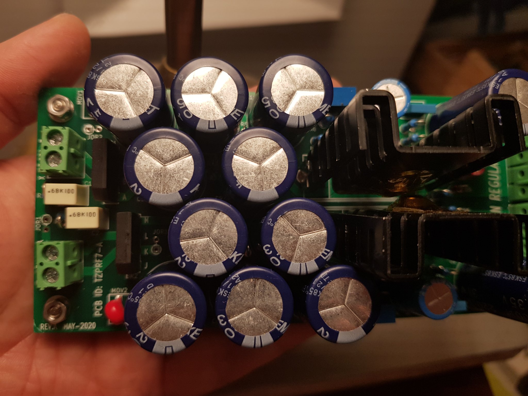

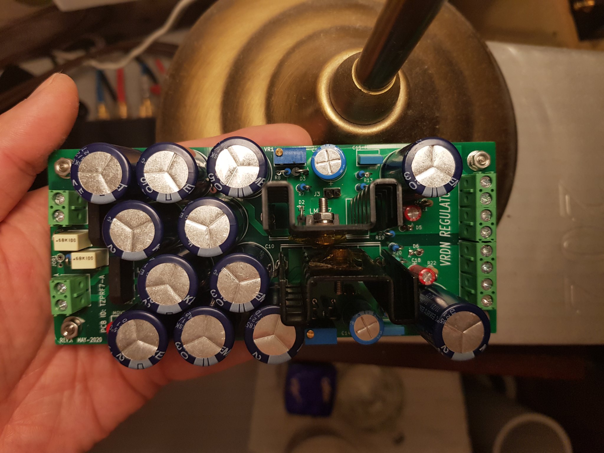

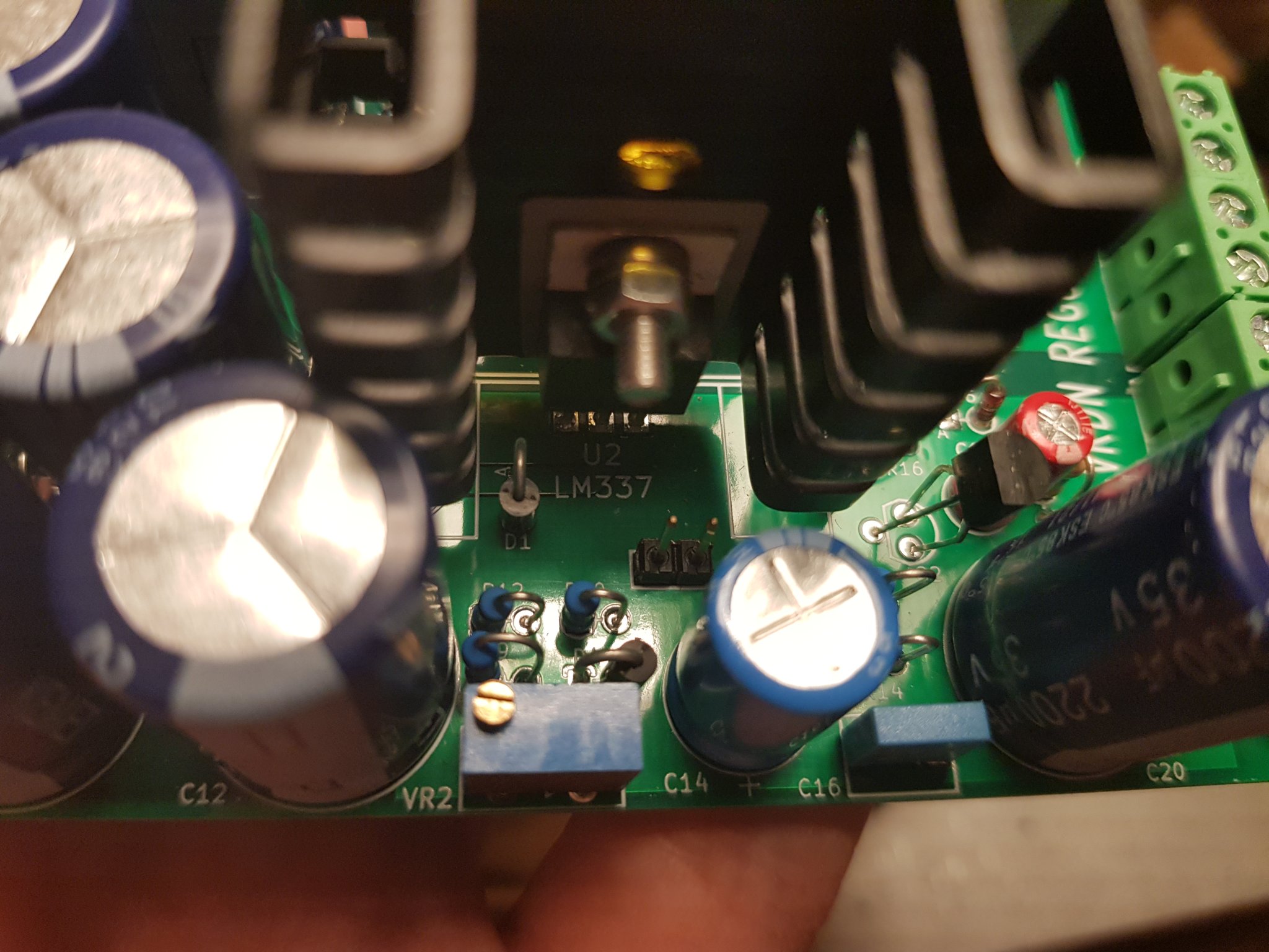

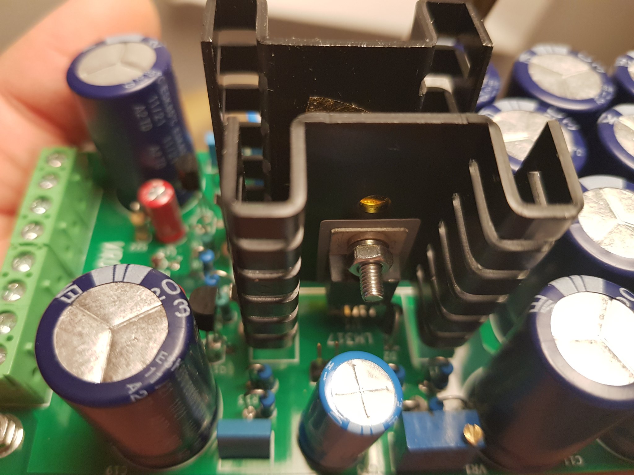

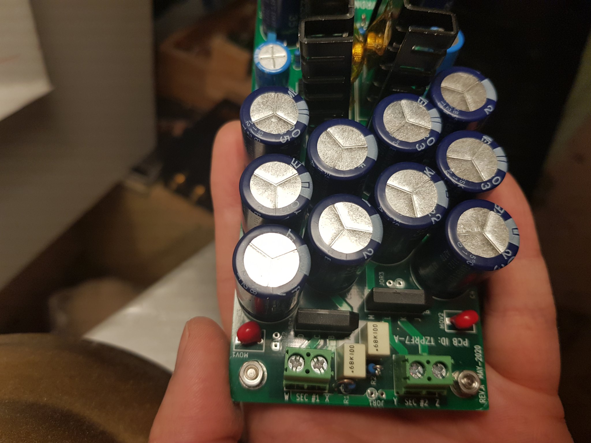

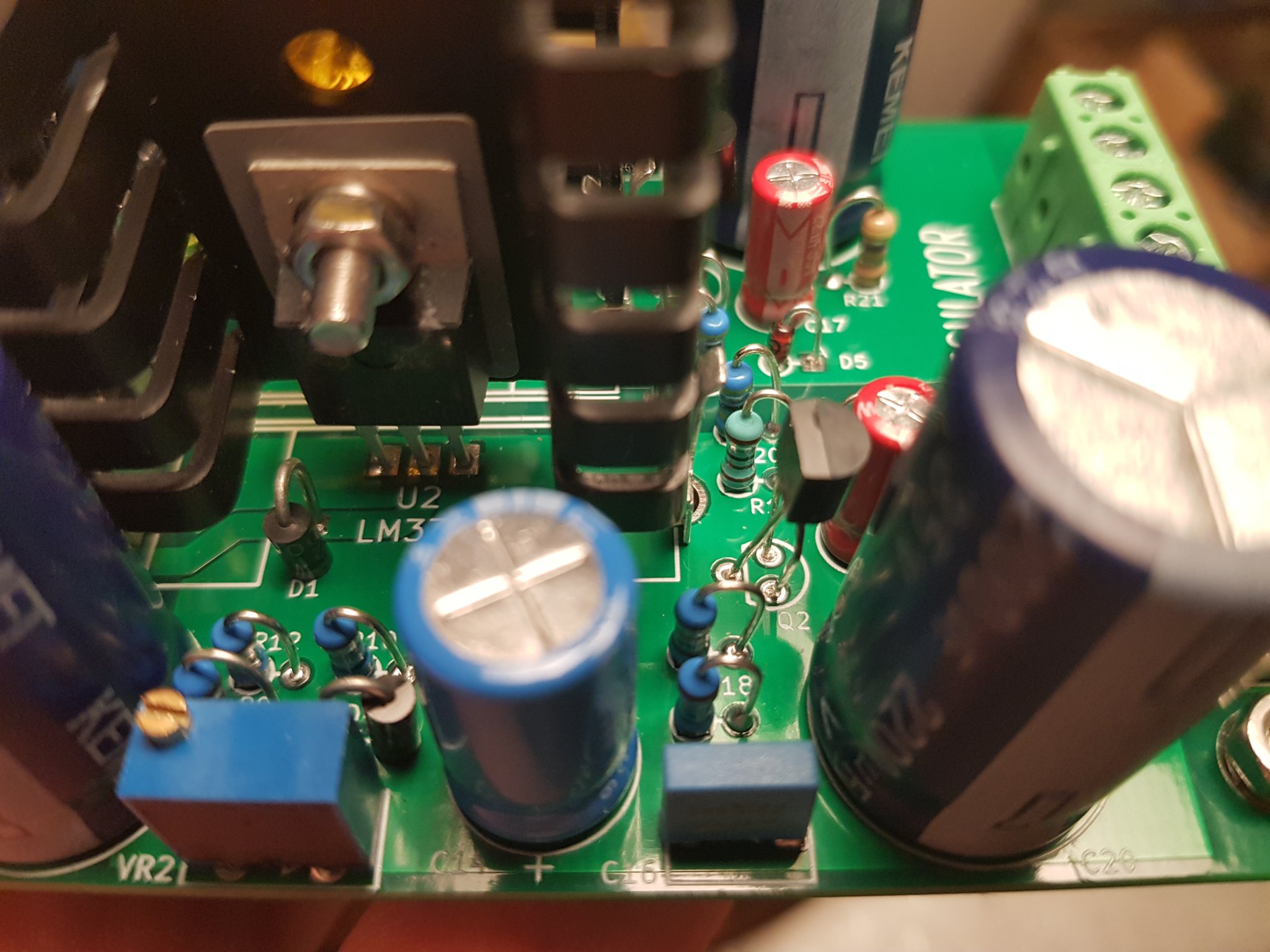

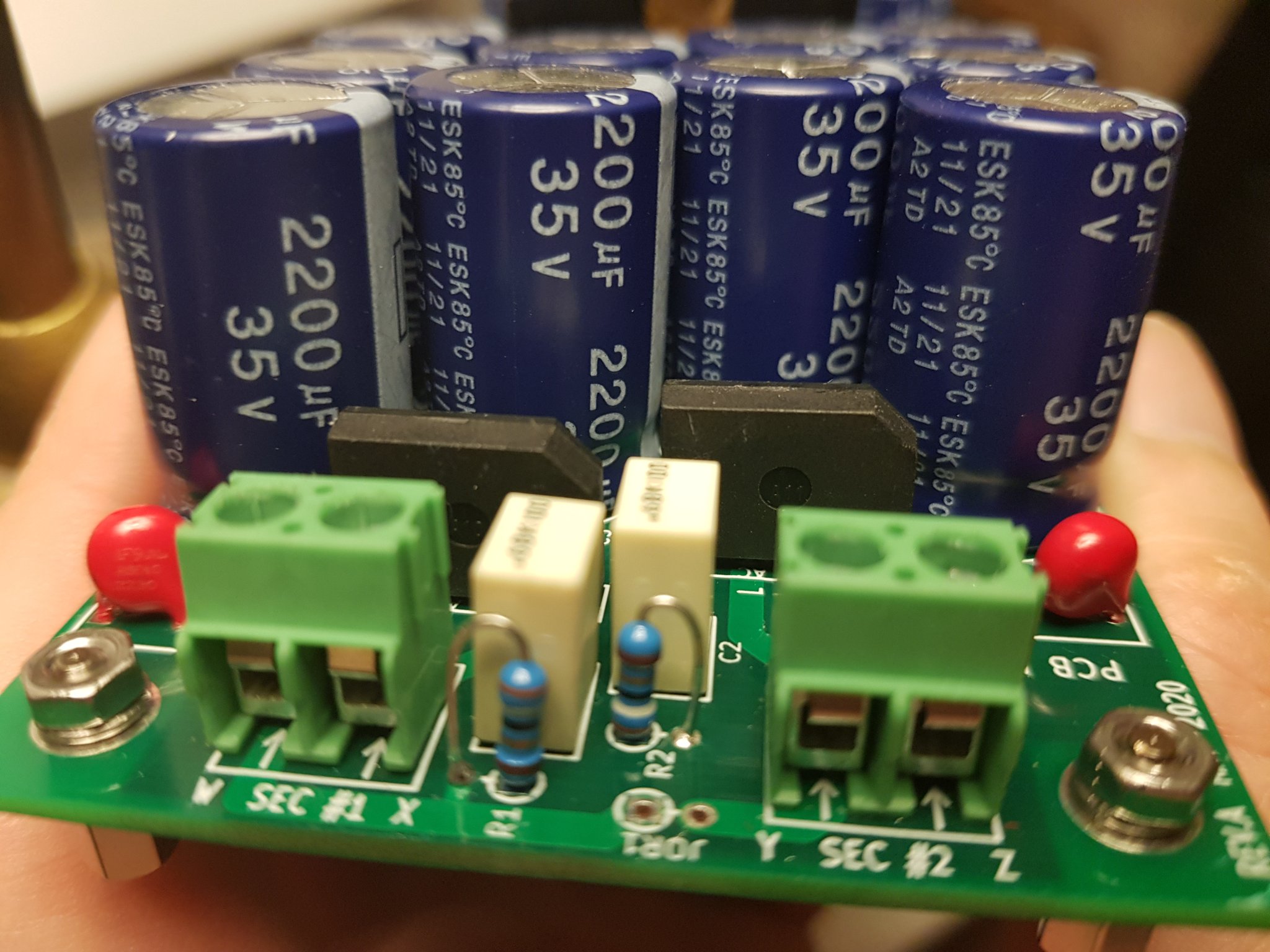

I've made a VRDN PSU but it did not make stable output with onsemi 317, 337 and a toroidial transformer 25VA 18-0 dual secondary.
It happened also with connecting the jumpers of bypassing denoiser.
Did I make any mistaks?

I wouldn't worry too much about a $50 multimeter whose displayed output voltage flickers between 18.00V and 17.99V. But if you remain deeply, deeply concerned/worried, you could (A) load the outputs with resistors-to-ground which draw approximately the same current as your final audio gear will draw from VRDN; and also (B) monitor the output waveform with an oscilloscope instead of a multimeter.
For example, if your application calls for VRDN to deliver 25mA to the left channel +18V supply, and another 25mA to the right channel +18V supply, that's a total of 50mA from VRDN's +18 output. Ohm's Law tells us that a 360 ohm resistor has the same current draw {math: 18V = 0.05A * 360 ohms} so if you've got a 330 ohm or 390 ohm or 360 ohm resistor, connect it between VRDN +18V and ground, to achieve a same-current load.
