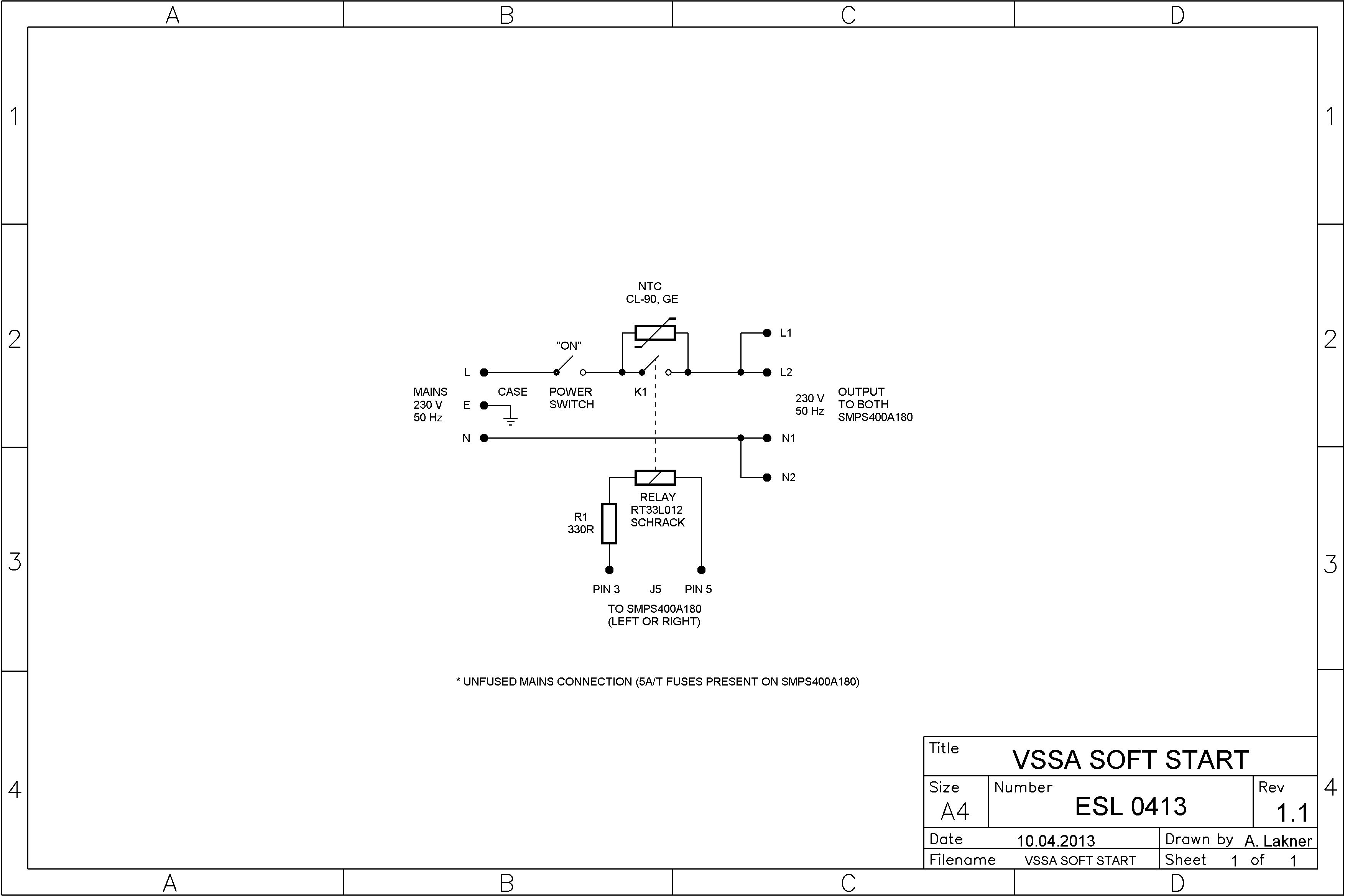

Just acquired 2 modified SMPS400A180 (as per LC recommendation) but I'd like to re-install the NTC to prevent inrush.
Does anyone know the value or model number of the NTC (R45 on PCB) so I can order a few.
TIA,
Eric

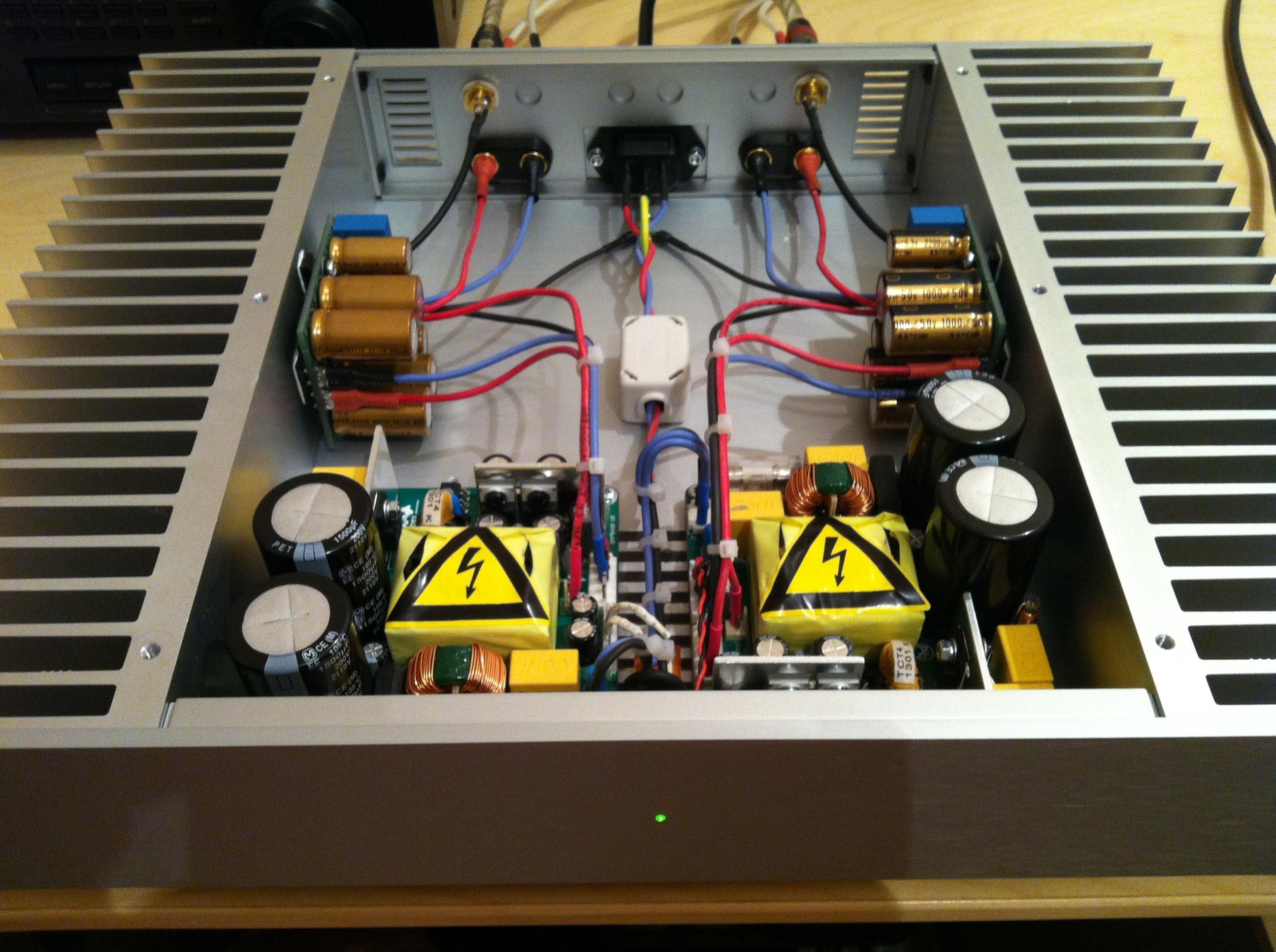

Picture one is schematic how LC did mod inrush current by a error free soft start circuit (orange RTL33L012 relay and black CL-90 NTC is just viewable in picture two behind green led in front panel), and zoom in on picture two to see DC sense protection wire from hot speaker output going back to Hypex connector pin.
This is great, thanks.
p.s. Looks like R1 (330 ohm) must be rated 1W.
There is a wire connected to J6, is this the DC error detection that will shutdown the SMPS400A180 ? Can this be used instead of a speaker protection module ?

Soft start schematic is OK, thanks Byrtt ;)
R1 dissipates 33 mA * 10 V= 330 mW, so normal 0,5 or 1 W ressistor is OK.
SMPS400 has direct DC sense input, meaning direct +OUT wire connection to J6 pin 1 or 2 (page 9 in datasheet) and that is working fluently (100 kohm input impedance from J6 pin 1 or 2 to GND).
Yes, this arrangement can be used instead of speaker protection since in a case of DC error SMPS400 will shut down instantly.
L.C. :cheers:

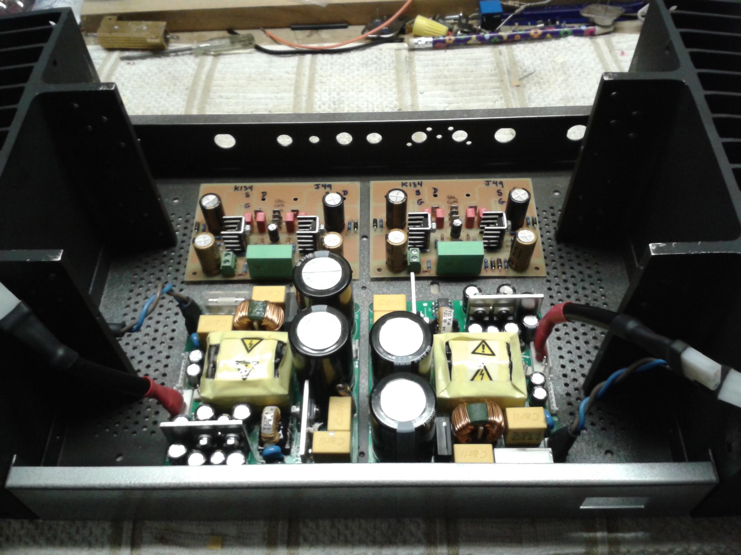

Pic of inside my VSSA (Hafler 220 enclosure)
BR,
Eric

Another great advise, thanks :)
One more question : On my heatsinks I have room to install 2 x pairs of LatMos per channel therefore 4 Mosfet/amp, some people say that parrallel output device sounds worst some say it sounds better...how about VSSA, my load will be 4 ohm if that makes a difference.
Thanks again.
Eric

What i've seen around here VSSA one pair output device configuration had no problems driving 4 ohm loads and feeding it by one SMPS per channel as in your setup think seems optimal, but If running dual pair maybe SMPS400A180 is too weak.
LC made a dual pair version in form of one pair which has double die, link is here and it looks great and have impressive specs but needs another beast of an PSU to feed it http://www.diyaudio.com/forums/vendors-bazaar/248996-first-one-mosfet-amplifier-module.html. If you later experience VSSA is too weak for your needs then a pair of First One modules could be the solution.
