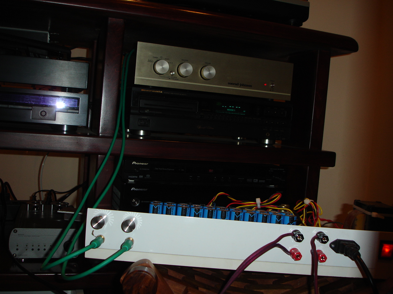

vssa under listening test.
Photo No 1 vssa together with conrad johnson valve pro.

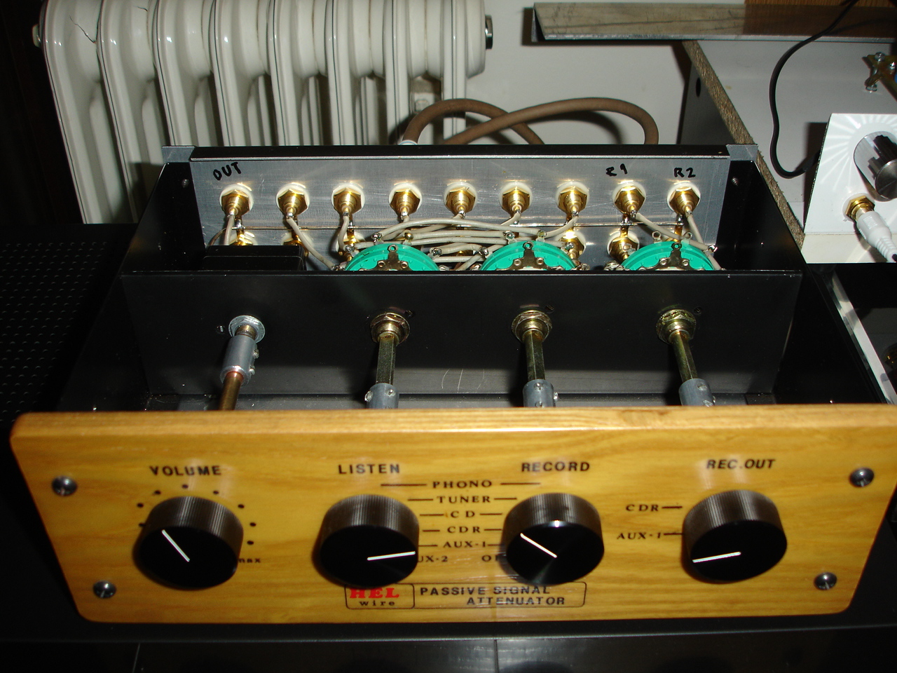

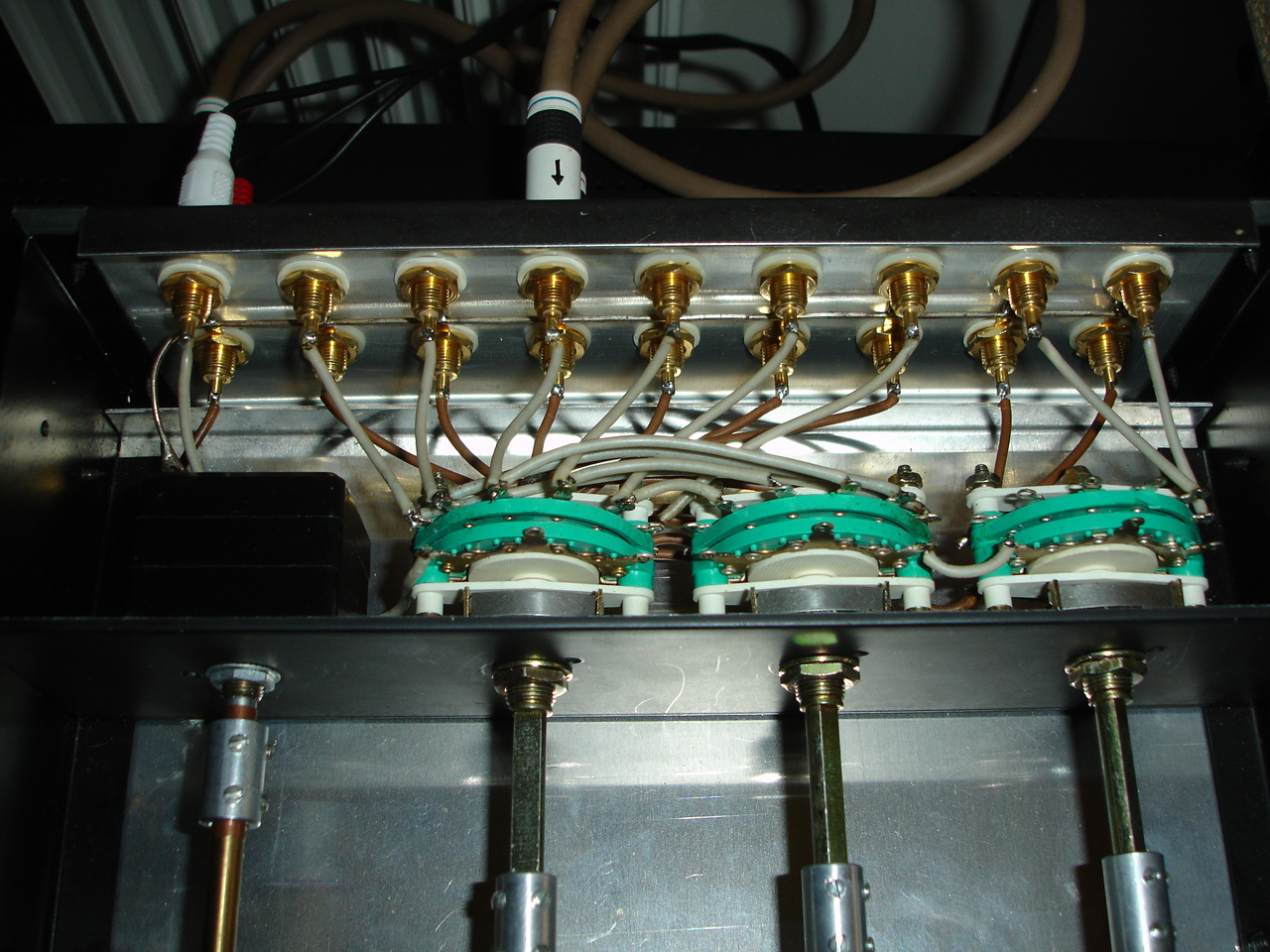

Photo No 2 and No 5 vssa together with a passive attenator.

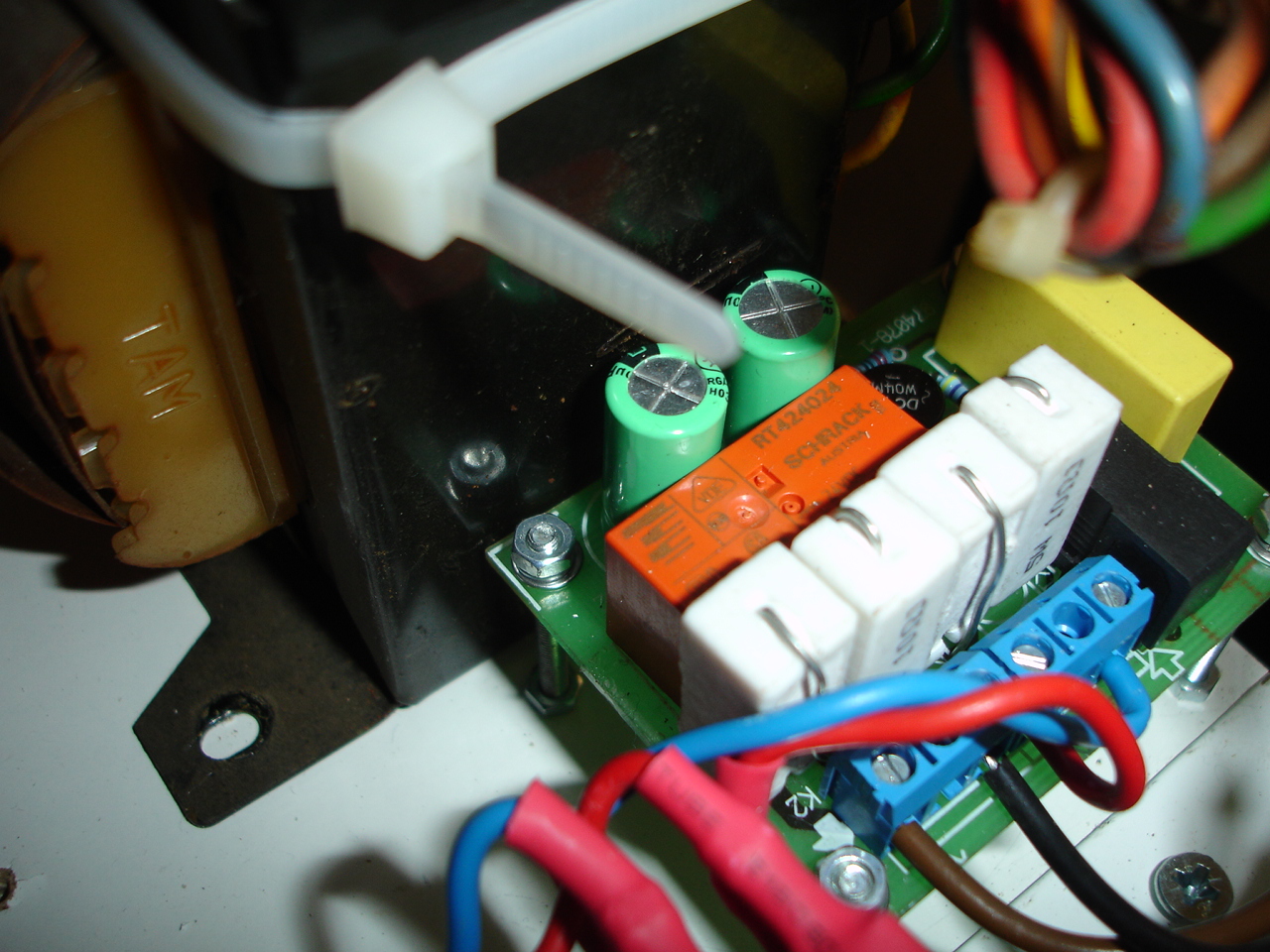

Photo No 3 the soft start circuit.

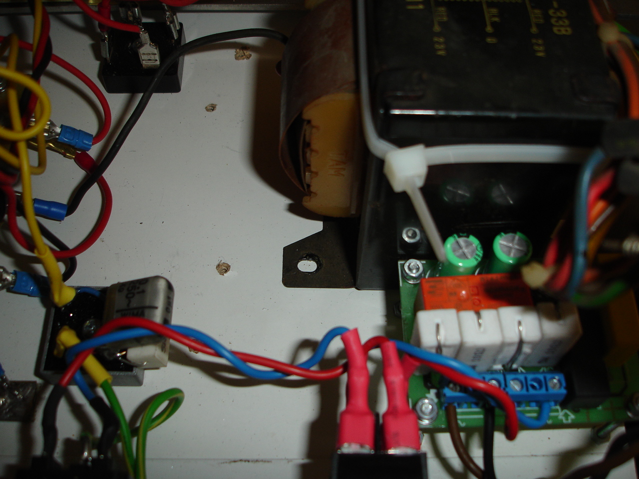

Photo No 4 the ground breaker and the soft start.

Guys this is an amplifier that everybody must listened.
It is so analytic ,you hear all the organs even these in the Backstage.
You can listen even fingers on strings!
Yesterday me and my friend listened this for about 4 hours.
We listened all the kinds of music and Greek music of cource!
The reference amplifier was a Hafler
We have the same opinion.
The reference amplifier haven't any advandage against this vssa!
As we can hear at least...

Hi Jason truth is that we didn't push this vssa very hard (at limits) this wasn't necessary.
On the other hand we can't push this because heatsink is small just for test .
