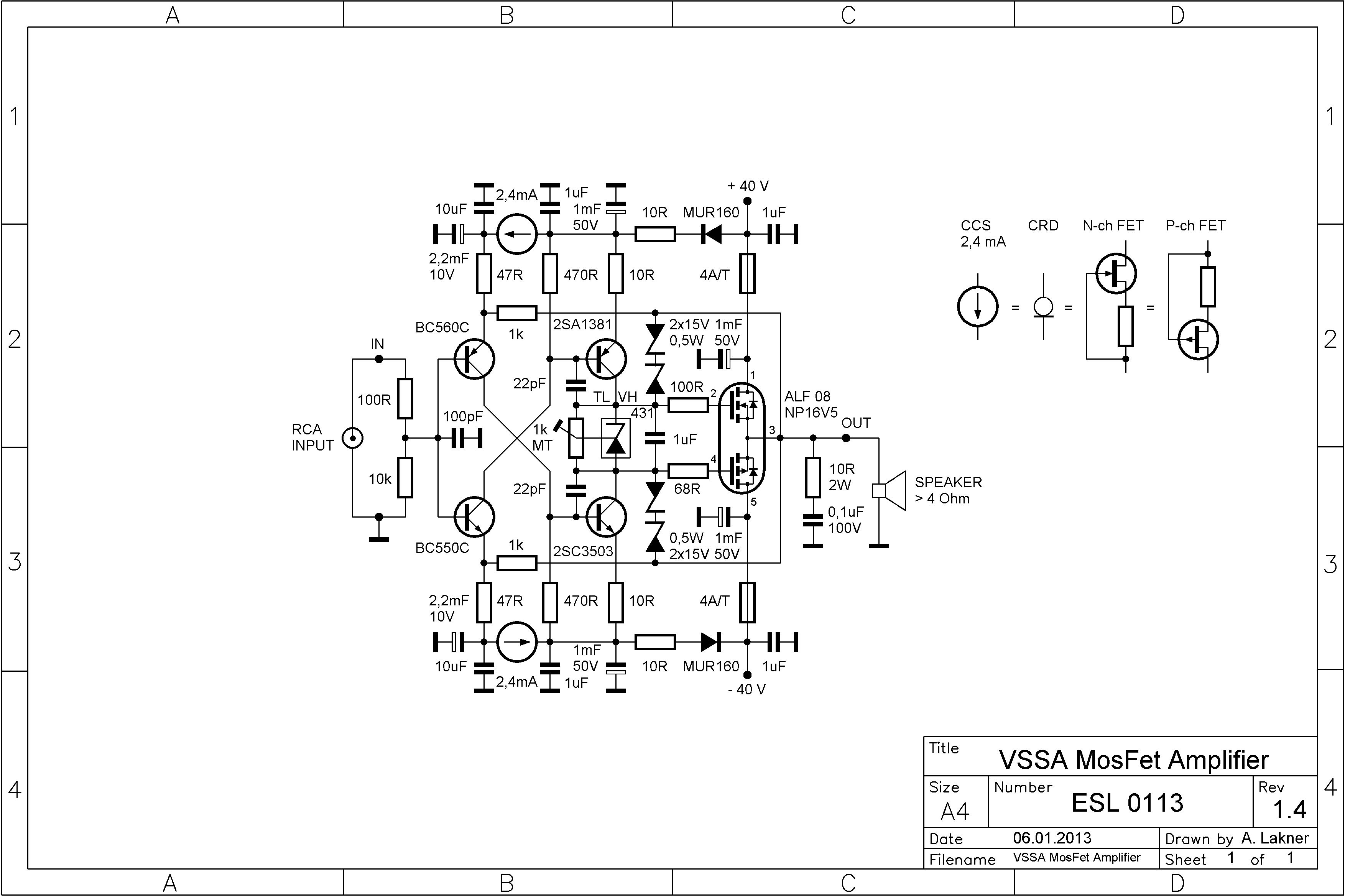

Can you tell us where we can find the schematic this p.c.b based?
Hi Thimios,
I don't have the schematic :eek:
Look at Jason reply :
thimios,
It looks like John used the VSSA schematic in Lazy Cat's thread using more common parts, or at least it should be very close >HERE<
Thanks Jason,
Yes this one is the closest schematic but with some bigger parts that's available here at local store :)

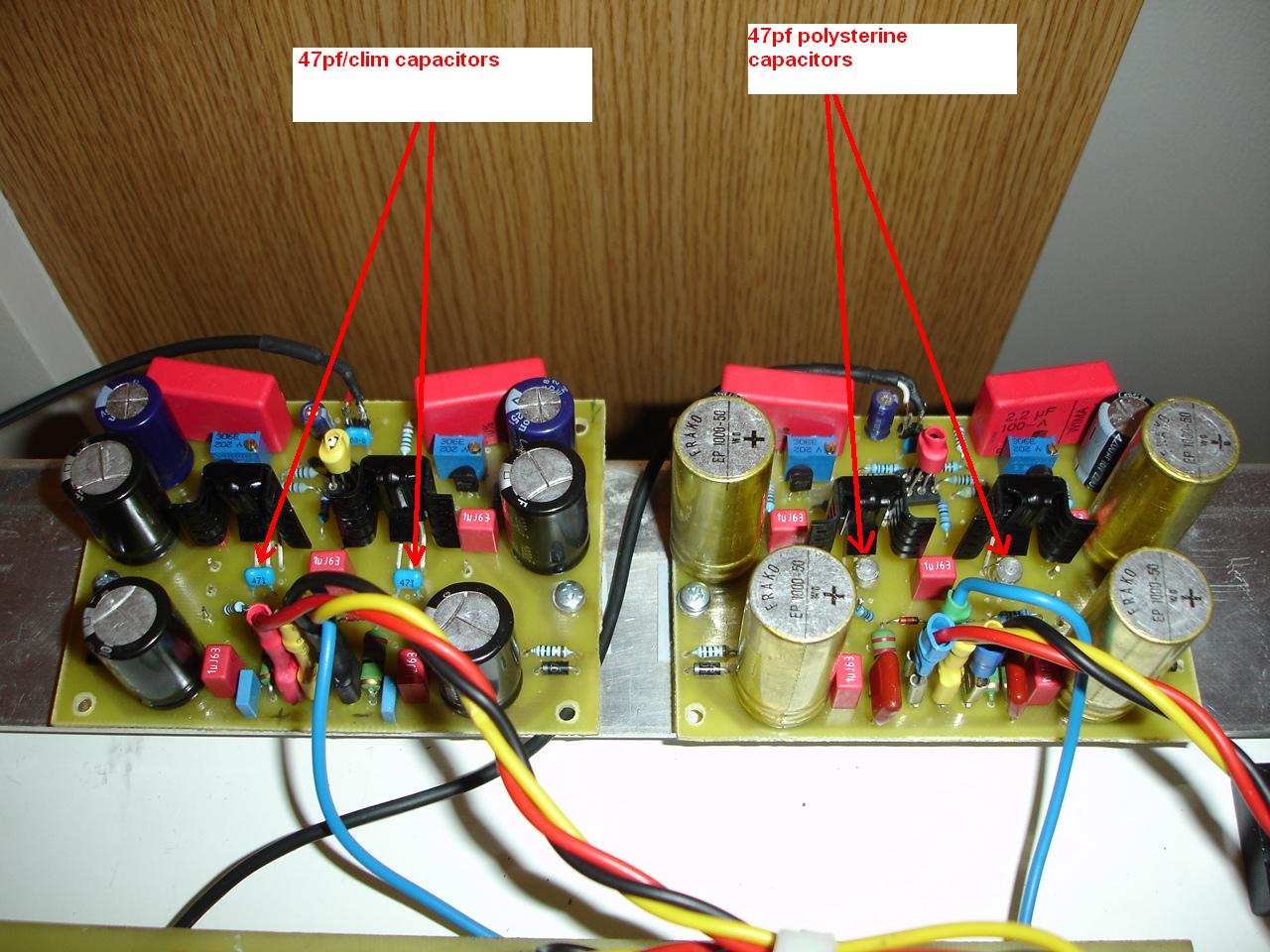

I want to run this in mono mode.
Each channel powered with two laptop supplies,one for + rail and the other for - rail.
One channel (this with polystyrene compensation)run well ,just a little warm zobel,when the other(this with claim compensation) smoke the 10R gnd lift resistor and the zobel resistor .
Each channel tested separately,only one channel runs each time.
Scope show oscillations.
That isn't present when modules run from a linear power supply.
Opinions please

471 is 470 pf not 47.
