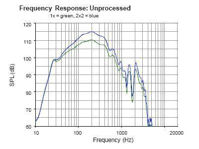

Eaw kf940 bass horn.
2x12"
Bent horn path
13' long
Maybe 3-4 ft2 of mouth
Here is their graph of the response of 1 vs 4 units.
Notice good coupling at 200hz, almost none at 30hz.
But the benefit is 10db of boost can be spread across 8 drivers easier than 1.
Looks to me just 1 well placed notch with fine-adjusted q would make that flat from 50-60hz up to nearly 400hz. -6db at 30 doesn't seem too bad?
Not really. In the PA world, we'd use a bigger amp and give all the drivers some pain.
