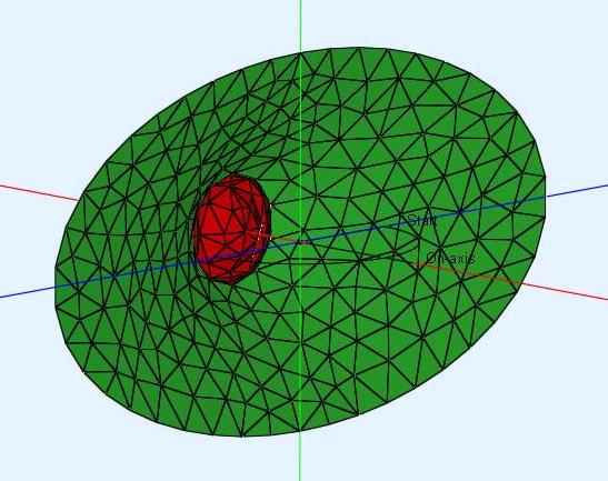

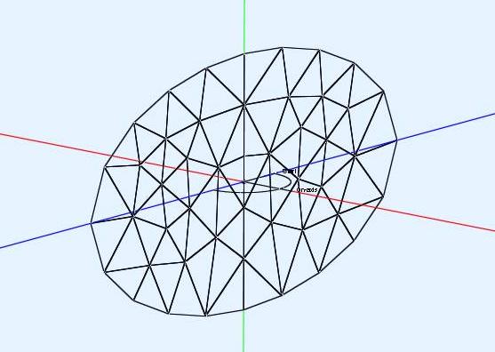

It seems ABEC is not reading geometry at all, is reading the mesh you give it and, presumably, uses it at low frequencies and subdivides at higher frequencies when the wavelength is too small for the element size. The problem is that without the geometry it doesn't know where to place the new vertices. If ABEC linearly interpolates the vertices of the original mesh then the edges of the original mesh will remain in the waveguide causing errors in the solution. Can you see this in the results?Open the STEP or IGES-file, or whatever format you have used during exporting the CAD drawing, in the meshing-tool application, such as GMESH, GID or FEMAP. Here you create the first mesh. This mesh should be as coarse as possible. Note, that eventually ABEC will provide its own meshing on top of the first mesh. ABEC can refine the mesh but can not simplify it. See at chapter Meshing.
One fairly common option is to interpolate using the vertices and the normals at the vertices which will make the coarse triangles curved and closer to the curved waveguide. However, this causes some complications such as vertices lying on real edges of the geometry needing two normals for the two meeting surfaces. The grid generator will need to know this information is required in the file and not just the vertices. Does ABEC discuss this as an option?
Another alternative would be a sequence of grids from coarse to fine created by the grid generator. Is this discussed by ABEC?
Another alternative could be to give ABEC a grid fine enough for the highest frequency and accept the low frequencies will have an unnecessarily fine grid. There will be no accuracy issues but the simulation will take much longer to run.
Yes, I see this happening when I try to use a coarse mesh at the first meshing stage. After importing this mesh to ABEC, it creates a finer mesh but the original sharp edges remain. I am not sure if this is affecting my result.
I don't think ABEC has such an option. As you said, it splits elements according to the specified parameters. It also offers two meshing methods:
'ABEC offers two types of mesh-generation: Bifurcation and Delaunay. Bifurcation is a technique where each specified quadrilateral and triangle is split into two new items in an attempt to yield a regular shape and simultaneously satisfy the specified mesh-criteria. Delaunay is an advanced schema [8], which triangulizes any shape directly in a most regular way. For most elements in ABEC the mesh-type can be selected and there are optional control parameters.'(The parameters are element size, angle constraint and number of iterations)
Perhaps someone reading this thread might have more information?
I don't think so.Another alternative would be a sequence of grids from coarse to fine created by the grid generator. Is this discussed by ABEC?
Yes, currently this is the method I am following. What I am also trying to do is to mesh parts of the structure using different element sizes so that computation time can be reduced. I tried using larger element sizes for the enclosure and smaller ones for the waveguide but ABEC just does not like it! The directivity plot loses accuracy beyond a certain frequency.Another alternative could be to give ABEC a grid fine enough for the highest frequency and accept the low frequencies will have an unnecessarily fine grid. There will be no accuracy issues but the simulation will take much longer to run.
One further thought. Does ABEC support higher order elements? If it does and you are currently using 3 node triangles then switching to ones with more nodes will mean the geometry with a coarse grid will be much better represented with curved elements (and so will the sound field enabling less elements for a given level of accuracy).
It will at higher frequencies. The SEAS DXT for example uses diffraction from creases as part of the design of the waveguide.After importing this mesh to ABEC, it creates a finer mesh but the original sharp edges remain. I am not sure if this is affecting my result.

You really hit the nail on the head! I used a fine mesh in GMSH this time. To my surprise, ABEC computes faster when I use a higher meshing frequency(in ABEC)! This might be due to the dense mesh I made in GMSH. Yeah seems like a multi core processor will make it a lot easier. Thank you Andy and NailHead.
Sad part is that even though I only require the directivity plot for the waveguide, I have to model an enclosure to avoid low frequency radiation appearing in the directivity plot. Also I have to mesh the enclosure using the same fine mesh as the waveguide. This again increases the computation time.

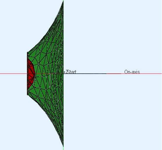

Using one quadrant has reduced the computation time considerably. I was wondering if I have assigned the right subdomains to parts of the waveguide. I am using only two subdomains(1-Interior and 2-Exterior). I have assigned the diaphragm and waveguide as interior subdomain and the enclosure as exterior. This configuration does not give me the right directivity plot. Since the waveguide is actually part of exterior of the enclosure, I tried assigning the waveguide to exterior subdomain. This gave me a much better dirctivity plot showing fairly constant directivity from 2000 to 10000Hz. Is this method right?
In the last model you showed us, you also had modelled the back of the waveguide - this is not shown here. Is this a different model?
Ok, if you are using an interface like it is shown here, diaphragm and waveguide should be in same interior subdomain. But you also would need an exterior subdomain i.e. an enclosure or an infinite baffle.
For checking you can leave the interface and put everything together in one exterior subdomain.
Also you can feel free to upload it here and I'll have a look into it.
Sorry for the late reply. I have been experimenting with two models. In one model I have made the waveguide a solid(with an interior and exterior). In the other, I have modeled only the waveguide interior and have approximated the exterior using a simple wall(Like in the H400 example). I am getting good results with the latter. However, changing the damping value of the waveguide seem to be affecting the directivity pattern greatly. I was wondering what value of damping would be close to real world values.
