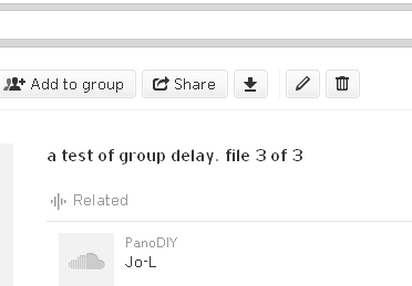

If you want to test this by listening, I've made some files for you. You'll recognize the song.
It has good content below 100Hz
The audio file was split into 2 parts, one was 4th order low pass filtered at 100Hz, the other high pass filtered at 125Hz. The spread is because the filter is butterworth and combines flatter with the slight spread. The file was then recombined. Phase is rotated 180 degs at 110Hz (because of the spread) and continues down to 360 degs at DC. Or vice-versa, depending on how you look at it.
The files are here, you can download them. About 1 min long, each 2.2meg in 320KBS mp3 format. Can you tell which was manipulated, and which was not? Or at least if there is a difference or not between the 3?
I don't think you'll spoil the fun.
Let us know what you hear or don't hear. I'll post which files are which later.

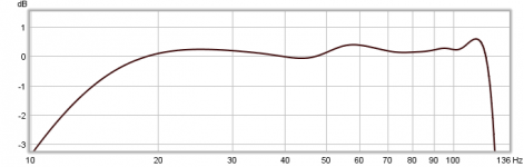

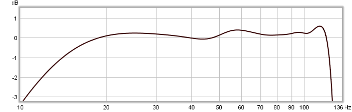

Here is response of highly corrected cardioid woofer system comprised of two 12" drivers; one in 'U' frame, the other sealed:
Frequency response:
![sub fr.png sub fr.png](https://www.diyaudio.com/community/data/attachments/302/302104-917887f4f2151b63b30f342c7ef9d5f1.jpg)

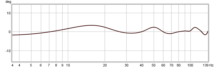

Phase:
![sub phase.png sub phase.png](https://www.diyaudio.com/community/data/attachments/302/302119-6049cf1c11060815acf5d57115a6b75d.jpg)

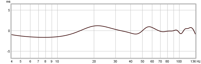

Group Delay:
![sub gd.png sub gd.png](https://www.diyaudio.com/community/data/attachments/302/302135-573a8aecf6b5cf02c5453a8c4d8423d8.jpg)
I cross this into various similarly corrected two way speakers, and the difference is night and day. Articulation is exceptionally good. I haven't spent time looking for a GD threshold.

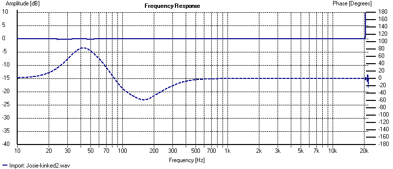

If you want to test this by listening, I've made some files for you. You'll recognize the song.It has good content below 100Hz
i don't think this is a way to modify group delay.(if i've understood what you've done
reverse polarity of the low pass will only affect the recovery region.
group delay is define by -(delta phase/delta frequency)
no more phase delay when reverse polarity.
the two group delay are the same.
