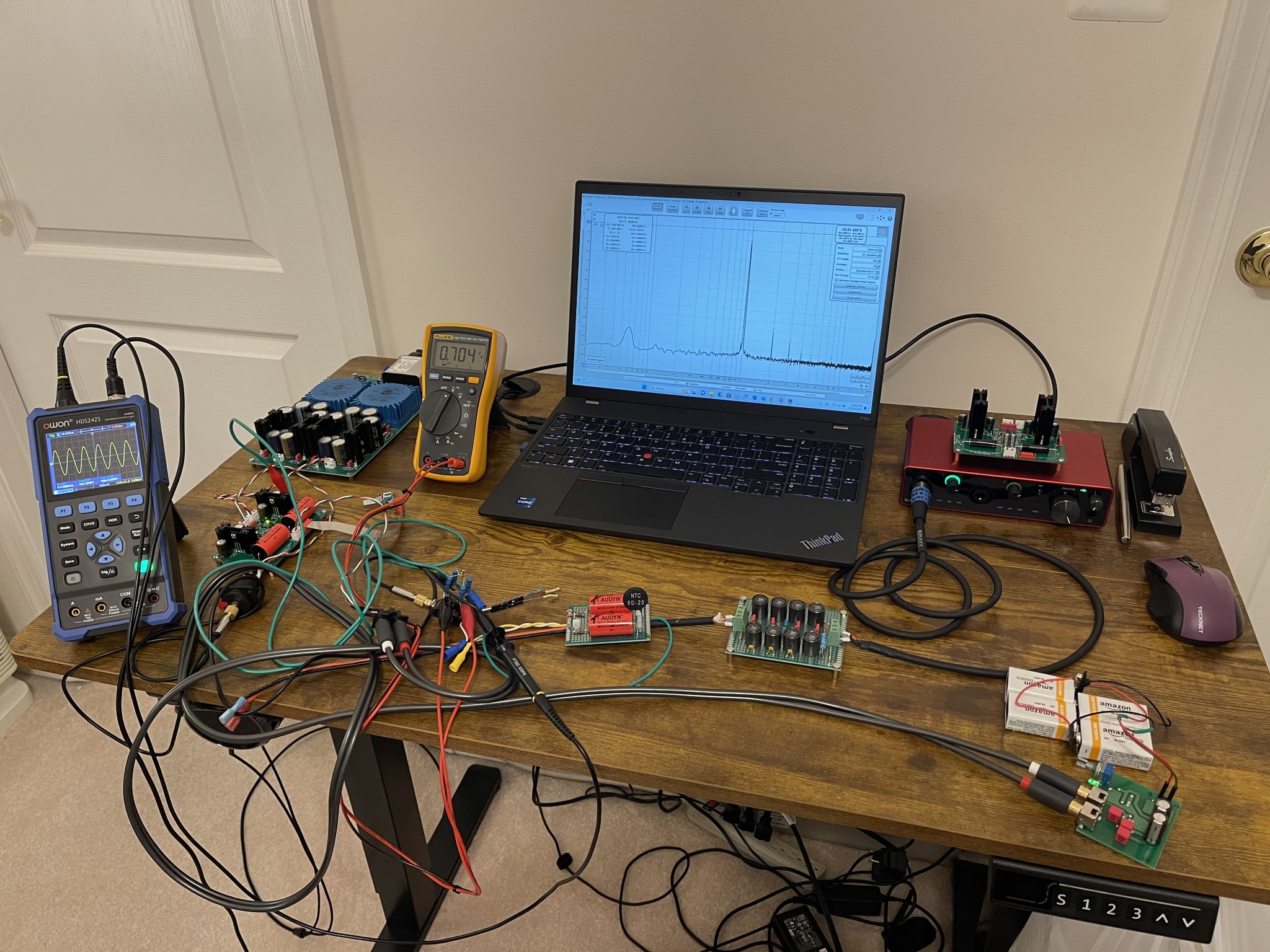

I was surprised what a difference that made to harmonic profile. I was also surprised to see how clean a cheap little DCDC converter from 12vdc to +/-12vdc followed by some CRCLCRC filtering can be.
I find this statement very interesting, X. I remember using a DCDC converter without any filtering in the PSU of the AKSA Lender preamp (after you recommended it's use) and was surprised how quiet it is. Where can I get more info on the CRCLCRC filter you mention? A search brought up page 129 of the Super Regulator thread, but I'm not keen on reading 172 pages.

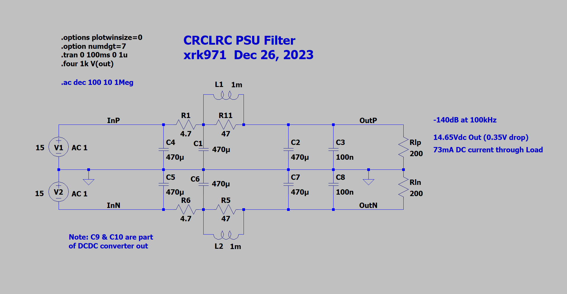

Hi Skylar,

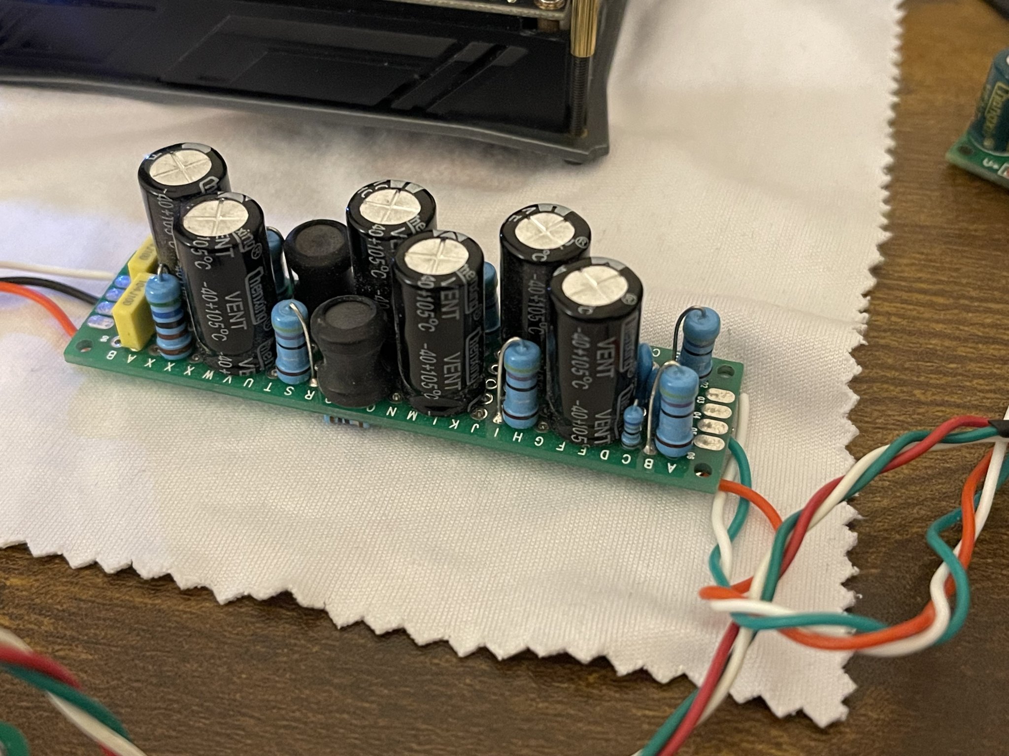

I made this filter years ago by cobbling loose cheap caps and inductors lying around on my bench. Here is a closeup photo of it, and basically I made it using 470uF caps and 4.7R resistors plus a 1mH ferrite core inductor and some 100nF film caps at the exit. There is also a 6k8 bleed resistor to make sure it doesn't hold a charge for long. I sketched it up on LTspice and ran an AC analysis and surprisingly, it has a lot of attenuation at the DCDC switch frequency of 100kHz. Minus -210dB in fact - an amount that exceeds the noise floor of any measurement tool.
Here is the schematic:

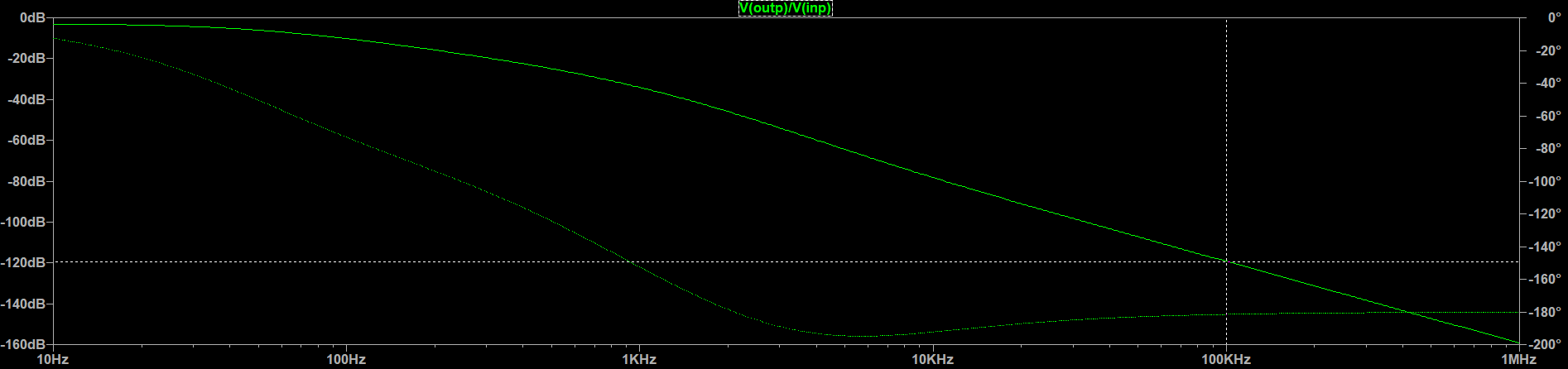

And here is the AC response:

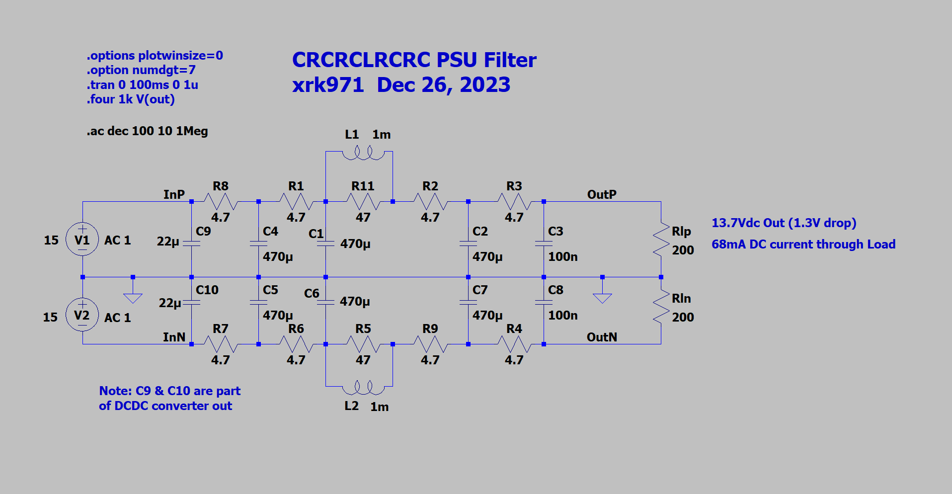

The DC simulation shows that for a 15vdc input, at 68mA of current flow through a 200ohm dummy load, there is a 1.3v dropout. So you probably don't need all of these stages for an effective filter. Anything better than -120dB is more than enough.

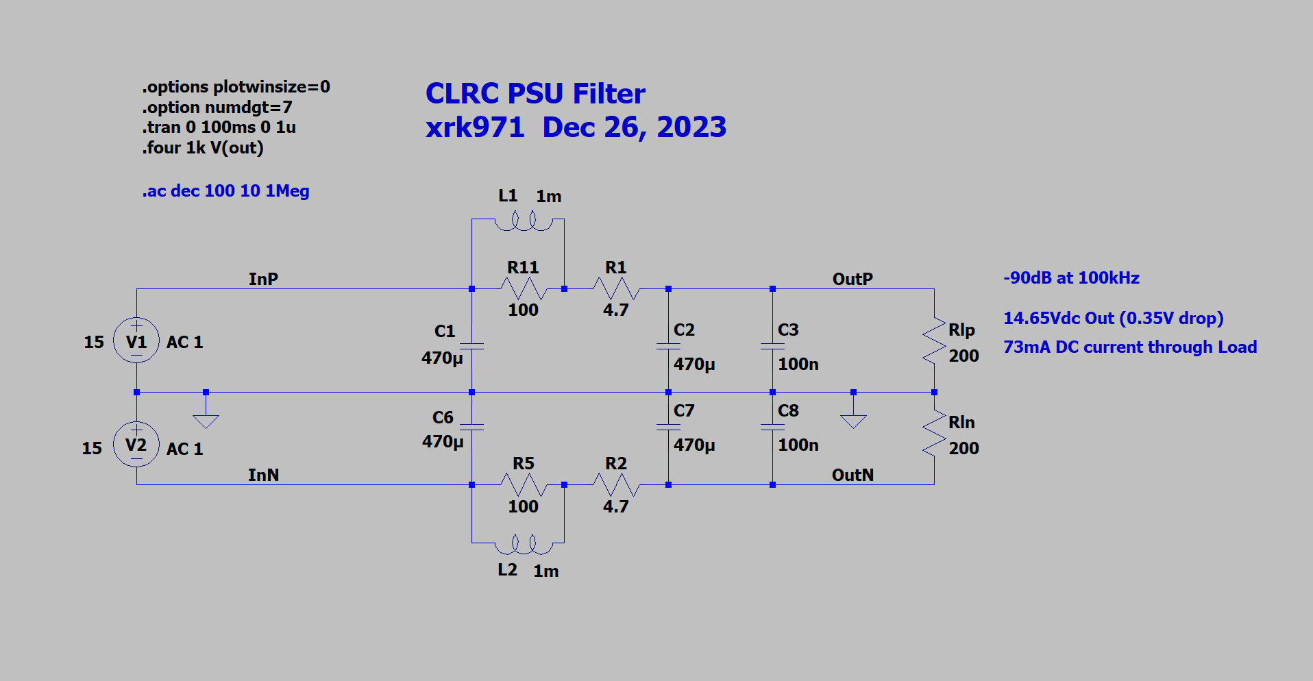

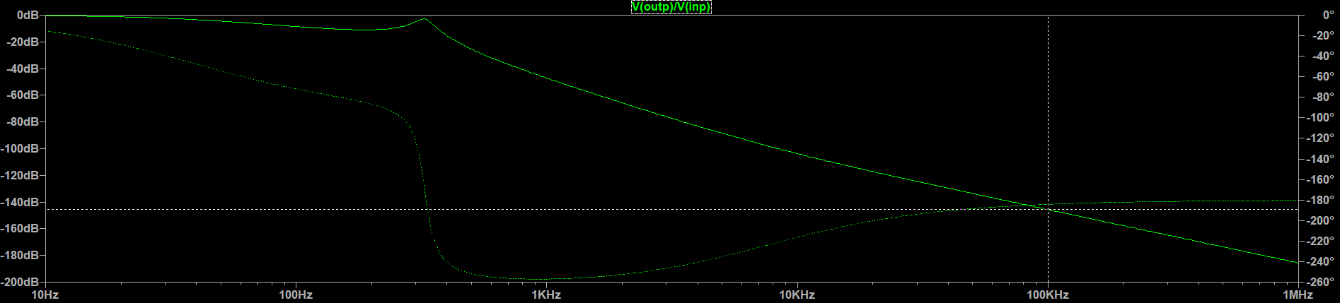

If we simplify to this it still works very well with -140dB at 100khz and only a 0.35v dropout for 73mA current:
Here is the AC response:
If you leave the 4R7 in series with the inductor, the small peak at 400Hz will probably be flatter.
Here is a closeup photo:

So finally, if you make it really simple CLRC filter, you get -90dB at 100kHz and still about 0.35V dropout:
It seems worthwhile to add the extra stage CR in front to get basically complete blockage of SMPS noise.

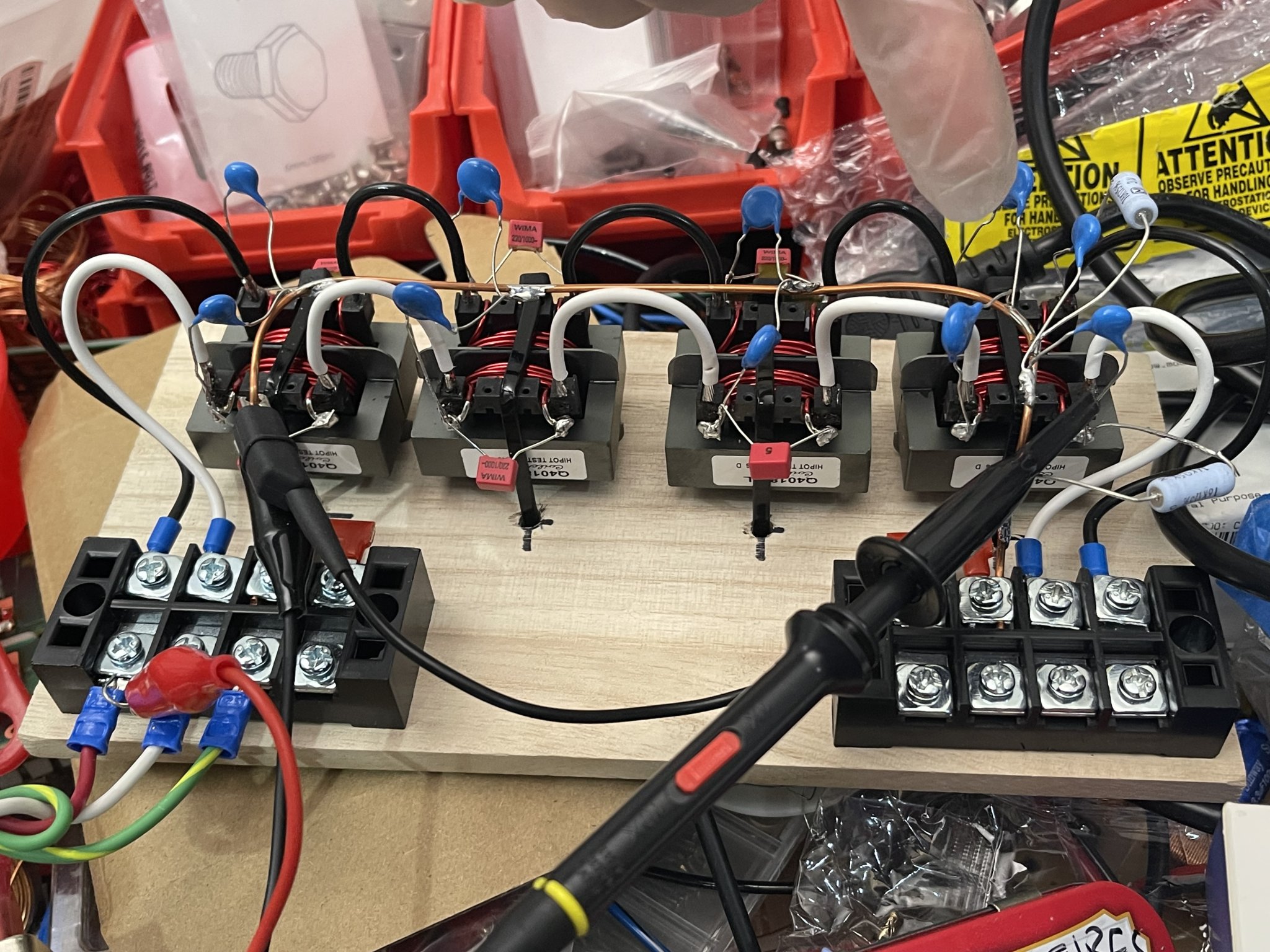

I am designing a mains filter for SMPS noise and it’s important to keep the caps small since they need to be Y2 rated safety caps (fail open) which are not made larger than 2.2uF ($10ea).
I measured a 400Hz signal injected into it and nothing came out the other side (like a black hole). The sims predicted -130dB attenuation but only -36dB for 100kHz. Still quite good and can pass 10A at 250v.
Those are 1.5mH common mode chokes and 2.2nF to 3.9nF Y2 ceramic caps (blue ones).

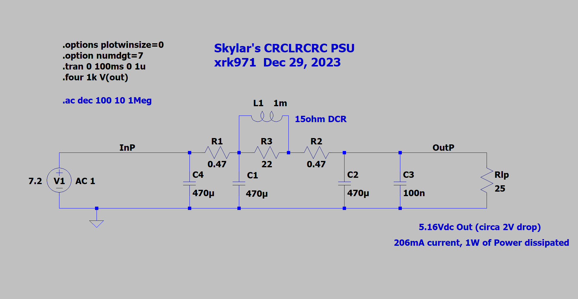

Hi X, I was hallucinating when I said 20mA max draw for the ESP32. I’ve just measured again and it’s 100mA. So, speccing it as 200mA with a healthy safgety margin.
I’m assuming (never a good thing) that 1mH for the inductor is still fine, with 470uF caps. Would you agree?
I’m leaning towards a Kemet 1mH ferrite inductor with 450mA rated current: Mouser Part No 80-SBC9-102-451
I redid the calc with your particular inductor which has 15ohm DCR. I reduced the series resistor values to 0.47 ohm to decrease your voltage loss. I get -120dB at 100kHz for this:
This has a 2v drop for 204mA of current with an input of 7.2Vdc and output of 5.16Vdc. Here is the schematic:
Use 1W resistors if you can, but 0.5W will also work.
Edit: you can probably leave off R2 and it won't matter since L1 already has 15ohms DCR.
