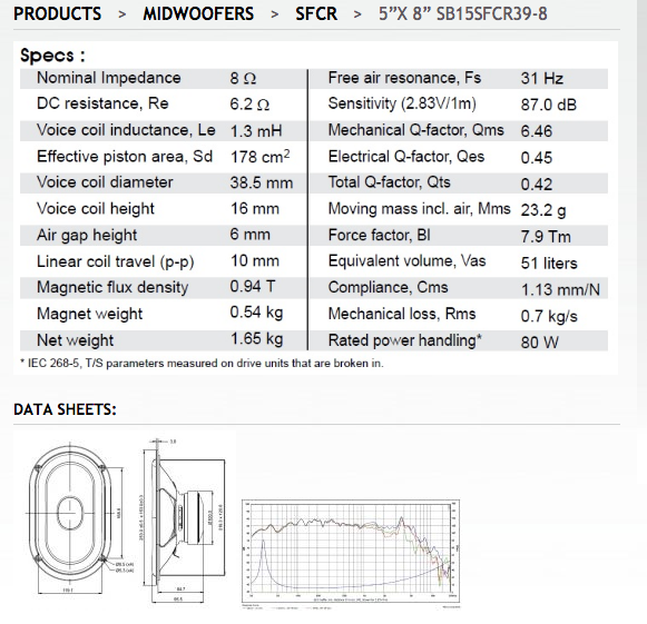

So, as we already know, the woofers will be the 5”X 8” SB15SFCR39-8. Two of them per enclosures.

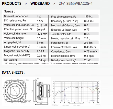

Inside, sandwiched between the 5x8s will be a 2½" SB65WBAC25-4. It will have a sealed space inside the enclosures. This driver has been reviewed as having a great dispersion and great high end reach… close to a tweeter.
These are BYRTT’s measurements of this driver, in FR and dispersion… pretty good!

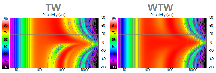

MTM, or in they case WFW, improves the vertical polars, as more data shared by BYRTT showed here

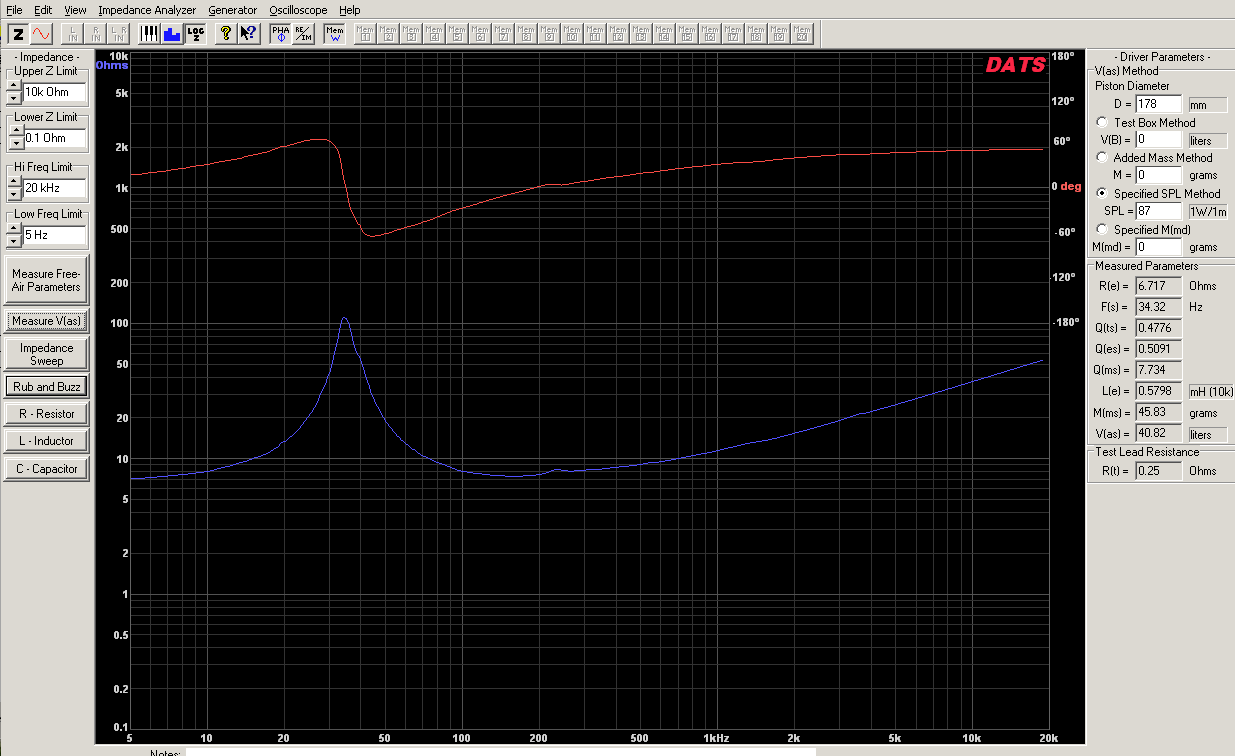

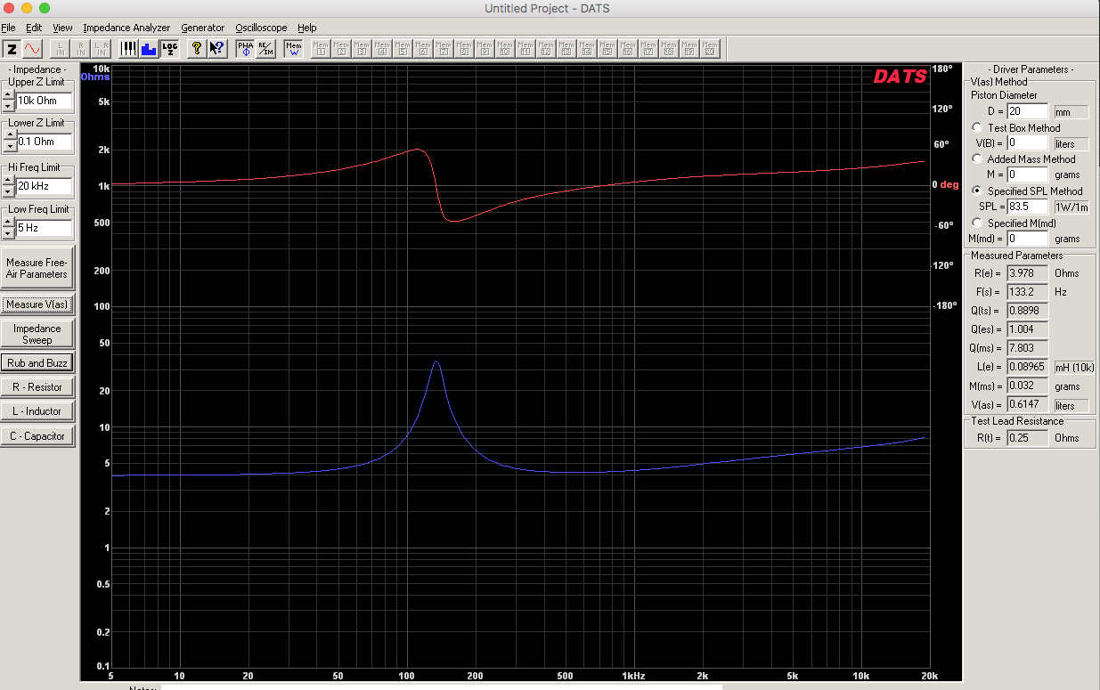

Only had time to put the drivers through DATS, and that's right out of the box. I will have to let them play a bit then measure again.
The good news is that impedance matches completely with online specs, but T/S are a little off... not that much, and might get closer to online specs after break in.

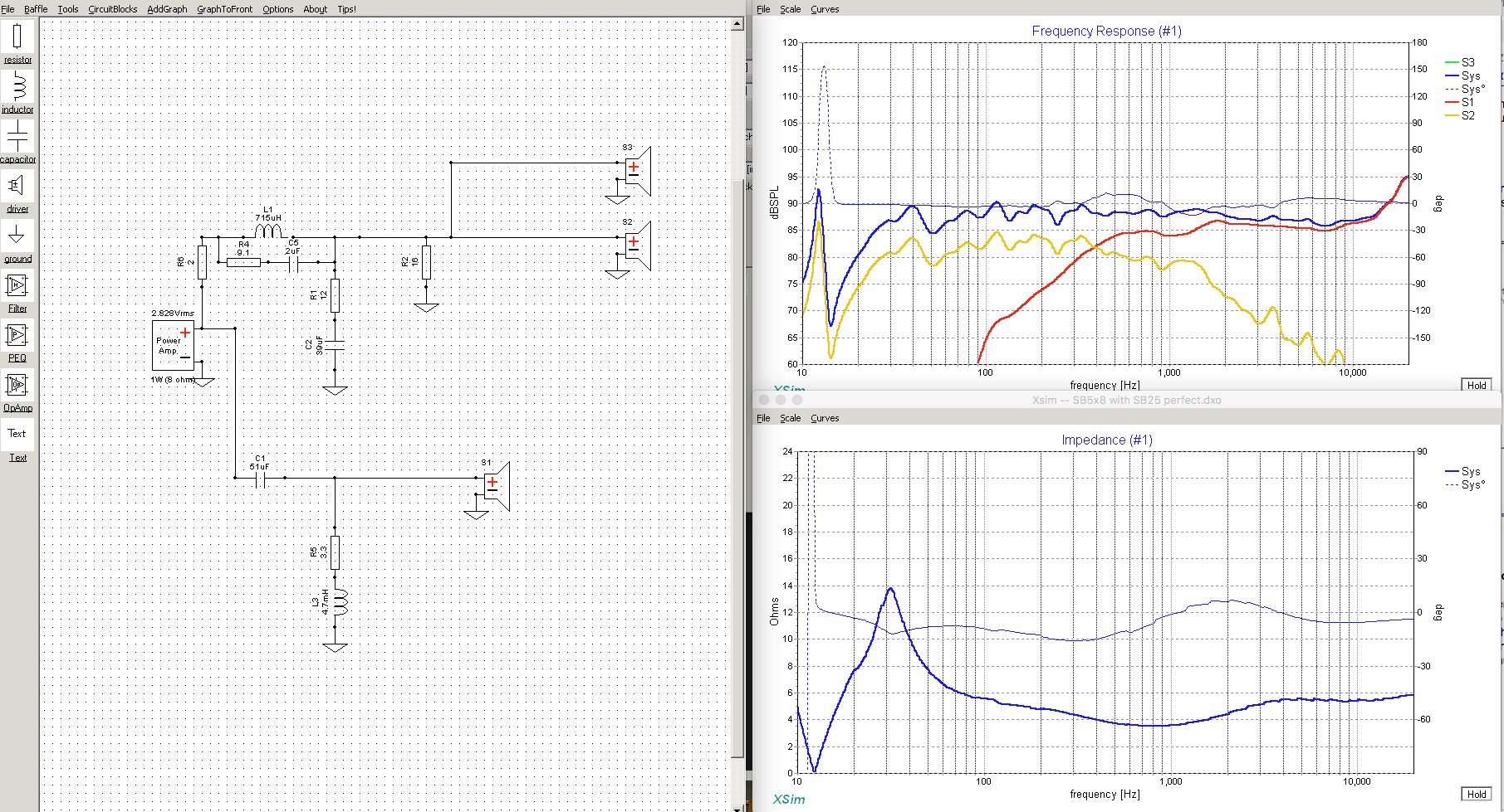

Didn't have time to get the parts for the more complicated XO, so I rigged this with 4.8mH and 3 Ohms on the woofer, and 52uF on the tweet.

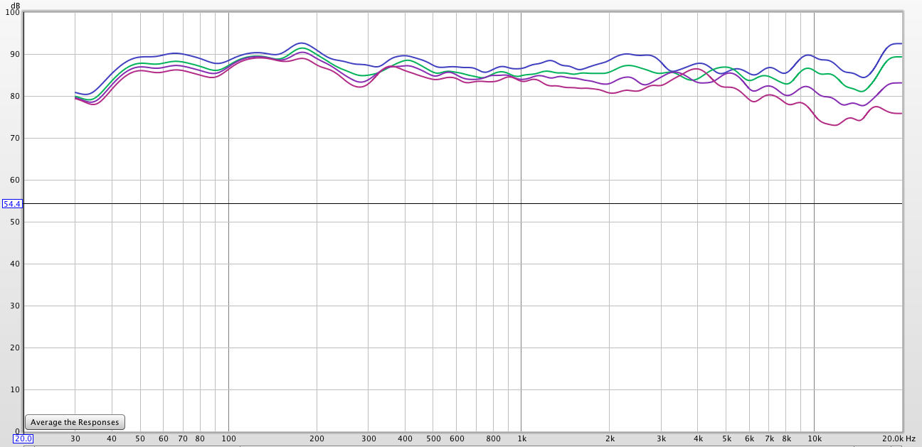

I was listening to them this morning, and I just couldn't wait to get initial findings!
So, after only 8 hours break in, here's what it looks like.
X, yes, this is the simple 1st order XO with a 52uF cap and a 4.8mH inductor with 3 Ohms attenuation.
In order, first we have the horizontal measurements at 0, 15, 30 and 45 degrees.

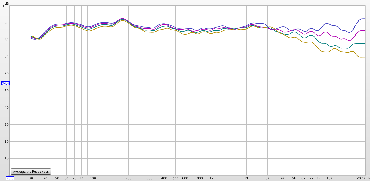

Then, it's the vertical measurements at 0, 15, 30 and 45 degrees.

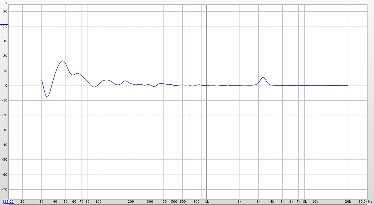

Group delay from a sealed box, so that's good enough.

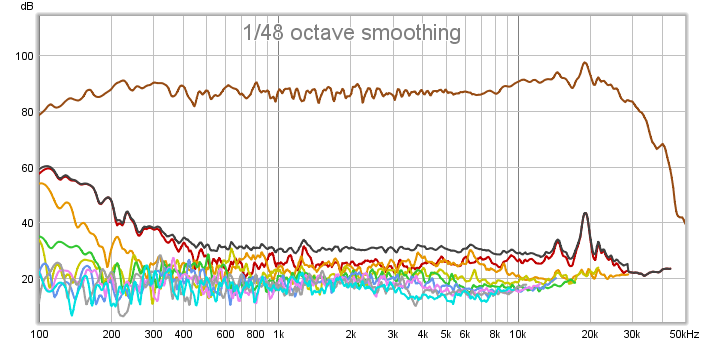

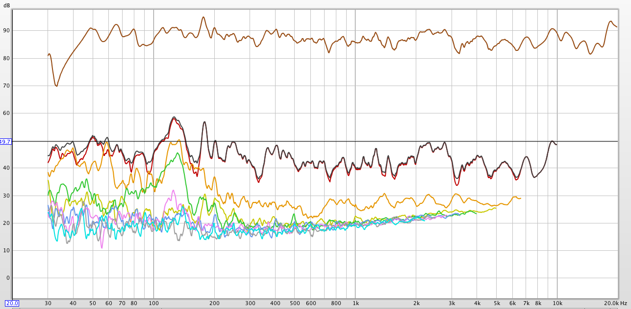

4th is the distortion. I was not expecting much... remember this is a XPS foam glued together in half a day, it's got some bracing but I think I can forget anything under 200Hz. 1st and 2nd harmonics are 30 to 45dBs lower, and then a drop at the 3rd.

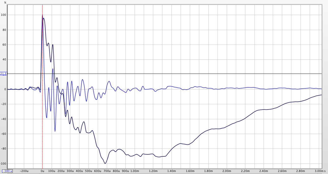

Finally, the impulse and Step. We can see the SB65 (inverted) arriving much ahead of the woofers. Surprisingly, there's quite a lot of small wobbles from the SB65 all the way to 1ms.
