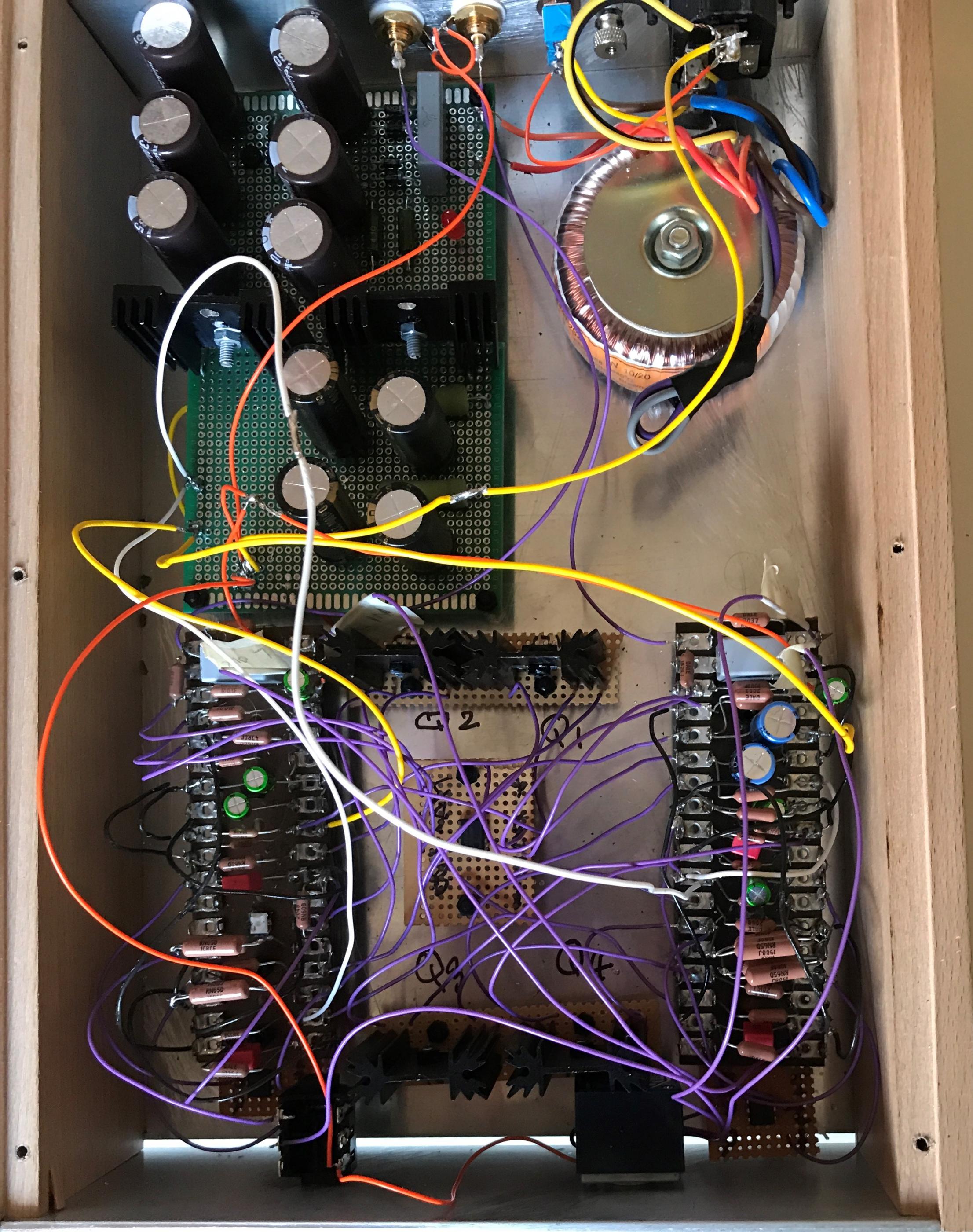

Not sure if this is the right place as i am new to this forum, i have just completed build of whammy by hardwiring, and when hooked up with phones, sound is flat, low volume, muddy and just nor what it should be. Phones are Hifiman 400i, which can be driven reasonable well with another, less powerful headphone amp i have
Obviously there is a problem somewhere.
The signal is coming through ok, and the background is absolutely dead quite, so earthing would not appear to be the problem.
I have checked the wiring many times, re-soldered all joints, replaced the opamp and mosfets (and put on separate board).
The power supply seems ok, +17v and -17v (leds), and on no load the will sit for hours without any heat, when i connect the circuit the voltage regulators will heat up slowly until sinks are very hot (too hot in my opinion), yet the mosfets are barley warm.
I have built a number of tube amps in the past without problem, but frustrated i cant seem to find the problem with this.
Any help would be greatly appreciated.

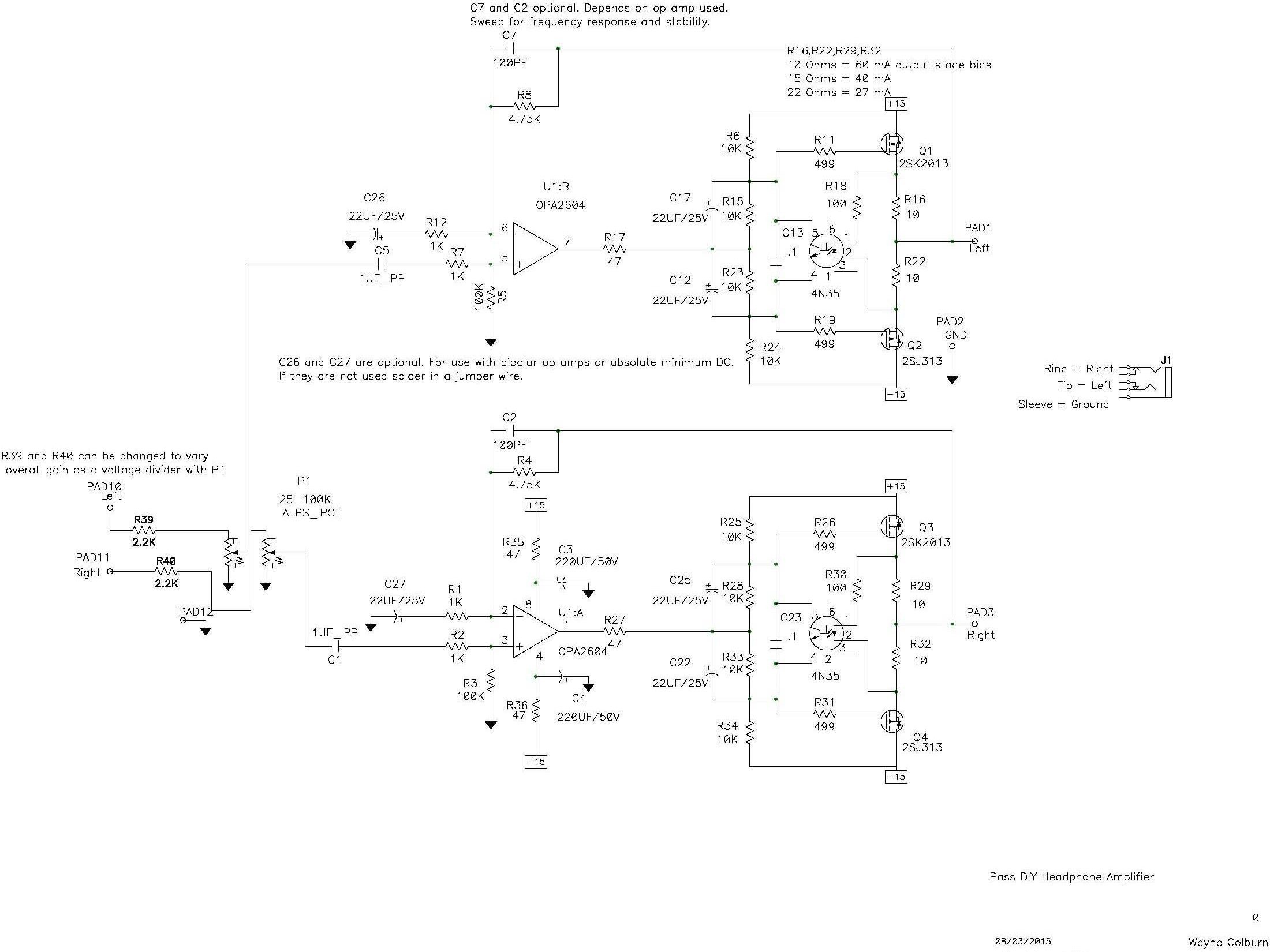

I have attached photo but you wont see much from that due to the hard wiring, the schematic is the standard, i have not changed in any way.
Assuming the wiring is correct and no bad joints, what would cause such symptoms

Have you checked bias current by measure voltage over the 10 ohm source resistors?
DC voltage should be about 0.6V for 60mA bias?

Then you can also check if the opamp gives the expected voltage gain?
Is it x4 or x5 .....something like this I think?

Since you have correct bias you should maybe concentrate on the op-amp circuit. It is this circuit that makes the voltage gain. So at op-amp output you should have x4-x5 gain compared to the op-amp input. Can you measure these two signal levels?
