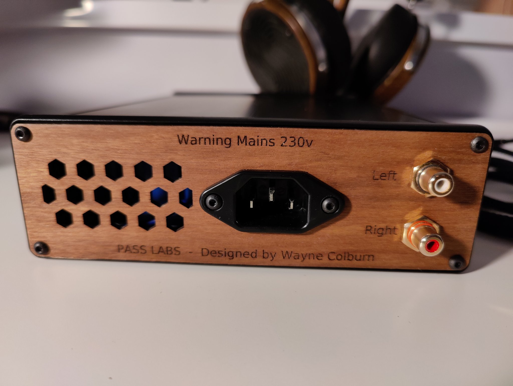

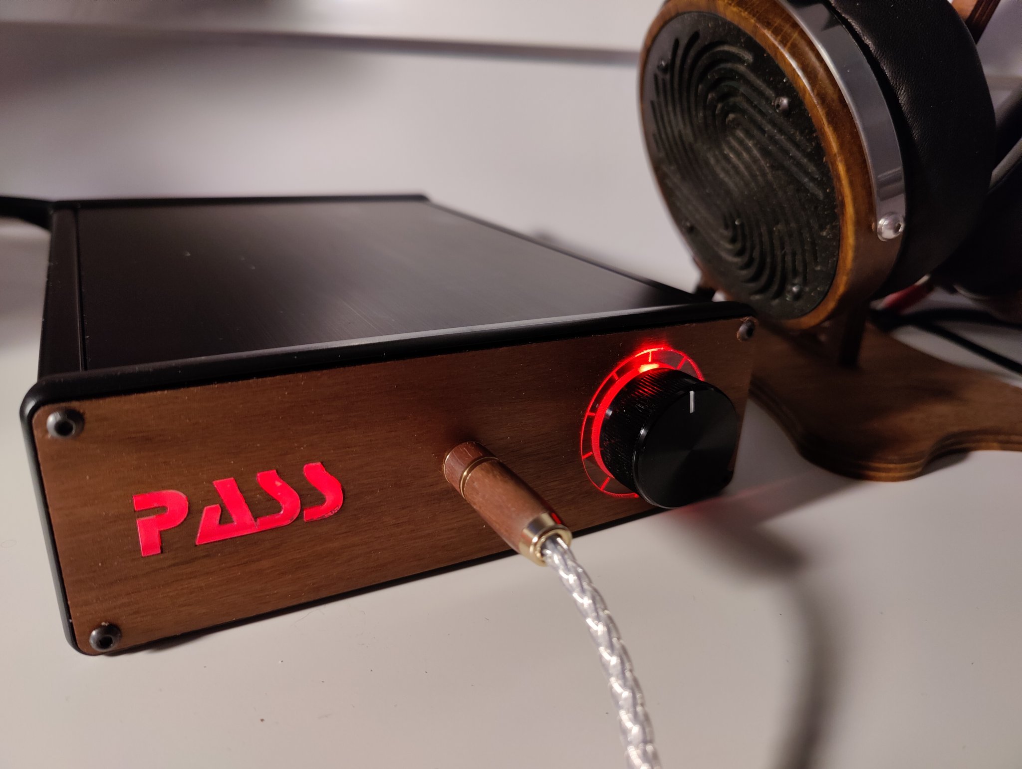

WE
Sounded awesome outside the case, but we will see what it now sound like later today.
This was so much fun to build, but I underestimated how much work with all the modifications
Have a pair of LM833 per 6L6's writeup in there for now and test others later.
I have s Preamp switch and a switch for balanced/unbalanced headphones.
Also, have adjustable gain installed to r12.
Do not have the 100ohm resistors on the preamp lines yet 🙁
Had to DIY the milling, learning as I went along, 😉
Cable tidy-up is also needed.
Will add MUSES volume with OLED display when parts become available and KHADAS DAC after.
Would have been lost without all the forum contributions, so thanks for all the help from as usual Wayne, 6L6, avdesignguru to name a few.

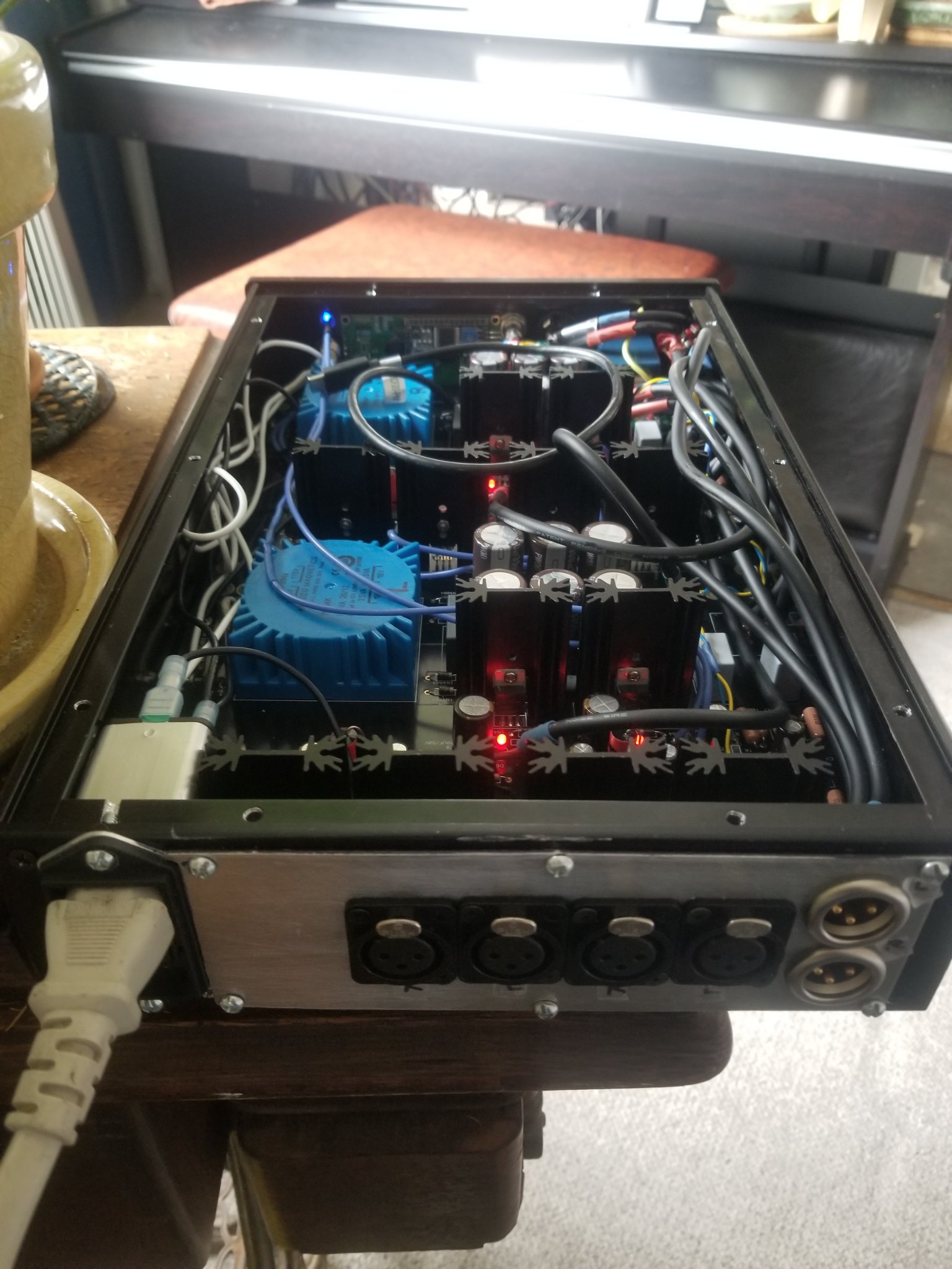

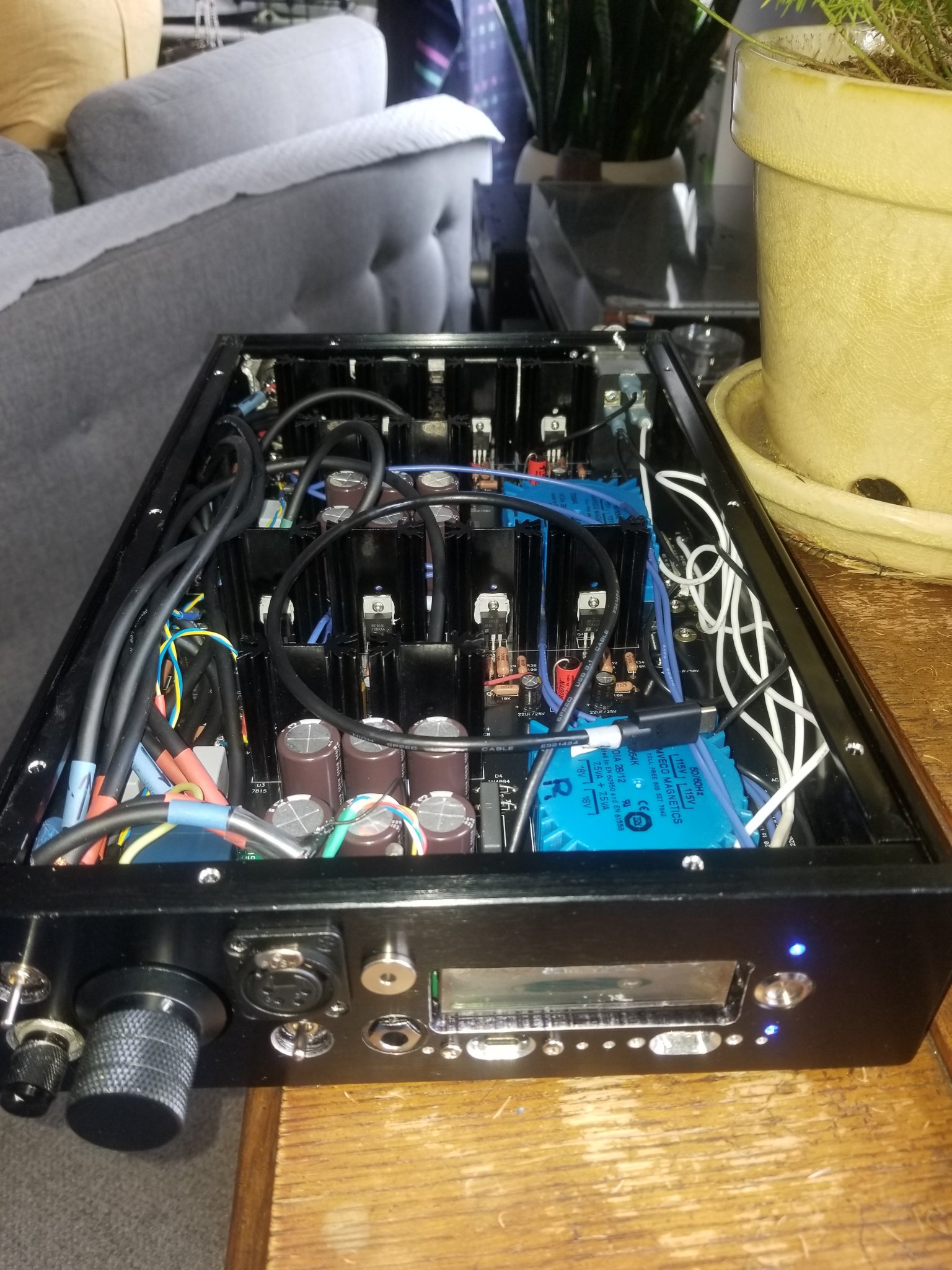

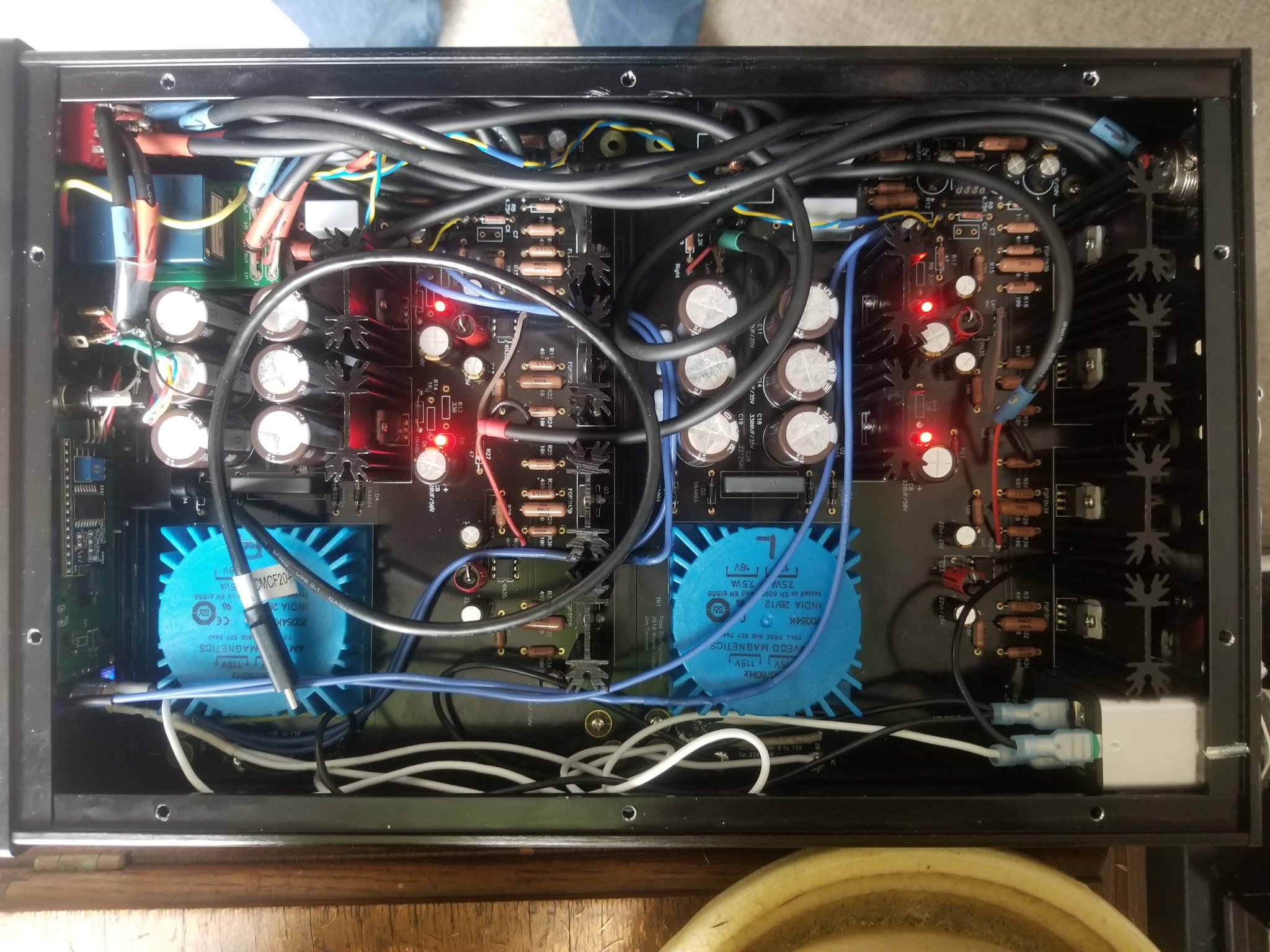

It is alive... no smoke so far.Progress on my balanced Whammy
Here is the progress on my Balanced Whammy.
Decided to try this just for the fun of it.
Have some optimistic plans for the build based on ideas from this thread.
Khadas DAC
Muses Volume
OLED display
The case is tighter than I expected so will have to see.
Anyway, hope to test for sound this weekend.
Any comments and suggestions are welcome.
