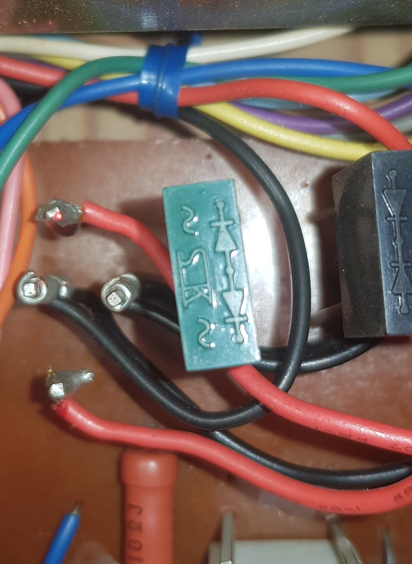

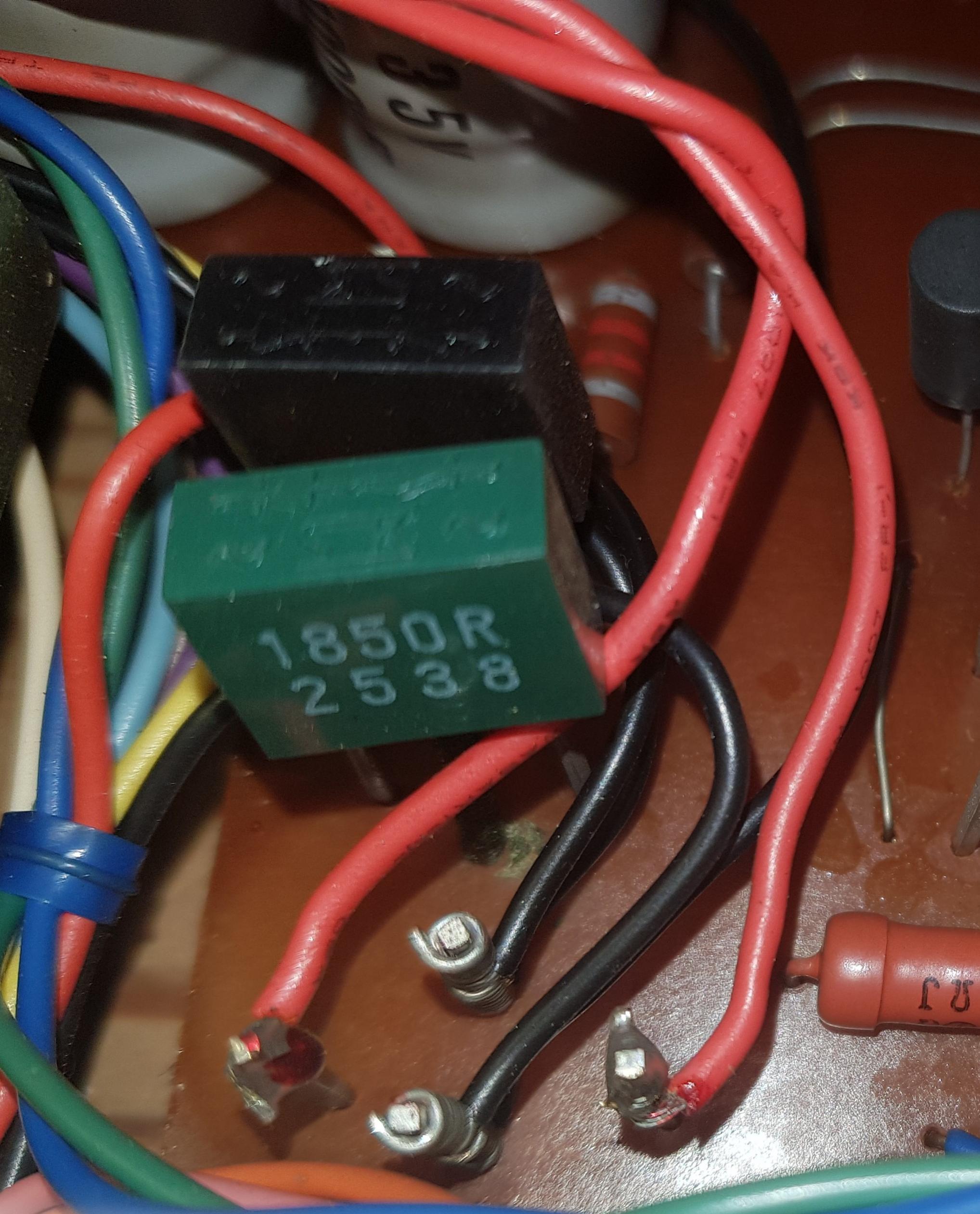

Can anyone identify this component from the mono only amp which has been worked on by someone before and been removed (images attached)?

IF they have connecting copper on the reverse of the PCB then they represent a full wave rectifier in unusual block plastic shape .
If NOT then they have another use --notice the AC symbols on the second photo.
The first photo looks like capacitors but could be something else .
60,s/70,s capacitors were usually encased in rectangular block plastic ( non-electrolytic ) they came in a wide dyed range of colors.
Duncan is correct in that the two double diodes may be connected together to form a bridge rectifier.
If so, they will also be connected to the secondary of the power transformer.

Two diode half-bridge (with a different direction of the diodes). It can be replaced by separate diodes. If switched on by a bridge, replace by a diode bridge in the corresponding connection.
