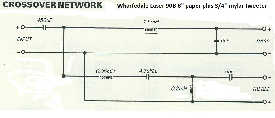

The LCR trap operates at 1.3kHz to be precise. I'm not sure it's actually doing much notching. What it does do is nicely damp the bass filter to avoid peakiness. It also damps the bass voice coil a little more than usual, which I think makes for the smooth sound.
One for the repertoire of filter techniques. You can actually get to much the same place with the more modern simple LC filter (which often needs a little shunt resistance R), used in the similar later Wharfedale Laser 90B. FWIW, the tweeter filter used there is much more like the famous old Celestion one. The tweeter was a particularly competent design which an ex-engineer here told us about a while back.
Maybe that Laser 90B is "The all too often seen filter" that Troels Gravesen has been known to rant about. It tends to bassiness and an edgy sound in the midrange in my experience. It's difficult to get everything right with only two variables to play with. The Shelton has more wiggle room. 😎
Thanks for your explanation Steve - the 'LCR trap' is therefore a 'contour network' which shapes the bass/midrange driver's response curve.

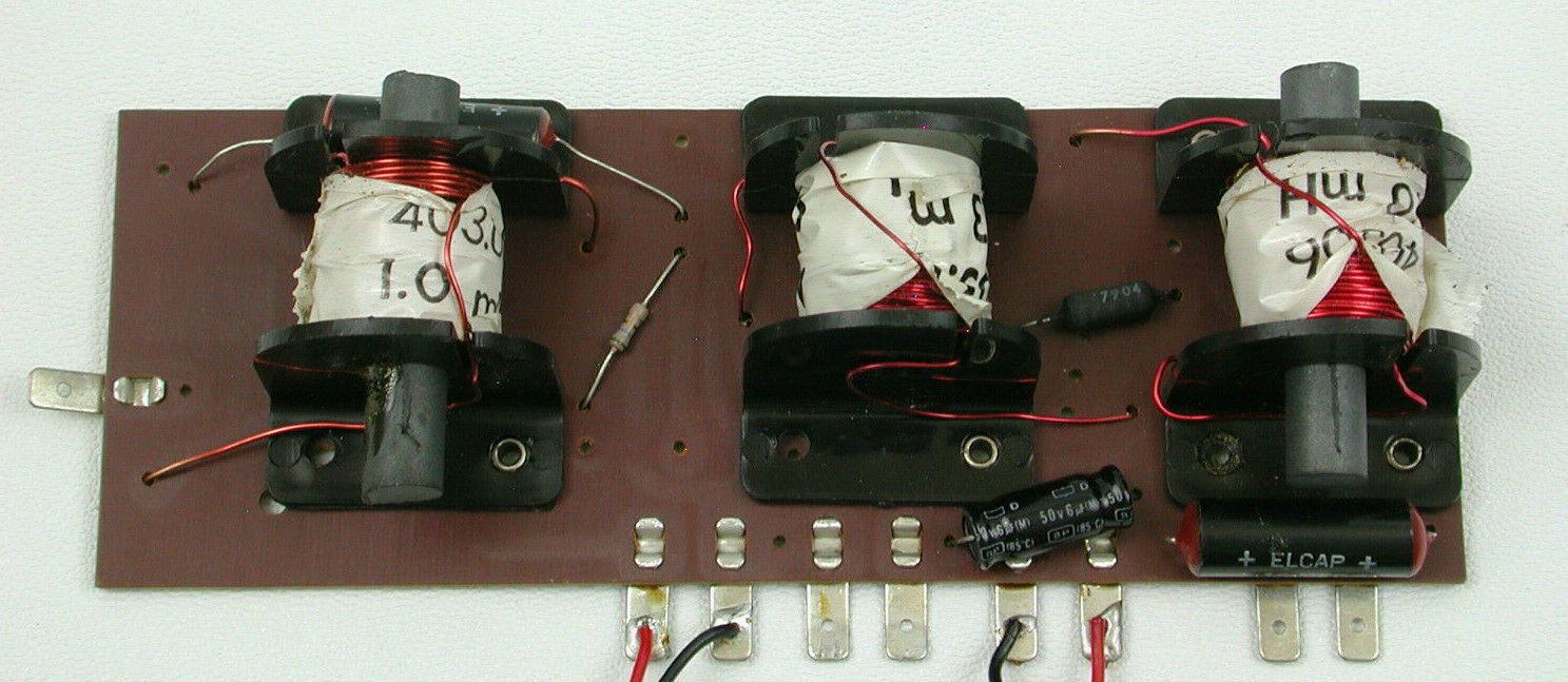

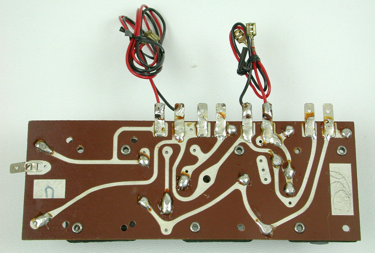

Steve, do you happen to have a schematic of the original Shelton XP2 crossover (not your modified version)? I see a couple of resistors in there.
I've attached clear photos of both the component and track sides of the crossover board. I see that one of the capacitors and one of the resistors has been changed on this one, but the crossover is complete.
The crossover frequency is said to be 3.5kHz.

Thanks Steve, that makes it all clear.
If we remove the 2.94 ohm, 10.9 ohm and 1.0 ohm resistors from your schematic, we arrive at the actual Shelton XP2 schematic as per the crossover board (but minus the mystery metal oxide resistor!). 😎
