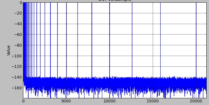

A quick exercise, 30 1/3 octave multitone with RIAA pre-emphasis. Run through SoX with a simple ~5000 point FIR RIAA de-emphasis. Let's put to bed the pro vs home software paradigm and any questions that digital RIAA taxes any limitations of the software. Vertical is dB, horizontal is linear frequency. BTW the accuracy is only around .0002dB across the band due in part to a little truncation of the impulse response.
EDIT-24 bit 96kHz TPDF dithered no noise shaping.
