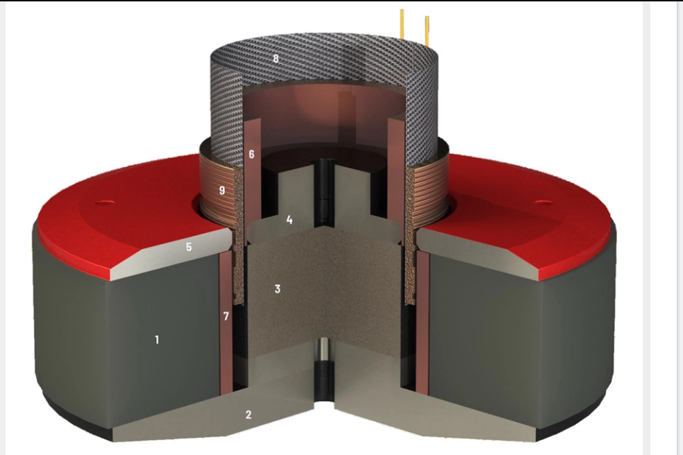

What can you see from the 2 copper sleeves?
There is a inverted, extended T-pole, encircled in a large copper sleeve (6), all the way down to (3).
Immediately below that, there is (3) a NdFeB magnet slug, as you saw in my previous post, it's magnetic permeability is close to air at 1,05.
And on the opposing side of where the NDfeb ends, you again see a full length copper sleeve (7).
Also do notice that the copper sleeves overlap from one side to the other.
So they have gone very far with 'inductance control', and "mimicing air core behavior" in the motor design.
On the very bottom of the gap below (3) there is again magnetic permeable material, but that is by design to let the field reduction and suspension parts, stop the coil from destroying itself on the backplate.
You should also note the voice coil wind is not of a "standard flat topology" with a even layup over the whole length.
I do not believe you can make a "air core" motor design with Ferrite magnets, but im not updated on magnet tech.
Børresen and Focal (mids) does it with Neo. As close to a air core as is possible to get with todays tech.

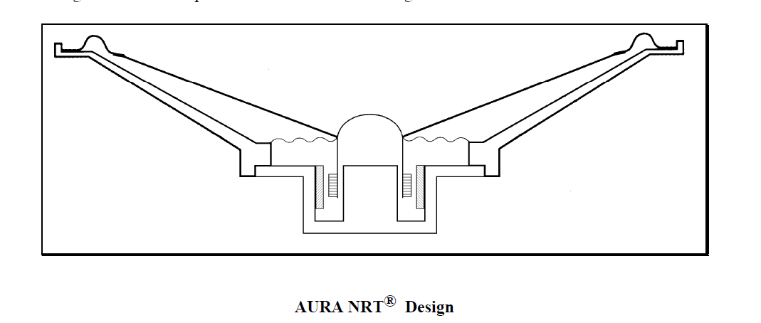

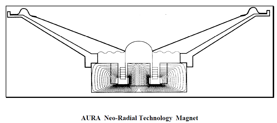

You will find the Aurasound whiepaper, and the Super Flux Magnet document added explaining in more detail.Also Aurasound neo radial technology, NRT, needs discussion too, it has neodymium magnets next to the coil on both sides, many problems being discussed about FE and Alnico would simply not be there with NRT.

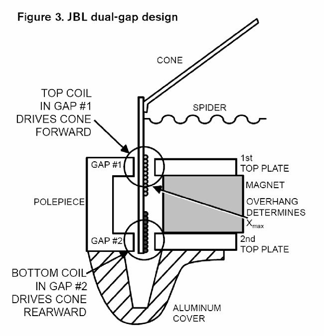

JBL DD has barely been touched upon.
There are version with shorted turns.
patents for copper cap/sleeves and demodulation rings.

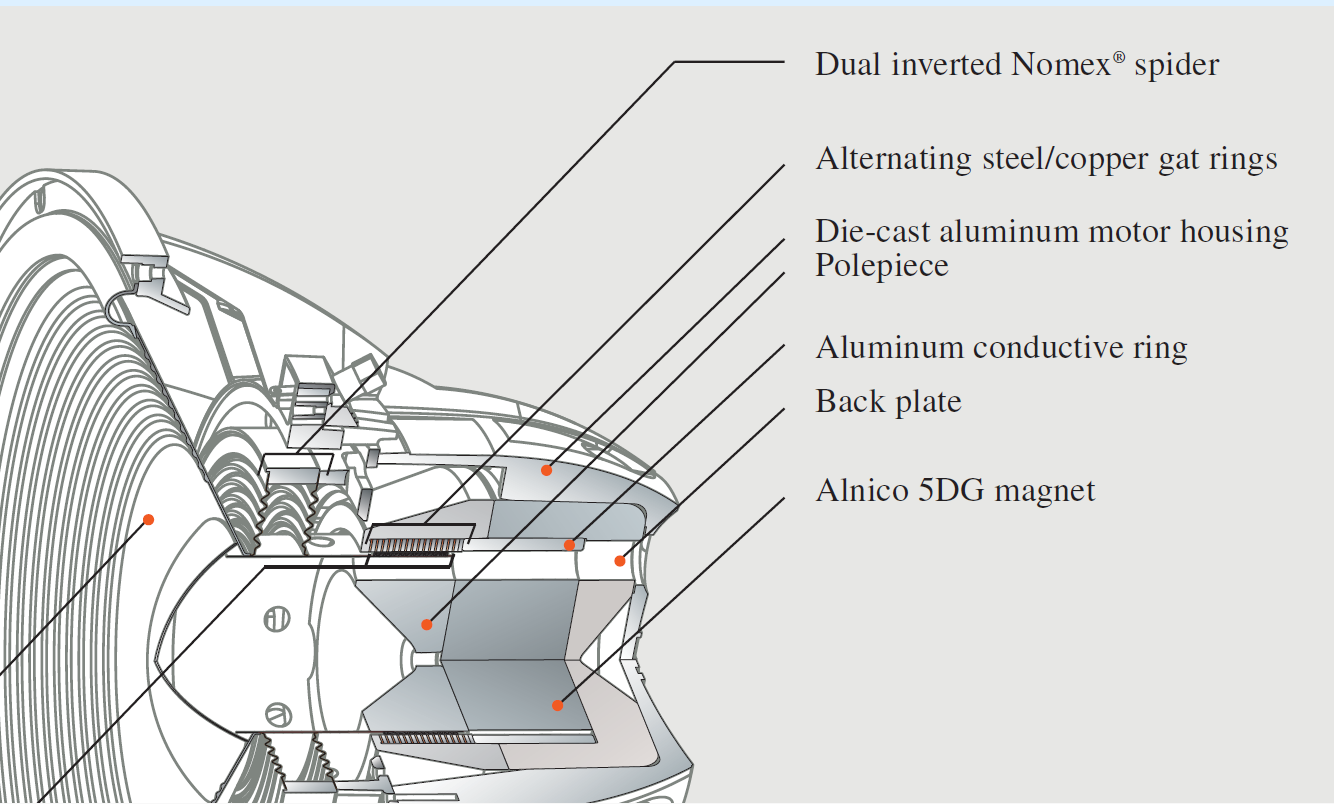

And last but not least the 1500AL/1501AL top of the line, underhung Alnico drivers.

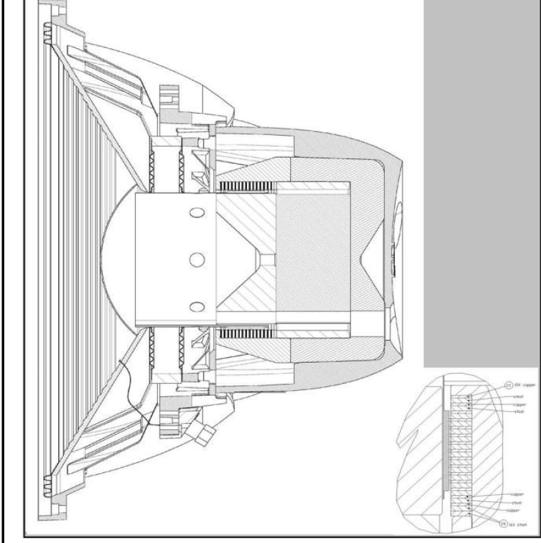

Do notice the alternating copper/steel gap rings.
Also take notice of the magnet, it is internal where the pole piece would normally sit.
Those 2 features again makes the driver close to a "air core" Alnico 5 has a permeability around 2, just with a internal magnet on the inside of the coil, utilizing the basket as demodulation and heat conduction. And they largely designed away the Alnico heat related demag issues in the same time.
Also look at the magnetic circuit and see how much copper the path has to go through.. There is a reason it is expensive and have such a insane magnet strength, with a fairly normal gap density.

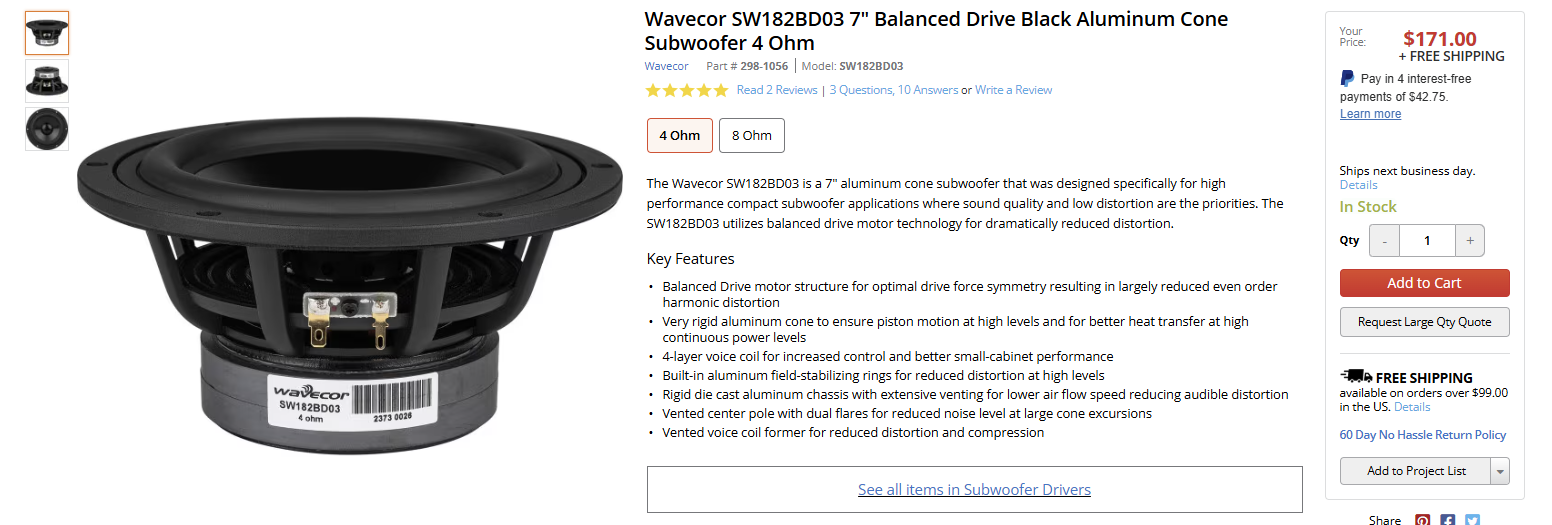

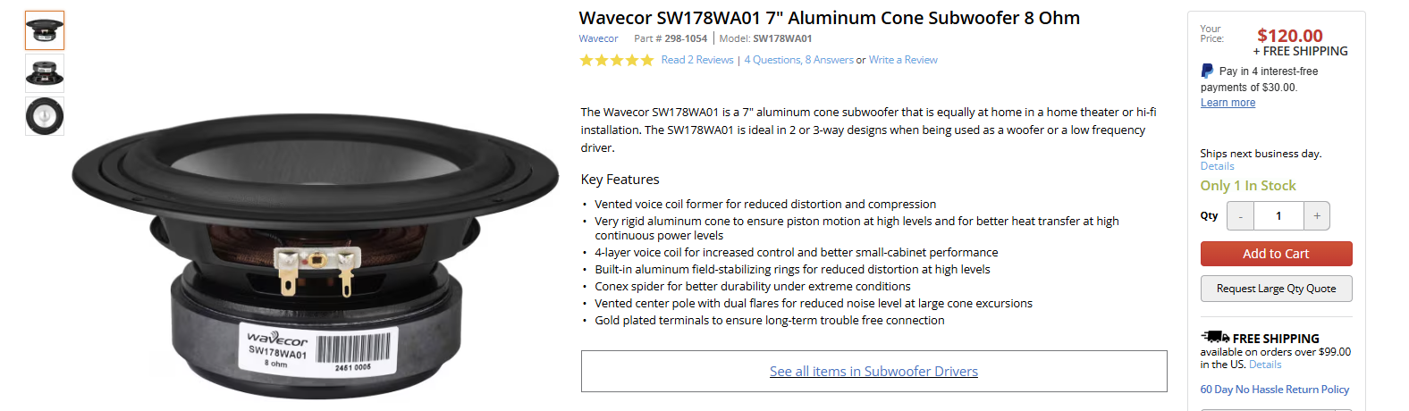

I forgot but from what i have seen of Wavecore, mostly measurements that is. Just the WF midwoofers, and the new carbon/kevlar woven cones really.This Wavecor has a regular drive and is $120
For $51 more you can get a symmetrical drive.
Clearly this isn't a one to one. But I am wondering how much more you get. Is it a huge difference? Or is it just a "nice to have"

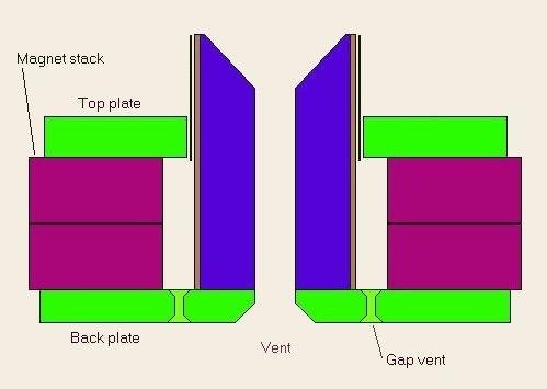

And a "normal motor with a core.

I wonder how Wavecor is doing it then considering most of their lineup subsists of Subwoofers.Due to the lack of mechanical brake, we do not recommend the use of Kapton drivers as bass driver, because if the x-max is exceeded there is nothing to prevent the driver from bottoming out. For sub woofer applications, please use drivers with aluminum voice coil formers.
This is why I find them so interesting. The few reviews I could find praise their dynamics. They measure decent, but we all know that isn't the whole story.
All this is driven by a 65 mm diameter (2.5”) voice coil wound with round wire on a black fiber glass non-conducting former.I wonder how Wavecor is doing it then considering most of their lineup subsists of Subwoofers.

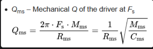

I am just starting to understand Q factors and how they relate to tone and dynamics.
Qms = Res / (BL2 * Cms * 6.283 * Fs)

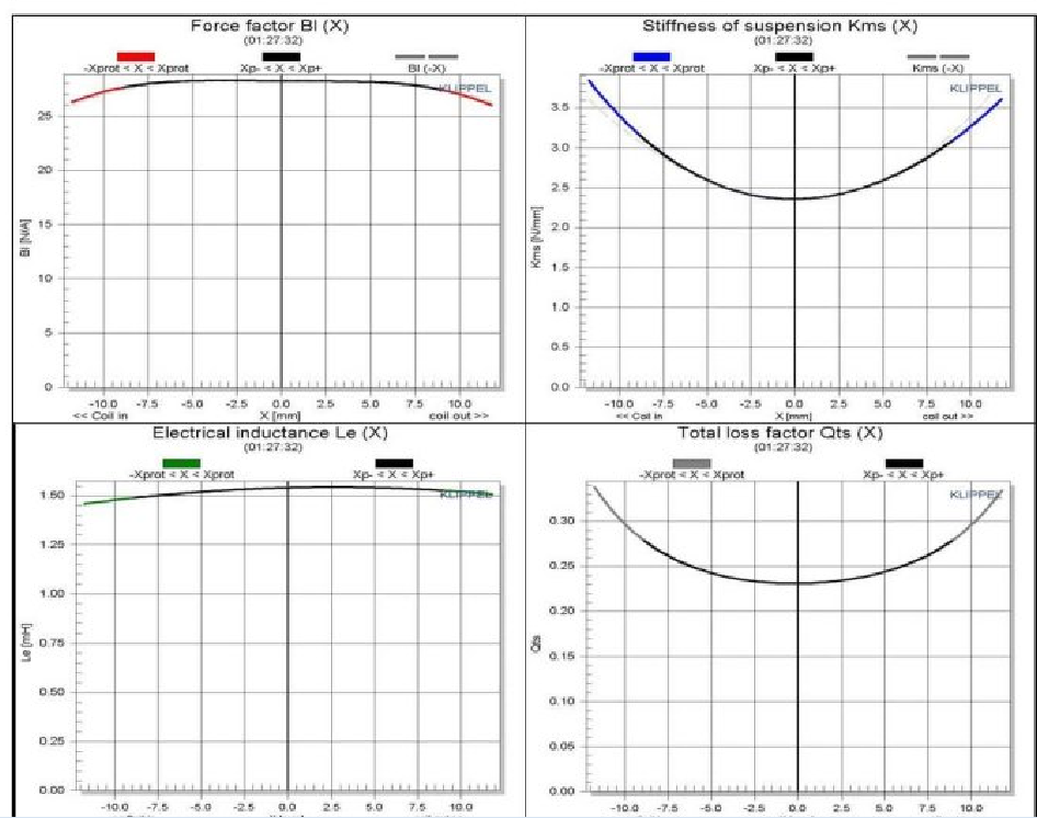

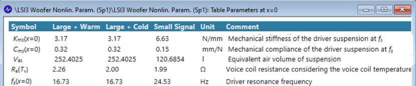

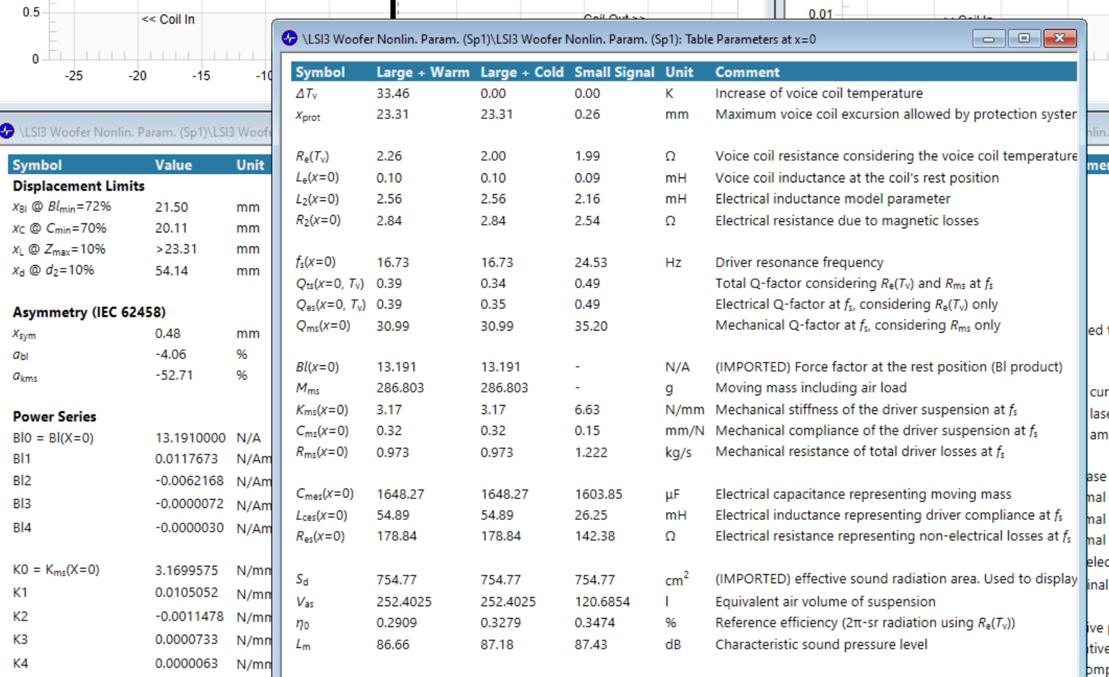

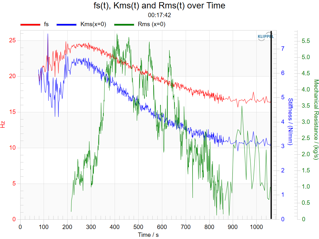

Here is one of my subwoofers with a titanium former and over 30 qms. 20mm one way linear xmax.

The klippel parameters I showed is my subwoofer with a titanium former, I would like someone to find a subwoofer that uses a kapton/fiberglass former that has a qms over 30.
Aluminum has a thernal conductivity of 210 W/m-K, titanium is only 17 W/m-K. They use titanium as heat shields in aerospace.
Even though it has a ~3% IACS electrical conductivity (compared to Aluminum's 61%), it is low enough that it does not even yield a qms difference vs. kapton/fiberglass.

20mm Xmax for a ~12" subwoofer is impressive!Here is one of my subwoofers with a titanium former and over 30 qms. 20mm one way linear xmax.
Interesting to see the small/large signal changes, thanks for sharing them.
I'm curious why the large signal Kms is ~half of the small signal value, Cms and Vas ~double.
The Fs drops almost 1/3 octave, from 24.5Hz (small) to 16.73Hz (large).
What is the voltage for the small signal compared to the large?
Are those small/large signal parameter changes typical and unreported for high excursion subwoofers, or more specific to your driver, and if specific to your driver, what causes the changes?
Thanks,
Art
I'm not an expert in motors, but I will say I tend to be a big fan of composite cones and in that sense the Revelators have not disappointed me. Glad to know the Dayton subs are so well thought of as I have a stack of them in my living room which I hope to use next. 🙂
That is actually a 15" subwoofer. Yes, it is common to see that kind of variation on subwoofers with large rubber surrounds. Foam, not as drastic, but it will still change noticeably. The properties of rubber change more with temperature/movement. I have never actually tested any driver from 2" mids up to 18" subwoofers that did not show a deviation between large/cold and small signal suspension parameters. Large/cold is usually the best match to real world conditions for box design.
Very large rubber surround, interesting to see the changes over ~15minutes, especially the mechanical resistance up/down fluctuations.That is actually a 15" subwoofer. Yes, it is common to see that kind of variation on subwoofers with large rubber surrounds.
What voltage on the "over time" test?
And what were the voltages used for the small signal compared to the large signal T.S. measurements?Large/cold is usually the best match to real world conditions for box design.
I wouldn't call it very large, this particular one is just a 1" roll, slightly smaller than what you'd see on an Ultimax.
Looks like LPM small signal voltage was .05, I always start my LSI runs for subwoofers at 1v, and peak voltage for the run was 20.5.
