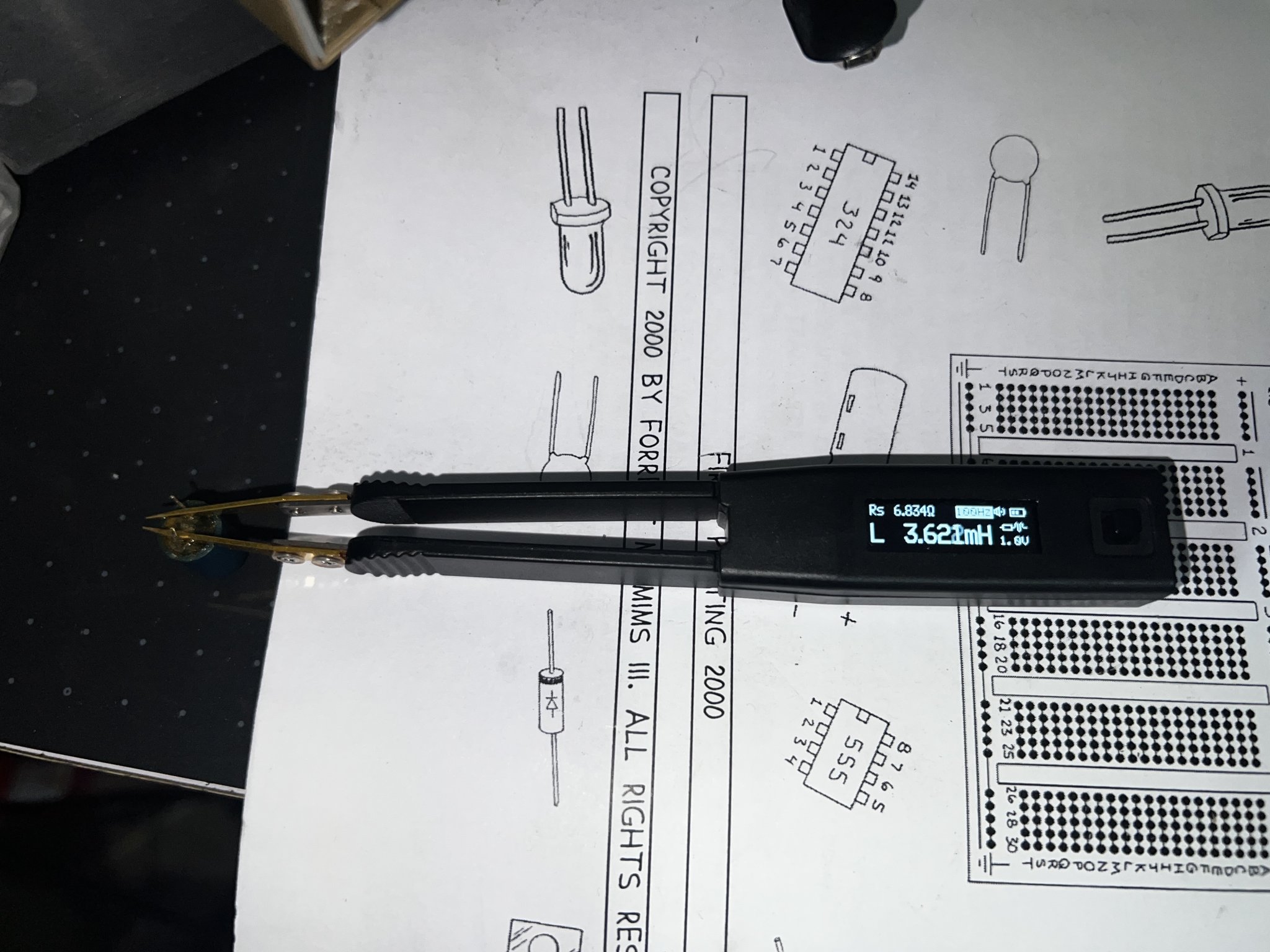

I just wanted to say thank you for your response earlier. I really appreciate your help. I've been searching for an equivalent link, but I haven't been able to find one. Do you happen to know of any resources that could help me out? Thanks again!Inductor/RF choke
3.9uH
100ma
10 ohms
SRF 680kHz
Google, Octopart, whatever will get you close, and then start reading the datasheets.I just wanted to say thank you for your response earlier. I really appreciate your help. I've been searching for an equivalent link, but I haven't been able to find one. Do you happen to know of any resources that could help me out? Thanks again!
Dan
Why?
You measured it & it's within specs.
Are you building a duplicate circuit?
The circuit board is in very bad condition, and it has three inductors; one of these is faulty. I plan to rebuild it with a new PCB, but I want to test it before the rebuild.
I appreciate your help 🙏Fastron 09P-392J-50
Maybe one of these would do...
https://www.mouser.com/ProductDetail/Coilcraft/RFC0807B-395KE?qs=ZYnrCdKdyecTCAPK1PxSOA==
