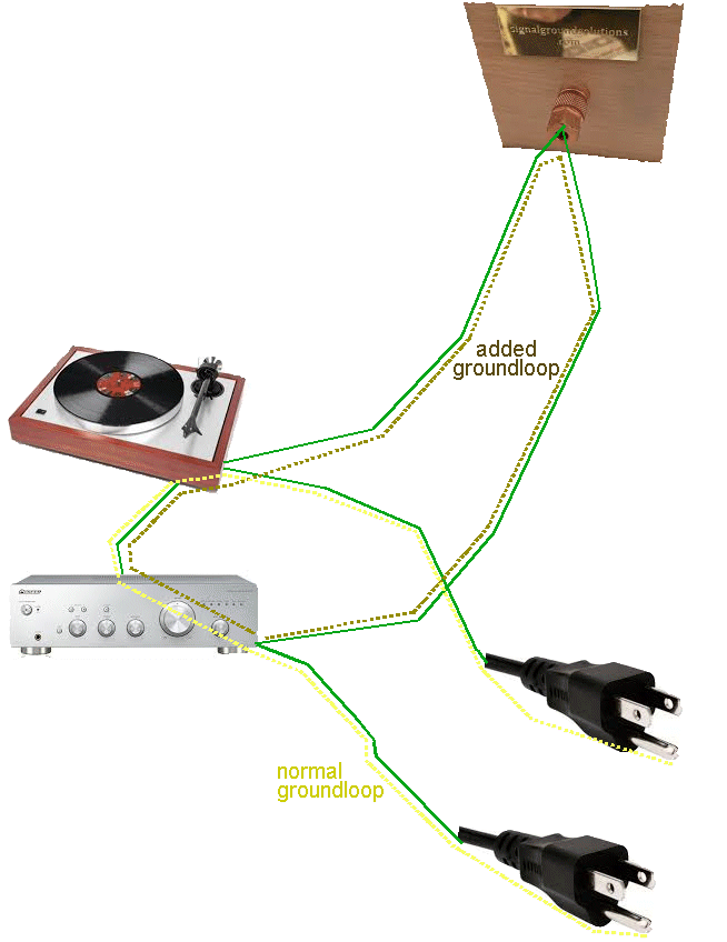

Depending how it is wired, it can add an AC/RF-catching loop in the audio system common. See image. Some details skimped (the turntable may have separate chassis and needle commons). And this objection would be reduced with a single conductor to the "ground box", reducing the LF loop to an RD-only monopole.

The ground box does not create the loop; it is the wiring to it which creates the loop. The loop would still be present if the box disappeared but left its wiring behind.PRR said:Depending how it is wired, it can add an AC/RF-catching loop in the audio system common. See image.
Adding a 'ground box' to an existing system does not create a loop. This is because the 'ground box' is not a ground, but merely an isolated box of dirt with a wire coming out. So you either have a ground loop (via the mains) or you don't; the 'ground box' makes no difference.
Then you have not examined what goes into a ground box. It is basically a large metal spur to which all devices chassis get connected. The RF absorbing "dirt" is secondary. Depending on the grounding arrangements of each individual device you can have all sorts of unpredictable outcomes.
Perhaps all the RF is gathered in one place by the box so that it is more capable of making the final leap to Earth without getting lost on the way?
As I said, the ground box does not create a loop. People may make loops out of the wires connected to it.
