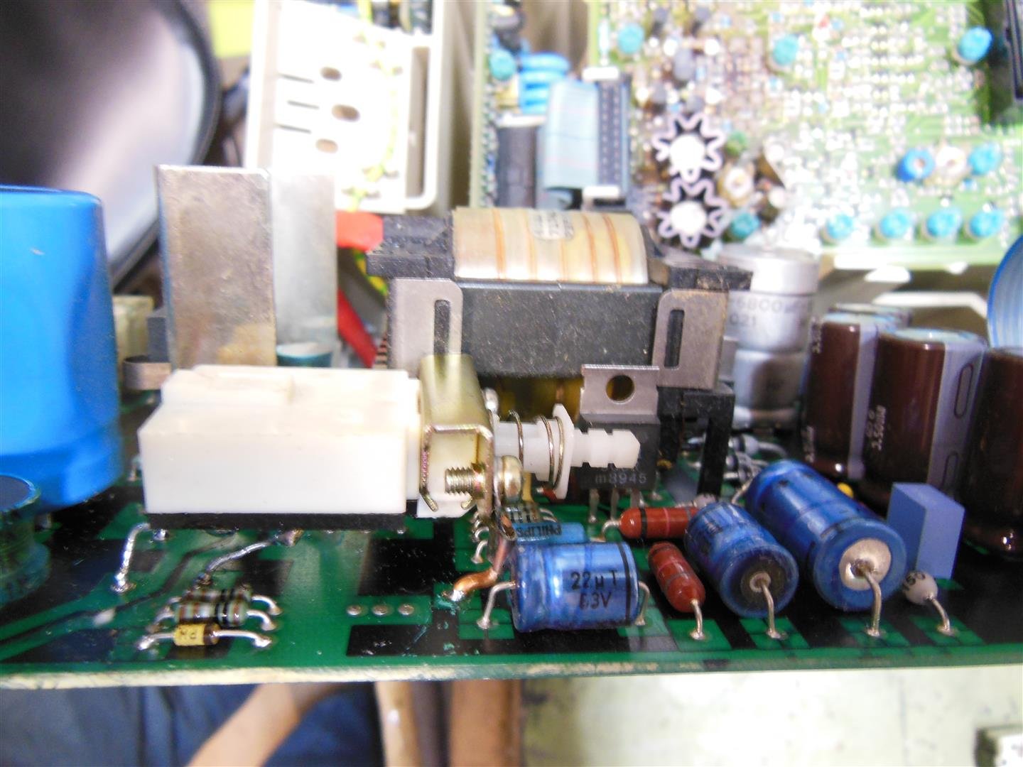

They could have used a standard switch - but no. Looks like they cleared out stock as this one has three poles, one ahead of the rear DPST section. I modified a normal DPST type rated at 5 amperes. It isn't pretty, but it is solid. I used ground lugs to solder wire onto, the screw onto the mounting plate. Every distance, every conductor location was different. I'm not really proud of this, but as everything is falling apart anyway it needed to be solid and reliable, That's it.
The angles aren't great, but there is clearance between conductors and other components. The new switch touches the switching transformer - it just fits. The front support wires had to be ground down to fit the holes in the PCB, they were solid 14 ga. The lugs have SEMS screws and Locktite to keep them in place.

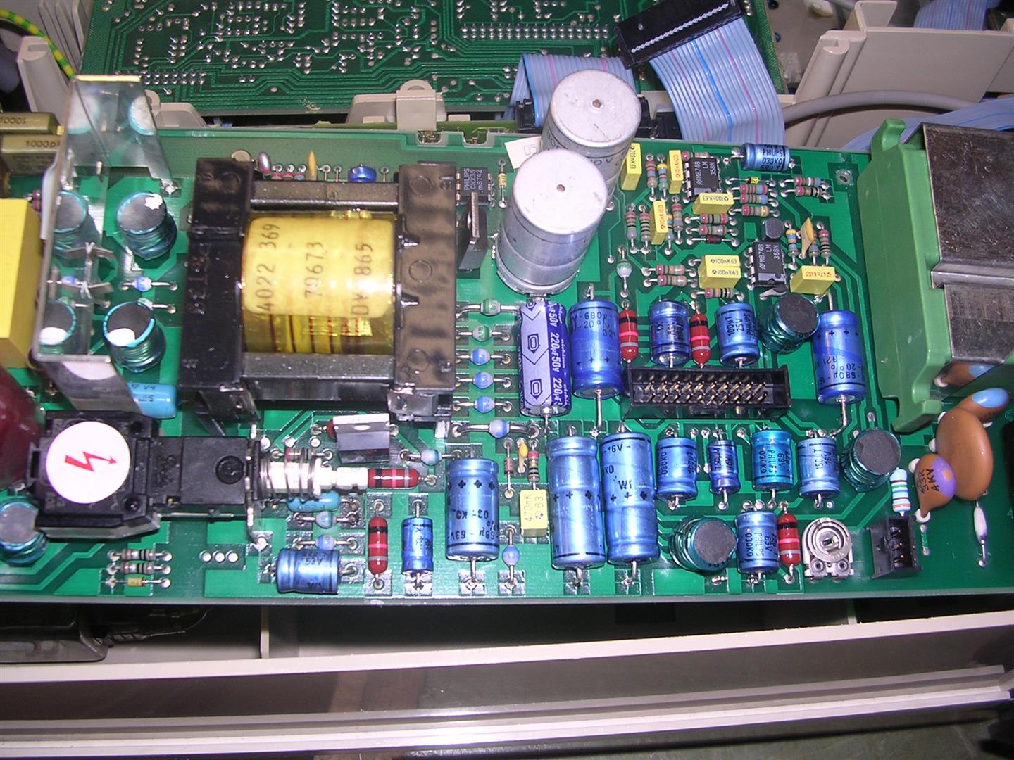

It is full of Philips capacitors (of course) and I expect to replace those also. There is one PCB where it runs way too hot, and has been replaced three times already. They offered a replacement scope, newer. I wouldn't touch it as the exhaust air was almost 20 °C hotter than the inlet temp. Upon opening it there was one huge chip that was far too hot to touch. They could have used a heat sink but elected to shorten it's life. I passed.

I think you may be right. Going off memory. Both those brands are garbage as far as I'm concerned. I hate seeing them in equipment. The fact remains, the really cheap power switch failed mechanically, it never got abused. It was a non-standard layout. Why they didn't use standard parts escapes me since it creates just another skew. It increases service costs and when they can't get the part the unit is not repairable (which may be the point). From a service standpoint, Philips were nasty to their customers. Cheap unobtainium with very low spares inventory. Now there is a company that richly deserves to be completely out of business.
