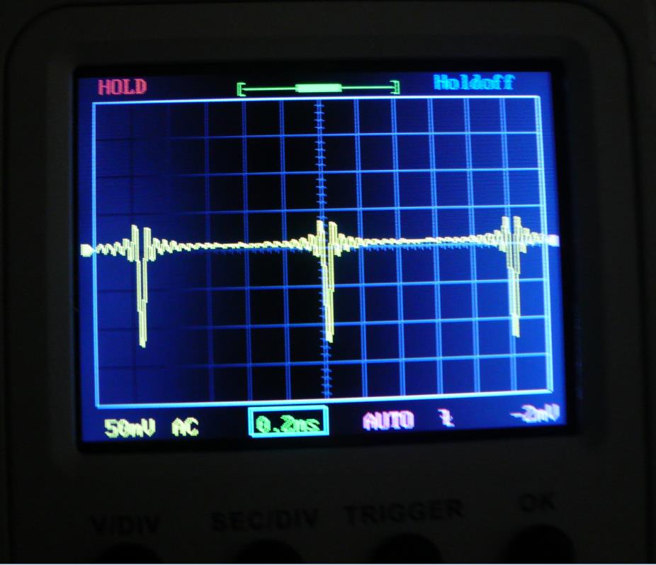

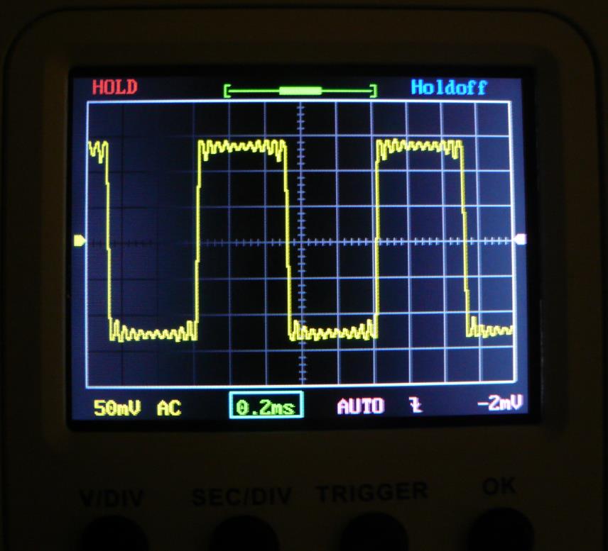

Track #2 is full scale ~1kHz square wave, Track #4 is ~1kHz one sample period width pulse train, Track #5 is 22.05 kHz full scale square wave. On a NOS DAC without an analog filter the signals are perfect square waves or pulses, no ringing or rounded edges. (Full scale is incompatible with ringing, it causes clipping in most OS).

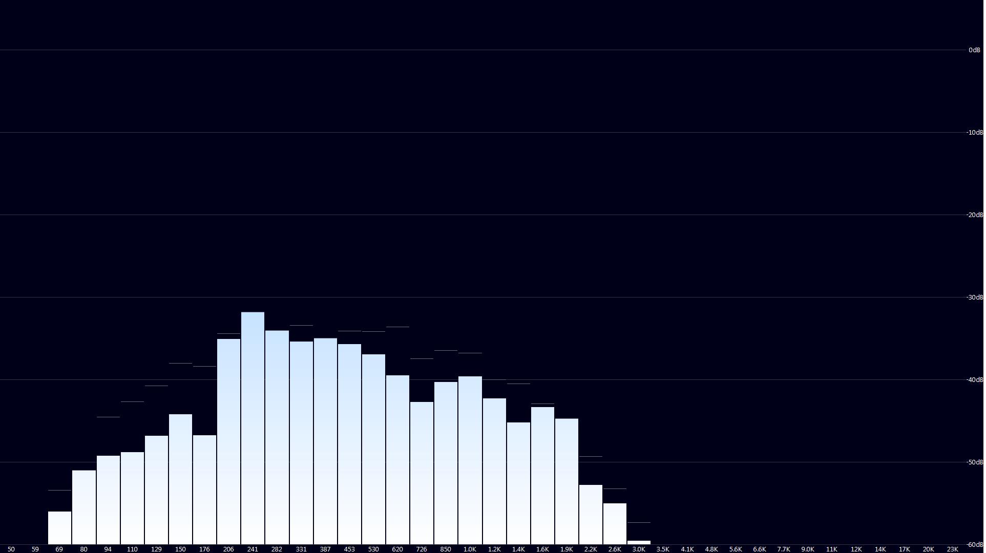

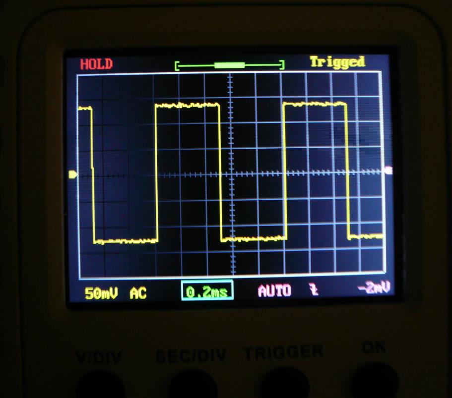

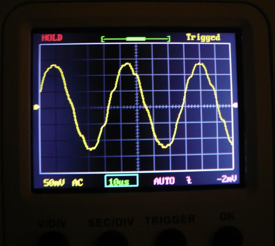

NOSvsOS measurements
@Icsaszar's test file tracks #2, #4 and #5 NOS/OS pairs. Also tried @MarcelVG's intersample overshoot test. I get clipping only with OS mode regardless the settings of the digital volume control... BTW I'm using the digital volume control in my main system. Yes, I've read the backround theory of this and I aimed for a gain structure that allows to keep the volume within the upper 1/3 of its range. I don't feel I'm loosing anything.
Last, I used Alan Parson and Stephen Court-Sound Check CD track #6 "Low Mid Band 200Hz-1kHz and Phase Check". Attached how it seems on Foobar and in FFT -OS is green. Not sure if the particular is audible but it demonstrates what I was thinking about possible images projecting below the Nyquist frequency into the audio band.
Listening impression tomorrow evening...

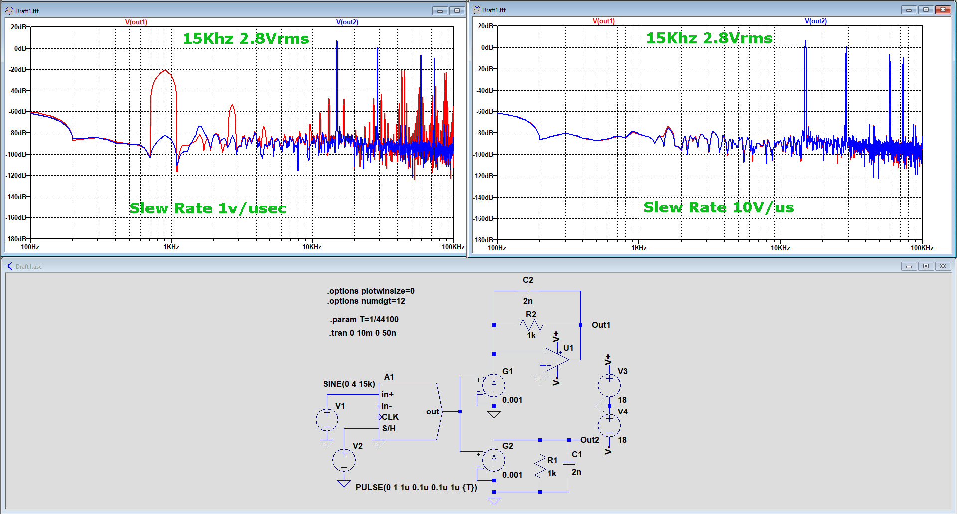

Here is the result of a simple but meaningful simulation.
In this case assuming a D/A without any slew rate restriction working at 44.1Khz
Output is 2.8mArms, translating in this case into 2.8Vrms.
One side is fed into an active I/V converter and the other side into a passive RC network enabling to compare both.
The op-amp has a parametrized slew rate.
In the plots the red line is for active and blue for passive.
I have chosen a 15Khz input frequency, that may not be the most critical, but the effect of slew rate limit is well shown.
In the left plot slew rate was set at 1V/usec, resulting in large distortion products at 900Hz and so on .
In the right plot slew rate was set at 10V/usec, where all distortion seems to be gone and both active and passive produce the same spectrum.
When translating this into a 192Khz D/A, slew rate should be some 50V/usec.
But keep in mind that the D/A in this example had no slew rate restriction, which is besides truth.
So in fact, consider the slew rate limit shown here as the max combination for: D/A + Op-Amp or D/A alone in case of a passive I/V.
