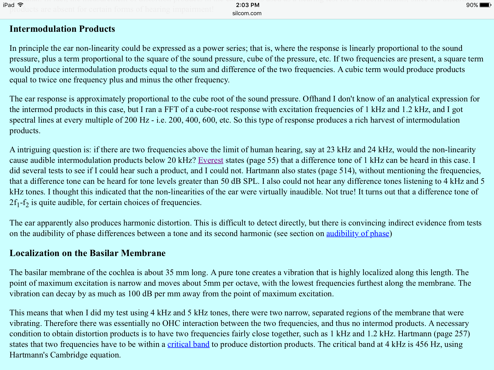

Suspect Item B4 update
B4) The unsuppressed image-bands are, somehow, producing audible IM products directly within the ear. The notion here is that although the ear filters ultrasonic signals, is may be possible for the the structure of the inner ear to inter-modulate them down to being audible.
I have small an update on item B4 of our suspect list. I did some searching, but found very little information. I only a couple of sentences in a study report, as shown in the 3rd paragraph of the attached screen photo. The report claims that a researcher, Everest, found that ultrasonic frequencies can produce audible intermodulation products. I searched for the Everest 3rd edition book cited in the report, but only found the 4th edition, which doesn't appear to contain the cited claim. The writer of the report further says that his own listening experiment of this supposed IMD mechanism were negative.
Whether this an audible mechanism or not, IMD seems highly unlikely to produce the pleasant sound character associated with NOS. Just the opposite. In addition, analog filtered image-band DACs appear to retain the classic NOS character.

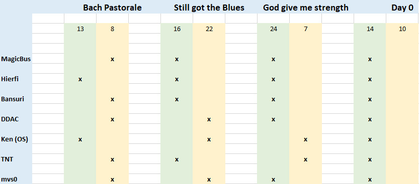

Here are the results that came out of the PGGB test.
It was a great experience to have this support from Zaphod using his extremely interesting Remastro software for this test.
The outcome is rather strange on one item.
As already mentioned, there was a file that was recorded directly from LP, Day0 from Harry Belafonte.
This file was 100% correct for all of the 7 contenders.
I'm a bit puzzled how this was possible, so let's exclude this one.
Looking at the 3 other official 44.1/16 files, out of the 21 choices 47% where wrong, giving a result that is statistically insignificant.
My feeling therefore is that processing 44.1/16 as a reason why NOS sounds different cannot be seen as a major cause.
I have now included the link to the 88.2/24 file. It would be very interesting to hear from you whether this can be regarded as an improvement on the original 44.1/16 files.

Thanks Hans,
How do we interpret the table? I only told you what I liked best and now I see results like wrong and right? So does that mean, when I liked an unprocessed track it is green? and when I liked a processed track it is yellow?
and what about the others, did they claim what was best or did they try to guess what was processed? So when someone called a track as processed it was green but we do not know if they liked it or not?
no problem, but just want to make sure - arghh 😀 we should have agreed upfront on response options
Because there is no right or wrong for me. If this software does something with the track that makes it sound better, I would like to experiment more with this.
last time it was relatively easy and now it was all much more close
