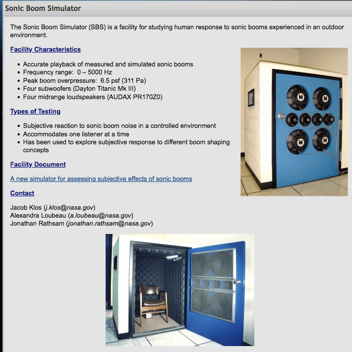

Headphones, car cabins, and small rooms support low frequency, but small room modes affect the level that will be heard in various locations in the room.Small room means no low bass.
Here is a small room that most would have no problem hearing well below 25Hz in, even before the upgrade from JBL to the Dayton drivers:
