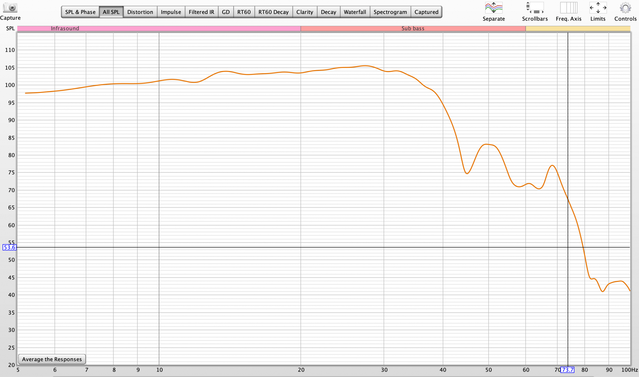

Not sure if this helps or hinders, but I use two BMS 18n862 sealed subwoofers and other than one PEQ around 34 Hz, this is the response in room at the seating position. The FS is 20 Hz on these driver with 19mm Xmax. The room is 5.1x5.0m (annoyingly nearly square, 34 Hz resonance) and 2.65m high, I set the low pass at around 38 Hz
The cabinet I designed and made and ensured it was very rigid and a suitable volume
This is a single cabinet, I now have two and with a very mile 2db LS filter at 20 Hz I am pretty flat to 5Hz

I am very surprised to see decent mic response down as low as that indicates, but I do see a 7 dB drop. Low frequency measurements are very fdifficult to do in anicolic chambers, next to impossiible in uncontrolled locations.
I know many mics and speaker systems claim response that low but it is rarely encountered in the real world. I would be highly suspicious of this response curve, not because I don't believe you but more because of the difficulty of getting valid readings that low. I have no doubt that you have thundering low bass response, but I will bet you that you have deeper bass outside the room and in other areas of the house.
Normally the diagonal of the room represents 1/2 the wavelength of the lowest frequency the room will supprt.

No mention in databass about low frequency measurement being particularly hard. They do use different mic's https://data-bass.com/#/articles/5cc09423a75a260004255c87?_k=cr7mm7
You can get the £100 mic's calibrated down to 5Hz by Cross Spectrum, so they obviously believe they are capable. I doubt my graph, given it's consistency is of no use below 18Hz
I'm not having a go by the way, more perhaps appreciating for me I am not proving but have no reason to believe the results are worthless below 18Hz

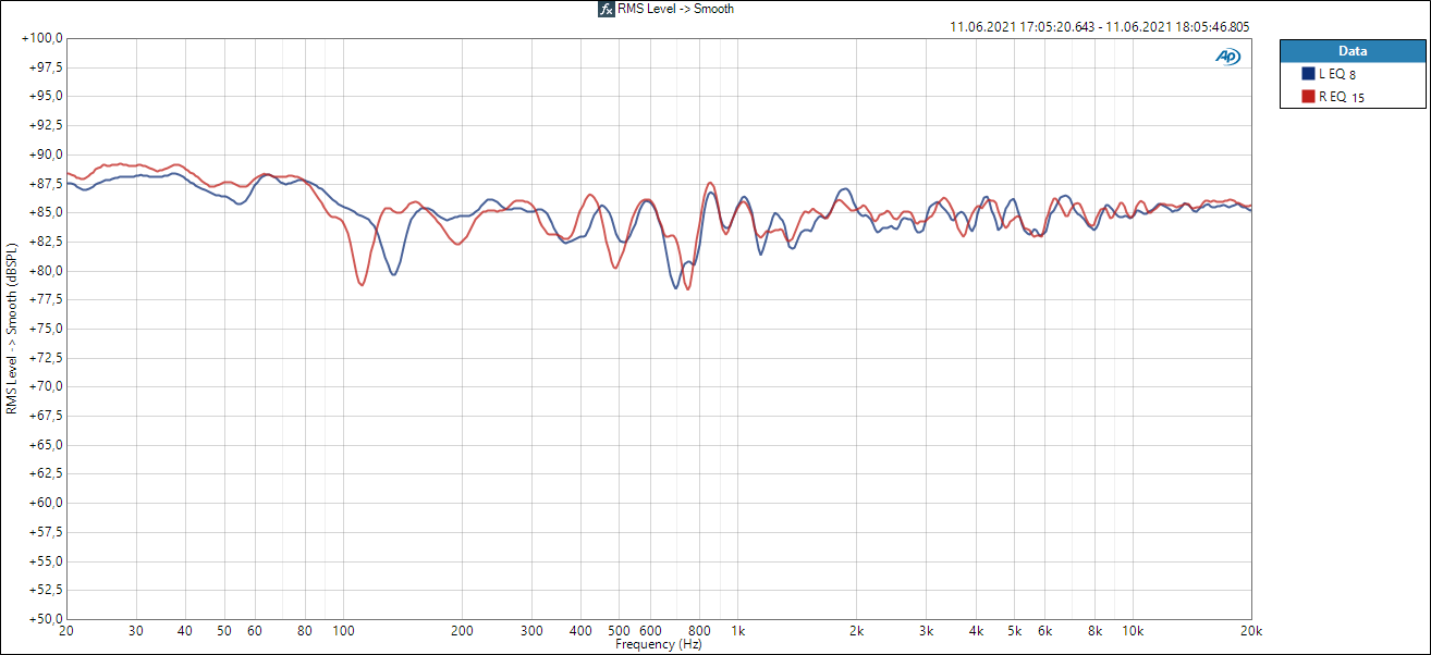

And I can proof it without any problems cause I have a proper room and installation right next to me. Measurements are done with an Audio Precision system and class 1 microphones (Earthworks M50 and GRAS 1/4"). The room is 3x4,5x2,5m big. And it's no problem at all to produce, hear, feel and measure 20Hz and lower in there. And yes, it sounds pretty damn good and it's easy to detect mastering mistakes at lowest frequencies others simply don't hear on their systems.
I also built a speaker für measurements in an anechoic chamber from 16Hz to 60kHz. The chamber is 2x2x2m - no problem at all to do measurements at 16Hz with a PRESSURE microphone. (You would run in troubles with a pressure gradient/cardioid microphone, but that's not how our ear works!) And you also HEAR the low frequencies in the chamber (and better as at the outside of the chamber).
And I also built pure pressure chambers to achieve sound pressure levels up to 160dBSpl for technical testing of devices - I would say i understand the differences.
There is a broad transition from sound behaving as a wave to sound in a pressure chamber. In small rooms we are living in this transition zone for very low frequencies. The EAR works as pressure receiver - it doesn't detect sond velocity. So it doesn't care about this transition, hearing is working there without problems.
(Sorry for the harsh tone - but it's a pain that the "no low frequencies in small rooms" myth is still legit and never get's any substential explaination. I'm probably a little sensitive in that regard.)

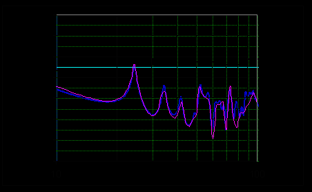

Yes, this is certainly a myth. At low frequency the response in a room is the woofer's free field response convolved with the the source to listener room transfer function. That transfer function is determined by the room's modal response. In a rectangular room that transfer function can be calculated as the sum of all modes from DC to infinity. Higher frequency modes don't contribute significantly to low freguency so they can be ignored. The first, and lowest AC mode (axial mode) is determined from the room's longest dimension, front to back, side to side, or of floor to ceiling. All other AC modes, tangential and oblique, are at higher frequency. Lastly, what is typically ignored when speaking of room modes, is the DC mode. The DC mode is what causes room gain. However, even without the DC mode, there would still be reproduction below the 1st AC mode.
As an example, the room to listener transfer function for a rectangular room looks something like this for a specific room size, source and listener position. The plot extends fro 10 Hz to 100 Hz. The blue trace is the response as computed by the summed modal method. The pink trace was calculated for the same conditions using a finite element approach. The First AC mode is at 25 Hz. Below 25 Hz the response drops to a minimum at about 16 Hz then rises again below that. Without the DC mode the response would flatten out at low frequency. The thing about the DC mode is that it's contribution is not dependent on either the source or listener position. Thus at frequencies well below the first AC mode, the SPL is uniform throughout a small, sealed room when the wave length is much greater that any room dimension. Open a window or a door, and that's another issue. Additionally, the room transfer function is not necessarily minimum phase. It can be, but it is not required to be so. This, along with the amplitude response, has a significant effect on low frequency transients in a room.
