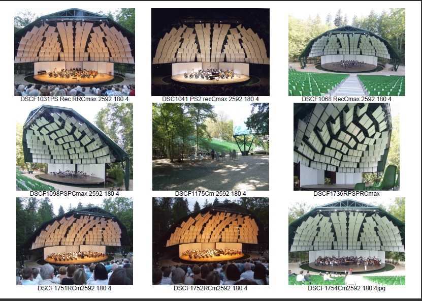

It's not so suprising to see in a typical well made violin bow, the same attention to detail.
The same approach is in a Steinway model D, and again the same approach again in something like the Roque open air acoustic concert hall.
hi definition concert hall?
You bet, it's the best one in the world!
Go from Steinway model D set up by the swiss expert, in the hi definition concert hall source to France Musique live direct, play back on a hi efficiency amp & speaker system, and you are approaching something worthwhile listening to.

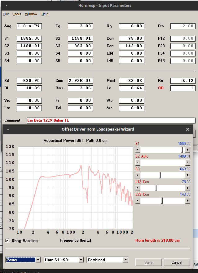

I have a sound room like the OP, sitting about 3.2 m away from the short speaker wall, but I have a 11 meter echo chamber on the back of the listening room. My room is dead with carpet, urethane furniture, record racks & bookshelves, pianos & organs everywhere. I listen to classical music mostly, about 1.5 vpp or about 1/8 watt base level, with occasional 72 db peaks from CD or 55 db from LP. I'm not contrained to vacuum tubes, I think my djoffe modified ST120 and/or my Peavey CS800s sound better than my 5AR4 dynaco ST70. (original 7199 drivers produce 1% HD). I see peaks of 25 v out of either amp on loud orchestral passages. I'm 30 m from neighbors on an open lot so no constraints on my listening volume. I do listen to grand piano & pipe organ material some.
I'm in the camp of hollowboy post 54 on page 6. A 1.4" horn tweeter paired with an efficient 15" ported woofer.
This jibes with pano's early comment, high efficiency and classical material requires speakers with huge volume.
There is no chance of me getting to hear any of the commercial systems discussed, except some churches have Danley SH-50 but drive them with **** electronic keyboards or a out of tune praise band. The house speakers at Ky Center for the Arts when they were doing ballet to CD were inferior to my home system. Violins were screechy. There has probably never been a magnaplaner or KEF within 165 miles of here (Nashville or Chicago). I've never seen a JBL anything for sale within 165 miles except their **** consumer 5 driver toys with +-10 db frequency response.
So I'm in the camp of hollowboy post 54 on page 6. A 1.4" horn tweeter paired with an efficient 15" ported woofer. Best speakers I've heard are Peavey SP2 (2004 edition) with 98 db 1w1m, which sensitivity reaches the goal of the OP. They are 1.4" horn tweeter with 15" woofer, crossed @ 2000 hz. They will go 300 W rms but I have no use for that capability. The "2nd harmonic distortion 20 db down from 1% power" spec is at room level volumes. The lastest pair were $400 plus $40 gas & 12 hours to go get them in Terra Haute. $600 each at the local Peavey dealer.
I test speakers with piano CD's, with a Steinway & Sohmer 40" consoles in the room to calibrate the sound. Up until the SP2's every speaker was a failure. I do go to live concerts, and have hearing good to 14 khz. I have heard original Klipchhorns in 1974, driven my McIntosh, didn't like the jazz being played, not a decent test. Trumpet+snare+string bass is no test of system accuracy.

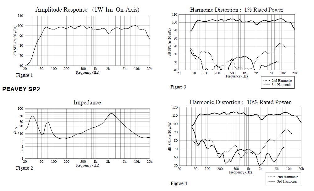

Now you mention the Peavey SP2. I would never have considered those. The freq resp graphs look OK, but that's for a version that's no longer made. The SP2 designation has been in Peavey's line for decades, so I don't know which version you have. Does yours look like the ones in either of the attached photos?

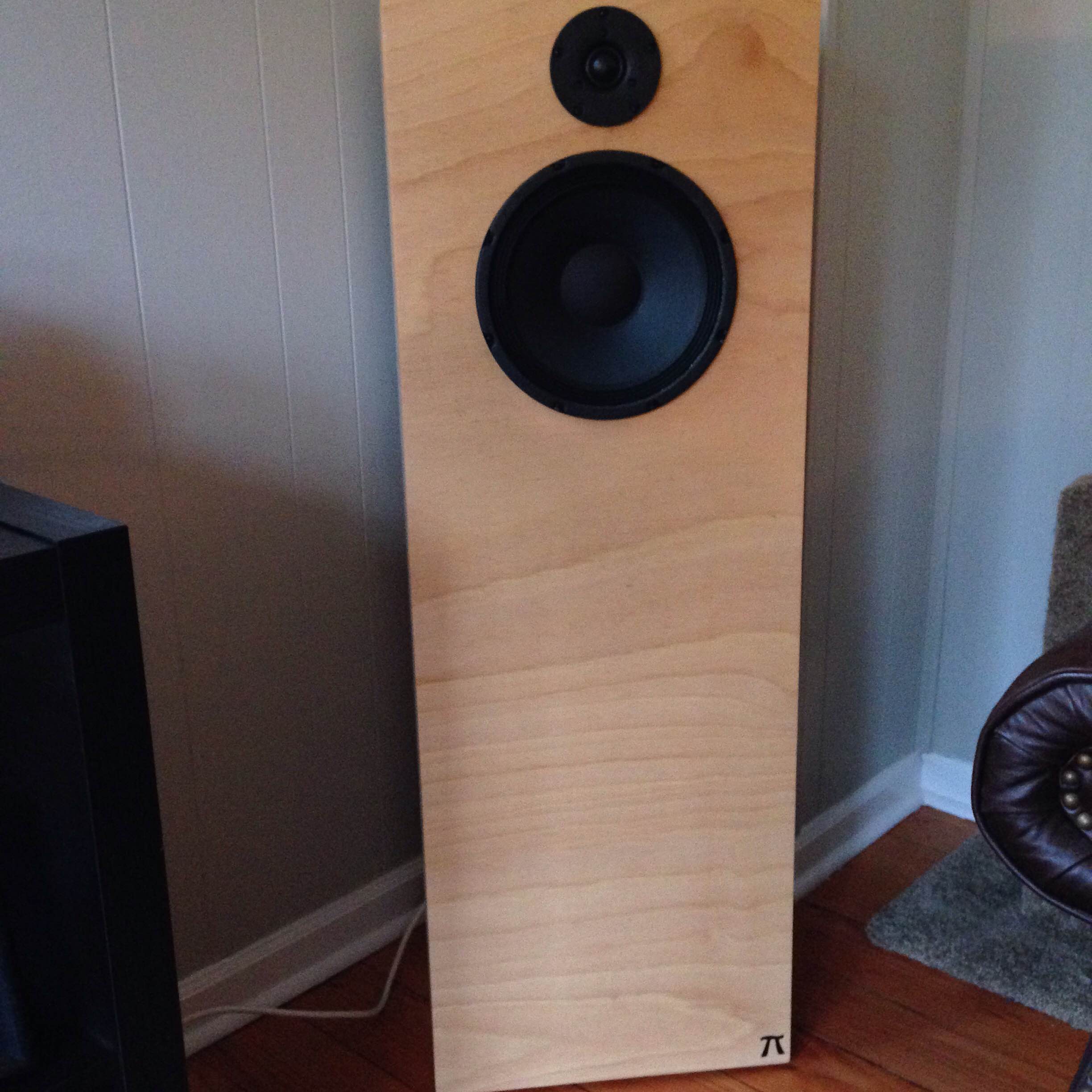

Wayne Parham has a line of speakers called pi Speakers. The Three pi model is his mid-line 2-way with an oblate-spheroid waveguide loaded compression tweeter driver. It's basically a PA-style speaker engineered for hi-fi. This might be the way to go. https://www.pispeakers.com/Products.html
So, it looks like diysoundgroup and pi Speakers offer speakers that fit the mold of an SP2-style big 2-way with compression tweeter designed specifically for in-home use. Could this be the way to go?

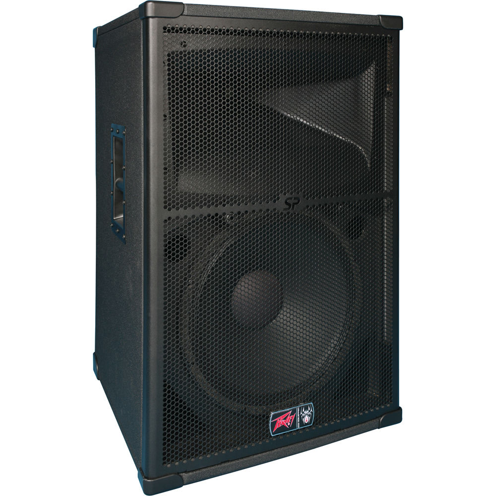

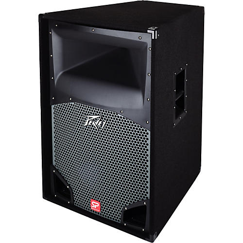

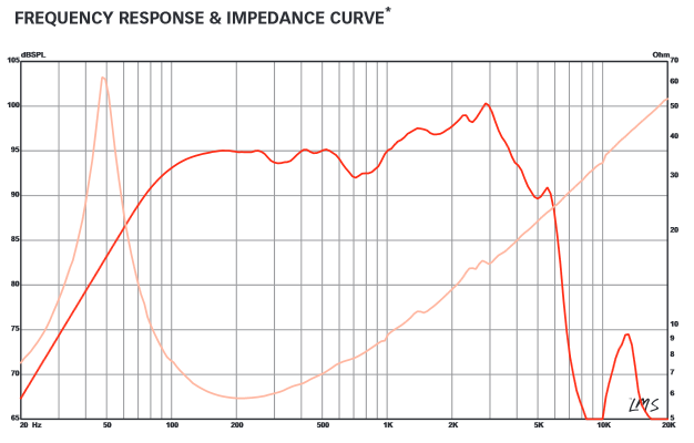

My SP2 speakers look like the ones on the left. The best sounding version, 2004, the ones with the distortion spec on the datsheet. IMHO 2004 has the rounded looking tweeter horn, 2 vents, 2000 hz crossover, speakon connectors, and a wedge shaped box to reduce the beaming of the mid range from the woofers. 2004 was made for about 18 years, and since identical drivers are still available from Peavey, used ones shouldn't be a risk. I haven't heard the 1000 W rated version SP2 in the right picture and can't assess it's sound.Now you mention the Peavey SP2. I would never have considered those. The freq resp graphs look OK, but that's for a version that's no longer made. The SP2 designation has been in Peavey's line for decades, so I don't know which version you have. Does yours look like the ones in either of the attached photos?
I have my SP2 on poles 2 m in the air since the tweeter directs sound down at the audience. I have mine twisted to face me at my couch 3.2 m from the speakers on the left wall. They are 2 m apart and .5 m from a hard plaster wall, centered in a 3.8 m width room. Ceiling is 3.2 m, acoustic tile.
I previously had 1997 SP2-XT which were the same drivers, 1200 hz crossover, wedge shaped tweeter horn, parallelapiped box, unvented. Those were stolen 9/2020. The high end was a little fuzzier in my piano test, but good enough when SP2 2004 were rare on the used market. Those had a specification for wide beam width at 500 1000 2000 hz etc which probably was a feature of the low crossover. The 1200 hz crossover limits the amount of power the speaker can handle on pink noise, as the RX22 driver is limited to 70 W. The 2004 version presumably has a narrower beam width on midrange.
I've also heard nice words said about 2 ways York U15, Yamaha 15, JBL 4367 (copied by asathor, see the thread) and Klipsch Heresy. None of those has showed up used within 1000 miles, and none are for sale new here except Yamaha, which I wouldn't buy. Never heard any of them.
I have heard Peavey 1" tweeter PV15, and didn't like the mid-range. Okay for guitars & basses in bar bands I suppose. Keyboard people tend to like the Peavey KB300 which sound pretty smooth in the stage shows I've seen (Bowling Green Newgrass festival). KB300 is self powered and contains a 3 input mixer with effects.
I was going to build SP2 clones with a Eminence DeltaPro-15A (new) woofer and a couple of used wedge shaped Peavey RX22 horns from ebay, but finding the real thing for $400 the pair has stopped that project at the buy mdf stage. The ones I build would be very ugly and may be burglar resistant as a result. Same 54-17 khz target frequency range. I do really need a 15" woofer dedicated to 30-54 hz as i listen to pipe organ, and Beethoven Appasionata sonata has some low octave piano notes, but the box for that is different (venting) than a 15" woofer that also does mid-range to 2000 or 1200 hz. Might be the same driver.

indianajo - I'll keep my eyes peeled for a used pair of passive SP2 of the right vintage. None around here now, but I'm sure they pop up from time to time.
I've heard Klipsch Heresy a couple times. I really dislike Klipsch speakers. A lot.
system7 - I've been in contact with Michael Chua and was thinking of the Osprey-BR as a possible project. Eminence Beta 10CX are out of stock pretty much everywhere, but I'm hoping to track a pair down. I also need to purchase a pair of the Selenium D220Ti cds, so the cost of drivers will be about $300 USD, and then I'll need to spend a bit for crossover parts, probably another $80 to $100 USD. But it's certainly doable. The main attraction for me is that I have the cabs from the old Klipsch KG52, which fit the Beta 10CX drivers perfectly, flush mounted and everything. They're a little larger than what Michael designed for (55 liters as opposed to Michael's 45l), but I can make that work. I could even fill parts of the cab inside to make it 45l. The best thing about Klipsch speakers is their cabinets. Nicely made, nice and stout.
Took 9 months to find some here <200 miles, but finally happened. Take your CD player & amp & listen, I did. @ $200 ea I didn't worry about fidelity much, just that both drivers worked. The SP2-XT @ $300 ea, I took a Beethoven piano CD & listened pretty carefully. Take an amp, the Terra Haute owner wouldn't let me plug my FM radio in his 1000 W amp, was afraid I would blow it up. (lots of bar band amp inputs get blown by 75 w guitar amp speaker cables).indianajo - I'll keep my eyes peeled for a used pair of passive SP2 of the right vintage. None around here now, but I'm sure they pop up from time to time.
Bar band repair services tend to remove the 15" woofer and replace with some kind of cheap trash driver. Don't condemn the sound until you look closely at the woofer. A new 1505-8KADT from a Peavey rep should get you back to specification. tubesandmore.com of Arizona is one such rep selling OEM. Parts-express has some Peavey too. The 22XT tweeter is so infrequently blown that they are routinely available on ebay.
I'm still kicking myself that I didn't take the SP2-XT apart when I had them & measure the crossover components. 1200 hz crossover sealed is a whole different design than the 2000 hz vented boxes I have now. Haven't seen SP2-XT on craigslist/ebay in 15 months.
Were some JBL4367 in NJ on ebay for a long time, but you had to buy a whole theater set of them with lots of subwoofers- $5000. Uhaul would have been $1000.

People have had a good time with the 2Pi speaker as well which looks like closed box:

An Eminence Alpha 10 (FR below) and a loud Vifa 1" tweeter.
I think I could do better than that. But easy enough. 😀

According to the Pi Speakers website, the Two Pi speaker is a bass reflex 2-way, using an Eminence Alpha 10 woofer (PA midbass driver with paper cone, accordion edge) and a Vifa DX25 dome tweeter. Sensitivity looks to be around 95dB/1W/1m, which is great. There's a tower version too, bigger cab for lower bass. Its impedance stays fairly high until about 5kHz and higher, where it dips down to 4 ohms (the DX25 tweeter is 4 ohms nominal).
So, has anyone heard this speaker? There are some very positive comments scattered around the internet, so perhaps this is the best high-efficiency cost/performance contender.
The One Pi looks superficially like the Snell Type J (4 ohms, 91dB/2.83V/1m). I wonder if they sound somewhat similar?
The star of the pi Speakers show is the Three Pi, which is a big 2-way bass reflex using a compression driver/waveguide and 12" PA woofer. It's no more efficient than the Two Pi, and its bass response is a little bit attenuated in comparison. However, its impedance curve is flatter and stays higher (minimum 8 ohms). A horizontal dispersion plot is shown on the Three Pi page, which makes me think the waveguide makes for much smoother horiz dispersion than the dome in the Two Pi. Of course the Three Pi is a lot more expensive than the Two Pi. So there ya go.
I wish I knew someone who's heard these Pi Speakers.
Since I already have a pair of cabs that will fit them, I've ordered drivers for a pair of AmpsLab Osprey-BR. I'm a feeble woodworker, so having the cabs makes this a reasonable project for me. Otherwise the project would involve hiring a cabinet maker to make them for me, which would add a lot to the costs. I'll try to remember to report back here on my findings.
I was using "5 watt single ended amplifier" as an example of why someone would want a high efficiency speaker for classical music. I'm actually more of a push-pull kinda guy. I built a DC-coupled PP 2A3 amp I like. It makes 6W/ch using an OPT with 5k p-p primary for better damping (at the cost of a watt or two lower power out).

Some things to consider...
Eminence Beta-12CX 12" Coaxial Driver
Eminence ASD1001 1" HF Titanium Horn Driver 1-3/8"-18 TPI
Doesn't go really deep in sealed but a transmission line has a bit nicer behavior than a standard ported and might work quite well.
If you want to go three way for a little more bottom end you can run the coax as more of a midrange tweeter combo and use a more substantial bass driver on the bottom.
Eminence Beta-15A 15" Driver
