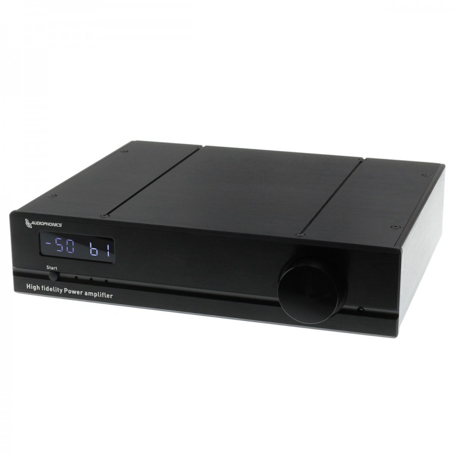

New TPA3255 Finished amplifier from Audiophonics :
AUDIOPHONICS TPA-S100 Amplificateur Class D TPA3255 Bluetooth 5.0 2x 85W 4 Ohm Noir - Audiophonics
Looks nice, not specified if it's PFFB.
They do list 111db S/N though, and I don't see how that's possible IRL without PFFB.
Specified as 85w/ch in 4 ohm which is a bit less than expected, should be for 8 ohm IMO.
But overall it seems like a good product, clean look, nice to have basic treble/bass adjustment, power is adequate for most livingroom-use scenarios.
Would like to see another digital in, either coax or toslink, though it's probably enough for most enthusiasts to have only USB input.
Looking at the design choice of 16bit and other compromises, it probably sort of limits the noise floor to about 96db or so IRL, adequate for most, but I think this amp will struggle to achieve the specified 111db S/N.
Certainly value for money, a good amplifier for most & clean look, but probably not the most "ultimate" TPA3255 amp out there.

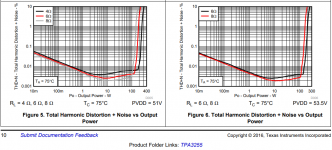

85watts in 4 ohms per channel is okay, but the chip is capable of that in 8 ohms at very low distortion values. See picture.
Looking at the amp and the other information that can be gleamed, if I'm putting on my critical glasses:I'd say that's a lie, the highest possible in this configuration is likely 96dB, probably not better than 90dB IRL.SNR 111dB
