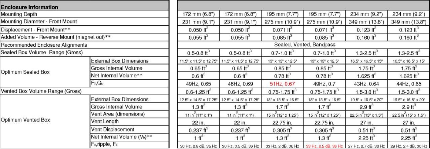

Sorry, I thought question was clear enough, didn't know there were multiple answers.
This is alpine type r subwoofer guide that has recommended enclosures. You can see it has "F3, ripple, Fb" box. (I am interested in third row, that's my sub)
Does it refer to peak in its response? Like: 33 or 36 Hz will be 2 dB louder than everything else.
I believe in this case it is as you identified, a peak in the response around the tuning frequency. A response like this usually occurs when the driver is in an enclosure tuned 'too high', but being a car application I expect there are real limits placed on how long the port can physically be and hence how low the tuning can be brought.
Pretty much in this case.
Here is the family specs:
http://support.alpine-usa.com/products/documents/OM_SWR-1242D.PDF
A typical "maximally Flat" design for this woofer (If it is the 1222D) would be about 50 liters tuned to 26-27 Hz. If you tune higher than that, it will have a peak. Model it in WinISD or some other program using the parameters in the file and you can see the response shape that results.
For a Car, I'd put this woofer in a 1-1.5 cubic foot (30-40liter) sealed box and forget about it.

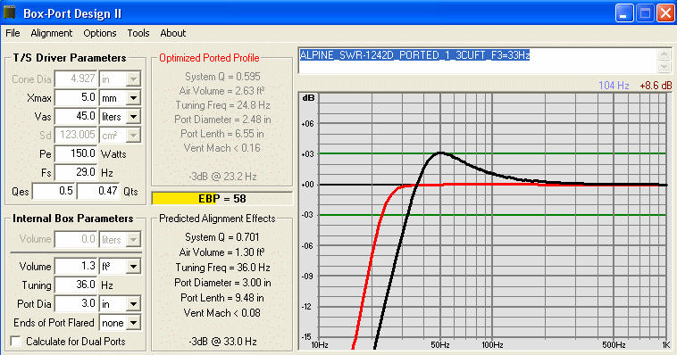

Yes, it does, though the term ripple is rather misleading.
This is what it looks like in a ported box of 1.3 cuft with the box tuned to 36Hz.
The peak (+3dB) centers at 50Hz with F3 at 33Hz.
Regards
Mike

The vented alignments give them a bit more output around 40 Hz. The extra 2dB of output around that frequency can make rap and other bass-heavy music sound a bit more impressive.
The Type Rs work fine in sealed boxes however, particularly if you give them enough power. I use two of the 12" Type Rs in my car, sealed boxes, around 1.5 cu.ft. each, driven with about 600W each. I'm very happy with the results.
