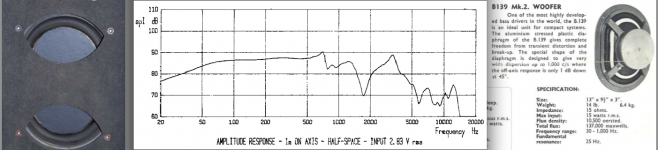

What is the effect of hiding the B139 in the Kef Concord?

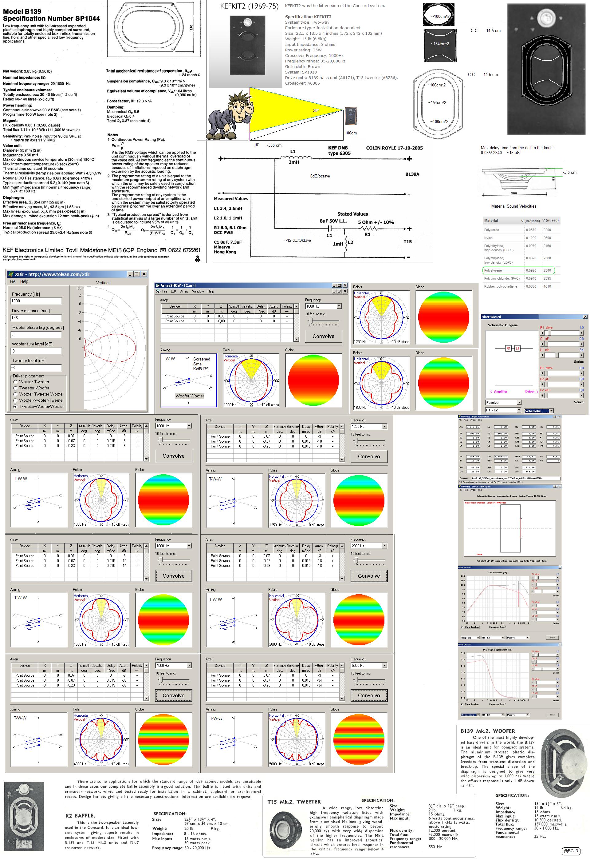

As a matter of interest I have found an even more unusual Kef speaker design, the K1 (LINK). This utilises the flat rectangular 18" x 14" diaphragm B1814 woofer and has two bars in front of the diaphragm which I can only assume are some sort of baffle board bracing? Unlike the Concord, it has a mid-range unit but also uses the T15 tweeter. Absolutely amazing!
Hi, FYI
Might be of use...:
b:)
PS: Change .txt to .frd extension and the two _wave files to .wav
