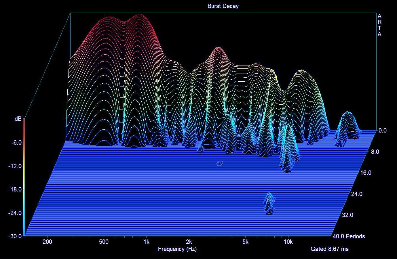

Erjee asks “Besides the 'broadband CD point source' characteristic there are two other aspects of the SH50 which are not found in normal indoor hifi speakers:
- very narrow directivity (50 deg beamwidth)
- the lack of any baffle which probably reduces the amount of diffraction
Do you consider the second aspect as an important property for a loudspeaker?”
The constant directivity is a useful thing in commercial sound where you have a listening area as opposed to one location, the benefit is that everyone hears essentially the same spectrum.
Two ways these are different though is that they radiate as a single source, as if it only had one small broad band driver and as a side benefit, they can reproduce a square wave over a decade wide band. That is not a key but an indicator that they system radiates the same place and time or phase over a wide band.
A fun thing to demonstrate is that you can remove the grill and even when your head is inside the horn mouth, the sound always sounds like it is somewhere floating in front of you, you can’t ever hear woofers mids or the hf driver. A friend used a pair on his computer desk as his monitors.
The other thing is that at any level one would ever what in a living room, they are loafing along and the mid section especially has very low distortion. Consider using shaped pink noise, raising the level every 5 min, the point the response shaped changed (relative to 1W) at just one frequency by 3dB was at 56 V rms (1w 1m sensitivity about 100dB)
So far as diffraction, actually that is one thing a horn can deal with, it is the deliberate control of the radiation angle and in a conical horn the wall angle doesn’t change but as the mouth gets larger, the pattern control loss frequency goes down in frequency. Above that frequency, the mouth is large enough to define the radiation angle and so assuming one drives it with an acoustically small source or one that was curved already, then what one radiates is a segment of a sphere.
What is very different from most speakers is how much energy is radiated to the sides and rear compared to normal. In commercial sound one wants as much of the energy as possible where the ears are and as little as possible on the walls floor and ceiling especially in front of the audience. I don’t know that there are many polar plots for hifi speakers handy but this part one can see by examining the polars for an SH-50.
If you down load the .CLF data file for it and the file viewer (free) you can examine the polars and a number of other things.
Anyway, remembering we are talking about the energy in vs out of the pattern, here is what an SH-50 looks like at say 90 degrees off axis.
At 160Hz it is about -5dB at 90 degrees off axis
At 250Hz it is about -8dB at 90 degrees off axis
At 500Hz it is about -20dB at 90 degrees off axis
At 1KHz it is about -20dB at 90 degrees off axis
At 2KHz it is about -23dB at 90 degrees off axis
At 5KHz it is about -28dB at 90 degrees off axis
At 10KHz it is about -35dB at 90 degrees off axis
At 16KHz it is about -26dB down 90 degrees off axis.
Consider that when the beam is -20dB, it is 1% of the intensity on axis and so the spectrum both on and off axis (reverberant field) is primarily the on axis response.
The result of that directivity in my living room is that the measured response at the listening position is very much like the response at one meter.
A high resolution measurement of small cone/dome 2 way measures about + - 15 dB over the 1 meter response at the LP, the SH-50 measured about + -3dB over the 1 meter response at the LP.
It would be my guess that the large reduction of the reflected sound that allows the L.P. response to be much better combined with the time response and lack of depth cues radiated by the speaker is also why the mono phantom can be so strong.
The near field is very large and the reflected energy very low.
A funny thing too, if you place two normal speakers side by side and play music, there is obvious comb filtering if you move around.
You can place two SH-50s side by side tight together and there is no audible seam at all. That acoustic array-ability is useful in commercial sound but this arrangement also lets you place a speaker against a wall or boundary without reflections or an audible seam. . If you scroll down to page 7 here; you can get the idea how this is possible.
http://www.danleysoundlabs.com/pdf/danley_tapped.pdf
I have used this directivity / boundary trick in a narrow room which makes a stereo image the entire width of the room and in commercial sound, people often place them on a ceiling aiming down and the floor monitors work that way but pointed up. as long as the array-able side is used, there is no audible seam or reflection
Hope that helps explain.

This was taken in an untreated room, except for floor bounce (see below)
Floor: Approx. 70% wood tiles, ca. 30% glass, nearly plane
At the reflection point floor covered with a 2cm thickness wool carpet, approx. 70cm x 70cm
Ipsilateral side wall: Approx. 50% stone and 50% glass, nearly plane, stone non porous.
Speaker position
Floor standing.
Distance to side wall approx. 65cm
Distance to front wall approx. 150cm
Distance to back wall >500cm (non uniform)
Ceiling height approx. 240cm
Microphone (omni) position
Distance approx. 150cm from speaker.
Height approx. 80cm in direction of listening position
Approx 25 degrees off speaker's axis and speaker toed in slightly
__________________
This means floor bounce and ipsilateral sidewall bounce are included ...
Surely frequency response of this experimental proto was not a beauty,
but i posted it due to "early reflections" we were discussing.
That early proto resembles a planar bending wave transducer in open baffle
configuration. Side wall reflection at LF is suppressed by the dipole notch.
Ringing around 5Khz is due to that proto version itself.
Transients, those bästards !
