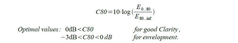

but what is clarity? in fact there is a scentific convention on factors of clarity -
for Leo Beranek ("Concert hall acoustics", Journal of the Acoustical society of America 92, 1992) clarity is about the "adequate ratio between the energy of the first 80ms and that in the next 2s":
"Clarity means the ability of distinguishing successive musical notes and different instrumental groups or the clear detection of words. It seems to be a degree for intimacy. As an objective criteria for music it means the ratio between the energy of the first 80ms and the energy after 80ms."
see picture below
"For speech applications the same criteria is used but with the limit of 50ms."
looks like neither clarity nor clarity/spaciousness is a question of early reflections AT ALL
That may or may not be true. I don't think early reflections are good, but it's not just the clarity thing. There are big problems just in terms of amplitude response from early reflections in some frequency bands. If the delay of the reflection is close to the half period of the waveform, it makes roller coaster response. It's very noticeable when compared with another speaker that doesn't do this, night and day.
