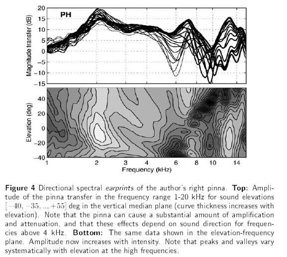

"spatially homogenise the pinna cues" - doesn't make sense to me, what will it result in?
Another way to put it: make the field more diffuse at high freqs.
My question is still unanswered: what perception do "spatially homogenised pinna cues" lead to?
It's easy for you to test by yourself Only you can answer the question how you will perceive it.
I'd think to even more sources than just two single tweeters, no high frequency localization at all or to a multitude of sources coming from the same direction as any reflection that is loud enough to override precedence.
For me it's no high frequency localization at all like in a diffuse field. But this does not matter in a phantom imaging sense, because the stereo phantom are more strongly perceived at midrange. But it prevents perception of the two tweeters.

When talking about the frequency range from 2Khz to 8Khz, i can see
advantages in a diffuse radiation by lowering the risk of
- pinna cues of direct and early reflected sound contradicting
phase information derived from bass (above Schroeder frequency)
and midrange predominantly (in broadband sound sources like an orchestra e.g.).
- interference artefacts between the stereo speakers messing up
intensity information between channels which is important for phantom
localization above 2Khz

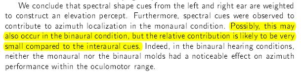

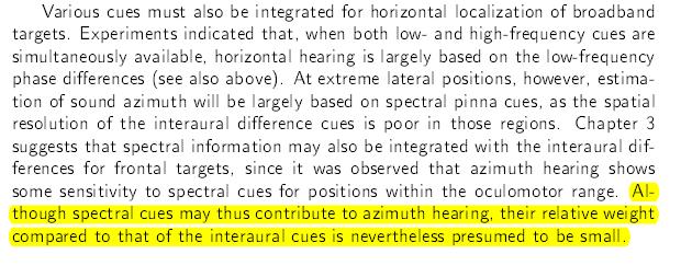

Forget about the pinna cues for stereo
Both from "On the role of spectral pinna cues in human sound localization":
http://repository.ubn.ru.nl/bitstream/2066/18958/1/18958.pdf
Why forget ?
The data of your reference is based on 7 subjects in anechoic chamber.
They even conclude : "spectral cues may contribute to azimuth hearing".
And then they just present an presumption about the weighting.
- Elias
As I find it interesting I took deeper look at the paper. I notice I made an error: the data in azimuth test is not based on 7 subjects but on 4 subjects ! The two authors, and two laboratory stuff. It was a poorly financed research team, but that is so typical
Tests were anechoic, yes.
However the test did not test for phantom imaging but is based on localisation of a real sound source.
With this setup, together with cross-talk, they can only conlude that pinna localisation is not more dominant than ITD or ILD. However, the absolute level of ranking or importance was not tested because they did not test the oppisite where cross talk would have been removed and localisation is based only on pinna cues. It could have been possible with other arrangements, but they did not do it.
So we can only say that removal of pinna cues (with molds) did not effect the localisation of a real sound source in binaural condition in an anechoic chamber using wide band noise signals
- Elias
