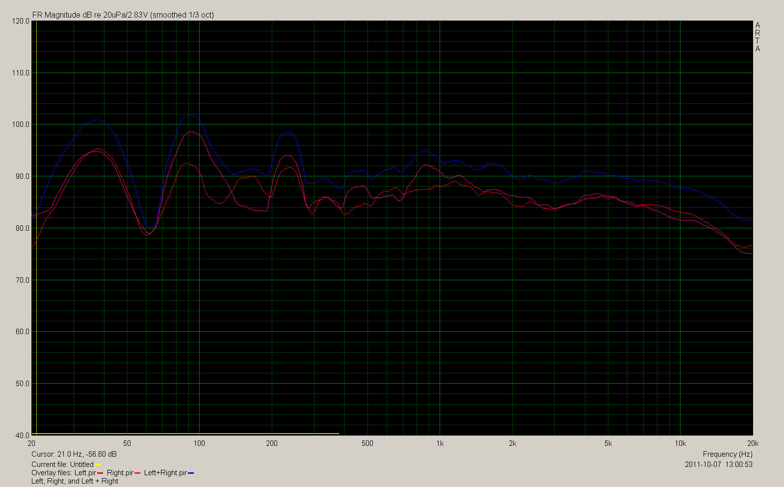

All measurements are pink noise based 1/3rd Octave smoothed with no windowing applied, so they're overall "room response". The microphone is about 2.5 metres from each speaker and carefully adjusted to be exactly equidistant, determined by the impulse response, as well as verifying optimal cancellation at high frequencies out of phase.
The first image is just to get a sense of the overall response, where red is left, purple is right, and dark blue is both channels in phase.
Things we can see from this is that overall the two channels track, but there is a large bump just below 1Khz on the right speaker which is much closer to its wall than the left speaker, as well as the wall being un-obscured. Both speakers measure very close to the same through this region when measured at 1 metre gated, so I can only assume it's the wall reflection doing this, or some other room asymmetry..
There is also quite a difference between the two between 100-200Hz, in particular around 160Hz where one has a peak and one has a dip. I suspect this is due to comb filtering due to the unequal spacing from the side wall, or perhaps modal effects.
Dark blue is the two responses summed in phase. Across most of the range the summed response is only around 4dB greater rather than 6dB despite the mic being exactly equidistant. I can only assume the reason for this is that a large portion of the steady-state response for each individual speaker is un phase correlated room reflections which on average will add to 3dB, plus a little bit of correlated signal, giving somewhere between 3dB and 6dB.

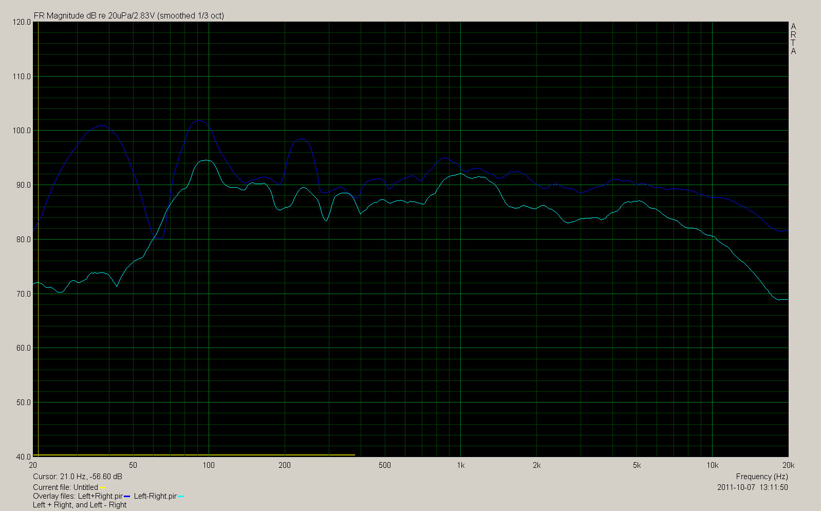

Ok, image two is a direct comparison between Left + Right, and Left - Right. Dark blue is the same Left+Right response, with light blue Left-Right.
Some observations - below 90Hz the Left-Right response rolls off, which fits in nicely with the speakers being 1.8 metres apart which is about a half wavelength at 90Hz.
Overall the difference between in phase and out of phase is far less than I was expecting, and is greatest where the speakers are most directional - about 2-4Khz, and 6Khz upwards.
I'm quite baffled by the huge mound between 800Hz and 1.5Khz for the out of phase response, where there is hardly any difference between the in and out of phase response.
My theory for this is that the large side-wall reflection from the right speaker and wall sums together at the listening point to give cause an overall phase shift between left and right speakers of around 90 degrees at this frequency. (I'm not convinced of this though, so if anyone else has a better explanation...)
Likewise at around 360Hz where in and out of phase connection gives the same level, there is probably about 90 degrees phase shift between both speakers due to the unequal distance side-walls.

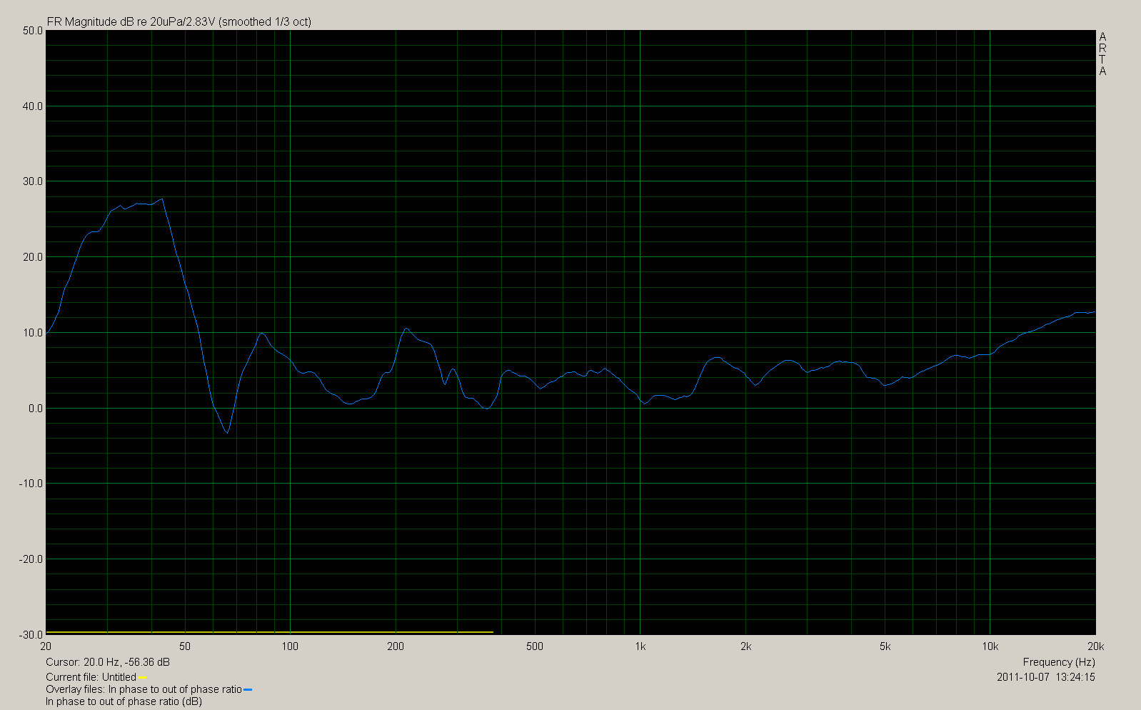

Image three is the amplitude of the out of phase response subtracted from the in phase response, essentially giving a direct to reverberant ratio referenced to the 0dB line.This gives a bit clearer picture.
Even if we ignore the anomaly around 1Khz, the ratio between in phase and out of phase response is only about 4dB on average until we get about 7Khz. This seems very low to me.
Does this mean that at my listening position I really do have a direct to reverberant ratio of only around 4-6dB ? That does fit in well with my impression that at the listening distance I'm only just barely within the "critical" distance for the room, and that the room is fairly live.
I will be interested to see other peoples measurements.

Ok here are my results, and in some ways they're quite surprising.
Of course the method relies on cancelation to reveal the reverberent field. Cancelation requires balanced levels. Your system seems well balanced but there are some room effects giving curve differences in the 70 to 300 range. For others doing the method, try and null out the difference curve with some fine tuning of the system balance knob.
Of course if room effects are giving different curves then that should be considered part of the reverberent field (early reflections).
It looks to me that you are just about at the critical distance: reverberent level is just a little below the direct level. My understanding is that most domestic system have listeners about at the critical distance so you are in good company.
