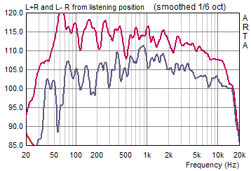

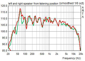

I am a bit late, but just for the records - this is what I measure at home:
Left and right each:
Sum and difference:
Both impulses (one inverted):
Does anybody know, why everybodies +/-comparison converges in the bass region, while mine diverge?

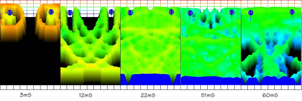

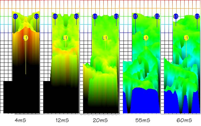

Diffusion in the Room
I was wondering a bit about the diffuse field in a small room so I ran CARA sims on 3 rooms of similar sizes but different layouts. Two are shown below, my room and a friend's.
The room sims are not stuffed with all the furniture, books, busts of Beethoven, etc that the real rooms are, so they are basic. I also ran a stock room (not shown) that came supplied with the software that is much more complex and takes longer to calculate. All 3 were similar. I can post the more complex room if anyone is interested.
You are looking into the room form the back wall behind the listener. The speakers are indicated by the blue pins.
The sims show a Dirac pulse thru time. The direct sound hits the listener at 10-12mS and by about 22mS a diffuse field is built up. That diffuse field lasts until about 60mS in all 3 rooms then starts to fall apart.
For your amusement, I thought you might like it.

Mine are diverging below 200Hz, too. I think part of the reason could be that we both are using dipoles in the bass ?Does anybody know, why everybodies +/-comparison converges in the bass region, while mine diverge?

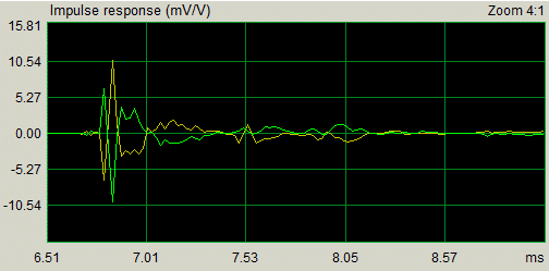

It looks like you've shown individual impulses of left and right speakers with one reversed in phase ? I'm not sure if you were trying to produce something that could be compared to my impulse response, but if so I was measuring something different - one impulse was from my Left+Right measurement and the other from my Left-Right measurement.I am a bit late, but just for the records - this is what I measure at home:
Sum and difference:
In any case it looks like you have quite good symetry there apart from one reflection in one channel at 7.53ms on the axis.
Not everyone's in and out of phase measurements converge in the bass region - mine clearly don't, where you can see a rapid downwards slope below ~90Hz in the out of phase connection of around 24dB/octave.Does anybody know, why everybodies +/-comparison converges in the bass region, while mine diverge?
The reason for this divergence is because the out of phase connection reverses any lobes and nulls in the combined polar response formed by the pair of speakers.
If they were connected in phase this means below the frequency where they are a half wavelength apart no nulls can form in their combined polar response. (~90Hz for speakers 1.8 metres apart as mine are) When phase is reversed, no lobes can form instead, so you get almost no output, hence a very rapid fall off below this frequency.
What puzzles me is not why some peoples results don't diverge at low frequencies as they should, and I suspect there is something funny going on with the measurements, or the cancellation between the speakers at low frequencies is poor, probably due to room effects.
In Markus's measurements the noise floor is too high at low frequencies and because he's only measuring a pair of satellites with no real bass response, the divergence that should be seen is below their operating range, and also masked by the noise floor.
Pano's results puzzle me - neither convergence or divergence at bass frequencies.
KSTR's results look as expected to me - there is obvious divergence at bass frequencies.
Wintermute's results show obvious divergence below about 60Hz - consistent with a speaker spacing of roughly 2.5 metres.
Dave's results don't show the divergence I'd expect in the bass, but he's using different software to everyone else so if I had to guess I would say that maybe there are problems with noise floor at bass frequencies in those readings, as an actual RTA reading is not going to have as much ambient noise rejection as something like the random phase multisine (noise based impulse response) mode of ARTA.
Not sure whats going on in the bass in ra7's measurements, perhaps a combination of noise floor encroaching on the measurement as well as asymmetric room modes caused by an irregular shaped room or largely offset speaker positions in the room.
There's as much variation in the bass cancellation for different respondents as there is at higher frequencies. Some may be the use of different software and measurement techniques but some will also be fundamental differences in rooms...(symmetrical vs asymmetric rooms etc)
Don't forget that mine is ~15dB in the bass, same as Rudolf. It just does not change much as the frequency goes higher.Pano's results puzzle me - neither convergence or divergence at bass frequencies.
