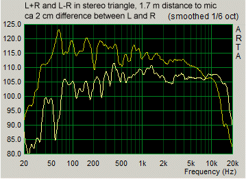

I have done some additional measurements with the in phase/out of phase model to see the impact of implementing unbalancies. If you don't get the distances from left and right speaker to the microphone exactly equal, you get something like this:
attachment.php

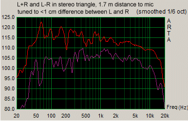

Only when I achieved less than 1 cm difference in the distances, the result became reasonable:
attachment.php
In fact this measurement is a more precise method to get to the exact point of the stereo triangle than my measuring tape hold free in the air. 🙂 Next I switched off a -6dB bandpass at 1.9kHz in the left speaker only:

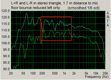

Putting some pillows on the floor between left speaker and microphone led to another sort of unbalance:
attachment.php

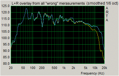

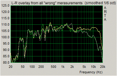

Again it is mainly the L-R curve closing the gap to L+R,nicely illustrated by these diagrams:
attachment.php
attachment.php
In the end this method is like the telephone call in the mid of the night: A muffled voice at the other end of the line is telling you "You are in deep trouble" and then hanging up. Now you know that things really go wrong, but you have no clue what to do about it. 😕
