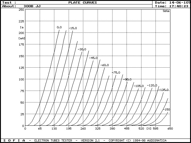

Draw your load line on the Audiomatica (real, measured) curves posted earlier for the VV30 (300B), and compare to the EL34.instantaneous Rp undergo pretty dramatic changes.
The 300B Ra shifts only slowly, if your load line is 4 - 5x nominal ra, say 4000 or 5000 ohms.
With the EL34, you first have to decide what the ra actually is, since the grid has lost control once the anode voltage is only a short way into its positive swing.
The shifting ra in idhts, and the non-uniform spread of the triode curves are part of the same effect, and both will add distortion that is lower in a DHT.

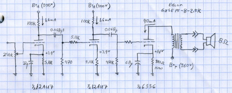

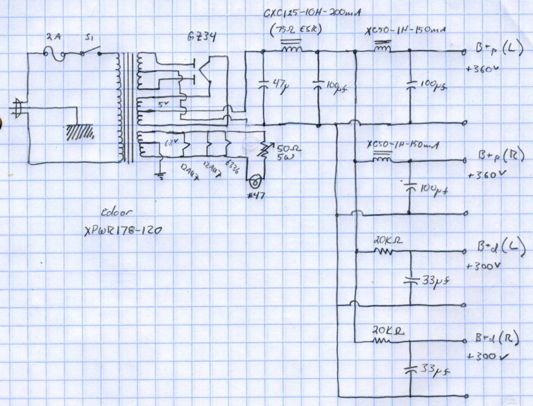

https://www.cascadetubes.com/the-6336-set-amp/
The original manufacturer is at the address above. Read the detailed specifications at the address above.
Could we split discussion of the 6336 amp design out to a different thread?

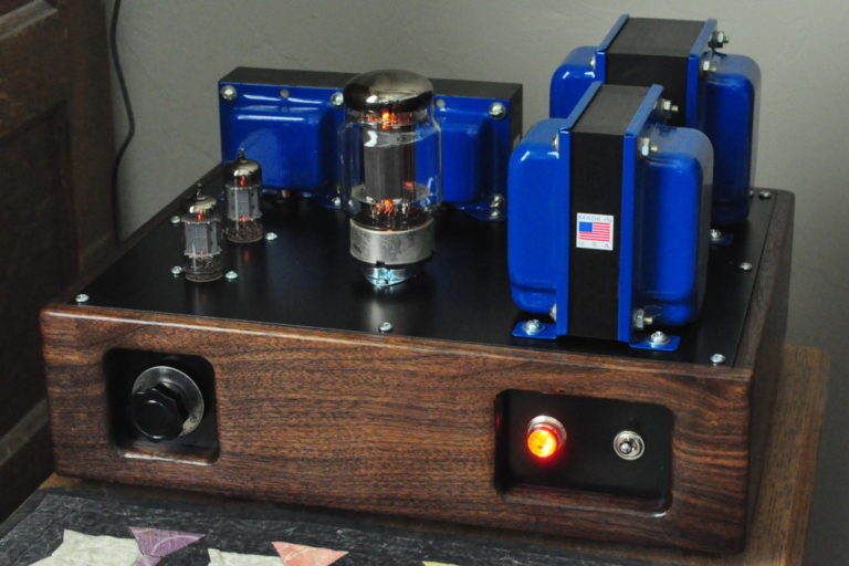

Hi guys, Yesterday I've finished building the 6336 SET amp based on this website:
After that I did some testing on the amp I found some strange wiggling on 1W output frequency response graph at around 14 - 30 Hz:
What can cause this wiggling? BTW is it even something to get worried about?

this is a JJ 300B curvesDraw your load line on the Audiomatica

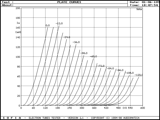

This is KT120 Triode
The curves are not bad. less linear than 300B of course.
And the distance from each other seems to be also good.
For EL34 I have othre curves ( to translate) but less or more are similar.

Thanks for sharing the plots.The curves are not bad. less linear than 300B of course.
Can the tester reach higher anode voltage? The full story can be seen at 2* V.idle - 800V (KT120) for preference.

Definitely the tangent of curves changing more with voltage rise compared to 300B and 2A3.This is KT120 Triode
If someone could draw a loadline on these and calculate tangent across the grid curves would be helpful too.

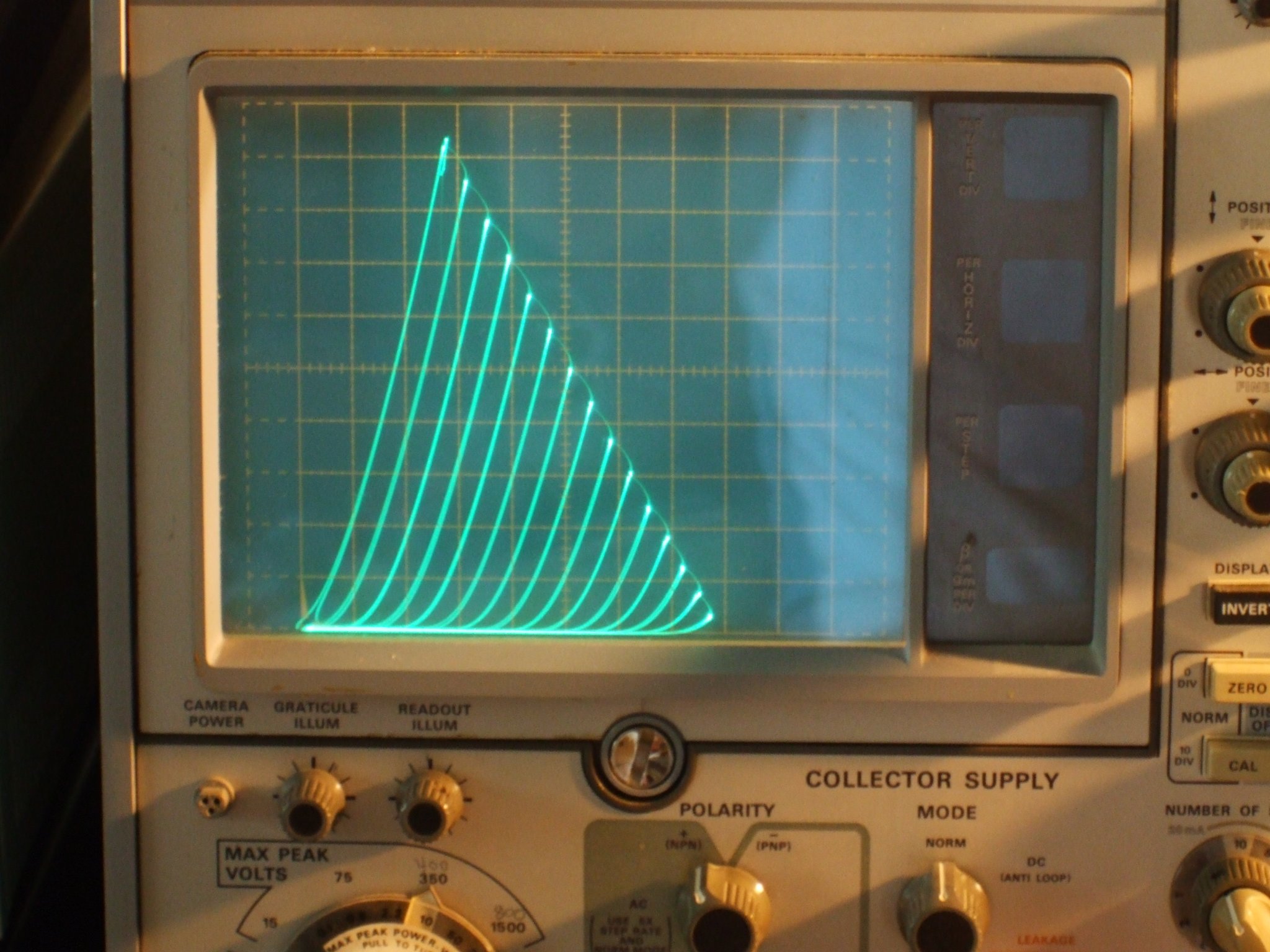

Here is a 21HB5A in Schade mode, off the old $1 list. Resistor chosen for best equal spacing.
And here is a 6HJ5 in UnSet mode:
and here is a $0.50 38HE7 just connected as triode:
