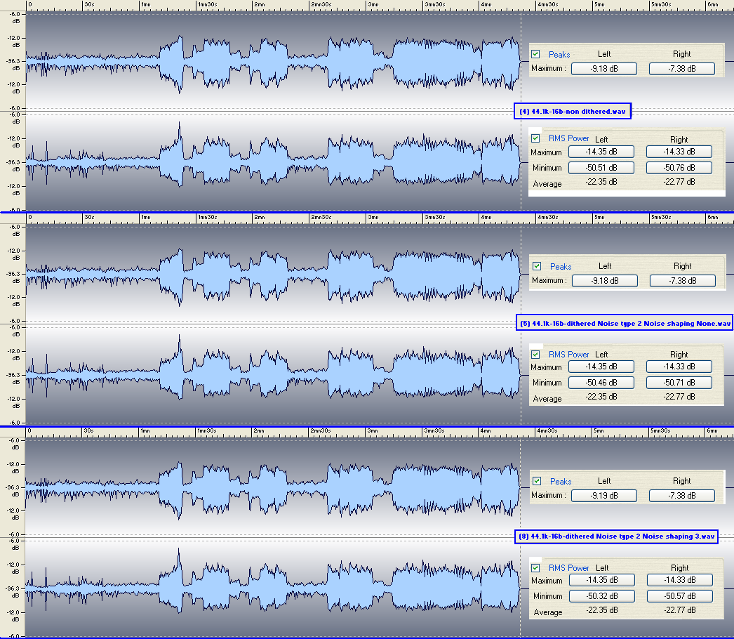

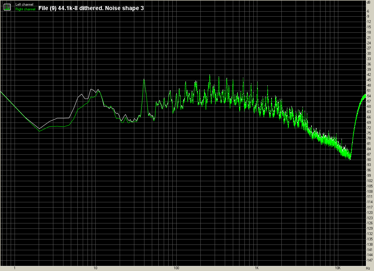

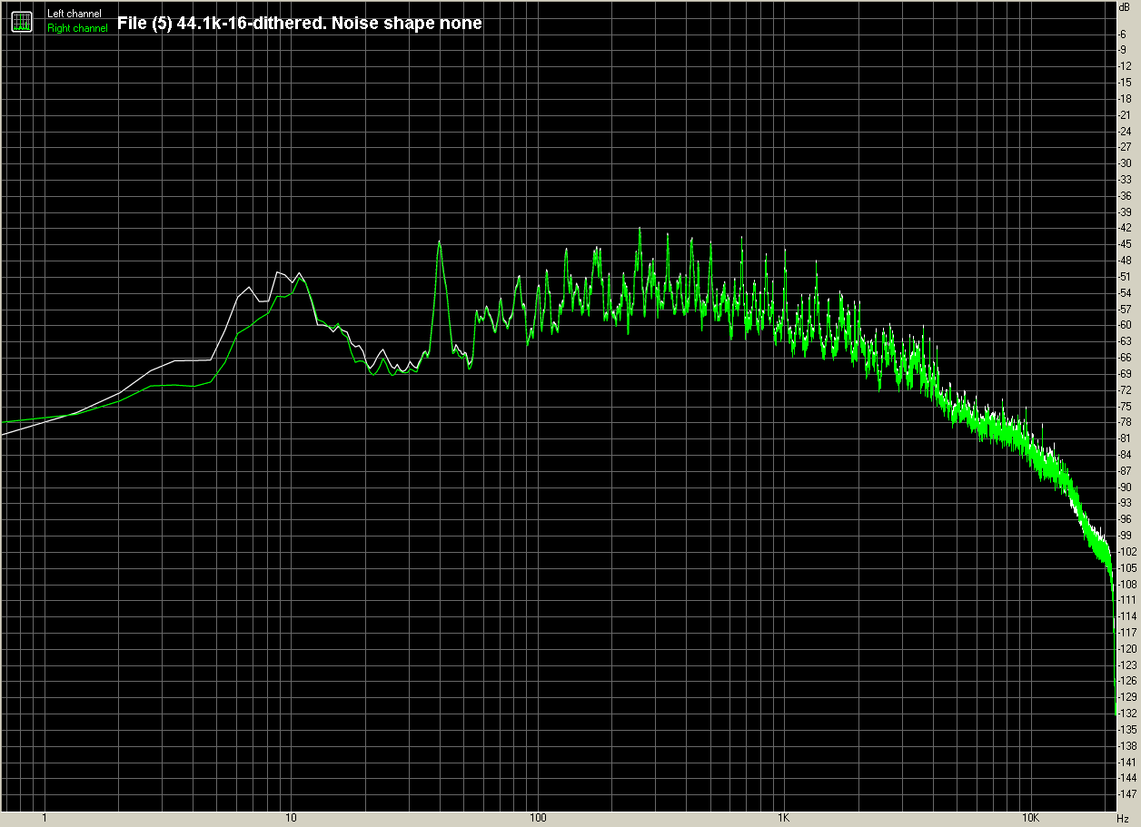

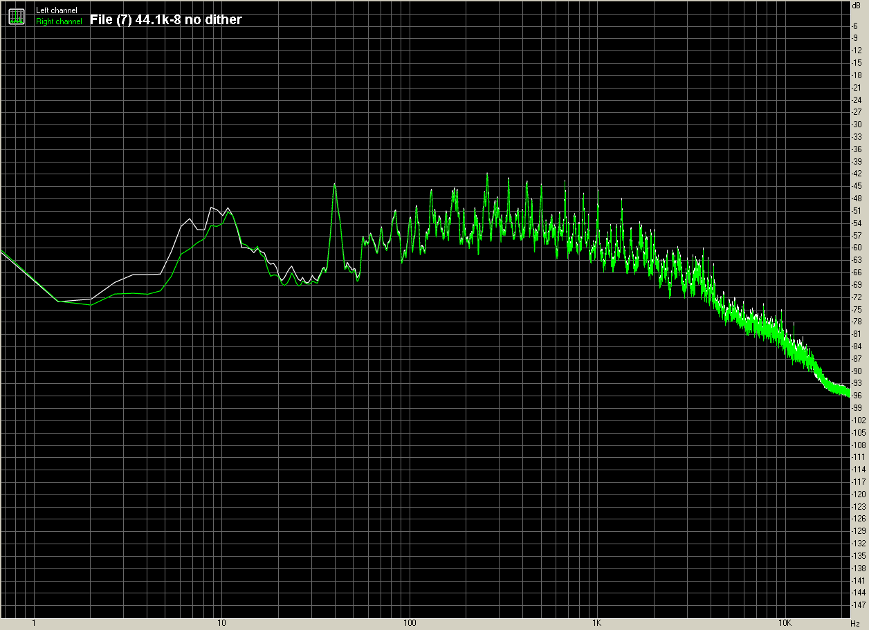

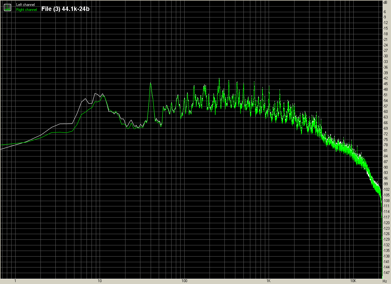

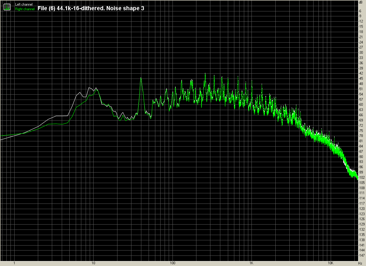

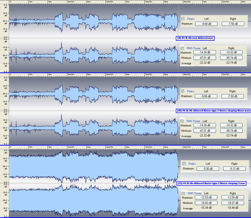

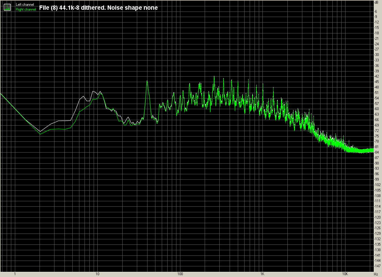

Dan and Mark thank you for your comments.
I hope all of you have better hearing capabilities than mine.
I can’t hear the effects of the sample rate conversion (the ‘echo’ that Dan says he hears). Nor do I hear the added dither and/or noise shaping over the music content on the 16bit files.
But I do hear the effect on the 8 bit files (success
The inherent noise from the vinyl recording is not enough to overcome the digitization distortion at 8 bits.
This is obvious at the low level music on the 8bit undithered file (file 7). Notice particularly the section 8sec-12sec, where the digitization distortion is heard as if the cartridge loses contact with the groove side walls (I was monitoring the section with the bit meter and this distortion occurred with the signal level filling the 7th bit).
The dither of course cures this (file 8).
And the high level of added noise with the noise shape 3 (file 9) makes (to my ears) the perceived noise much less noticeable.
I am about to repeat the same exercise, this time with an HD recording as the source.
Attachments refer to the prevously linked vinyl rip files
George
